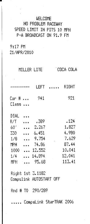

I finally took her to the track...
With 11psi and running the exhaust through the stock rear section she ran this.
60' 1.975
1/4 12.448
MPH 113.76
With boost at 15psi and the exhaust cut out open she ran this.
60' 1.920
1/4 12.123
MPH 118.98 (best MPH)
60' 1.827
1/4 12.041
MPH 113.41 (best ET)
The 12.0 run would have been better but I hit the revlimiter in third I think if I just add a shoft light I can put a good run together and get into the high 11's without any more major wotk or boost increase. Overall I am very happy. The built motor and trans w/ VB has over 28,000 miles, pretty good I think.
Ive attached a sacn of the 12.0 slip and have a few video links too. I'll wash her up this weekend and take a few pictures.
Attached Thumbnails My TT Sedan finally gets to the track!-mgm-12.041-g35s.jpg

None of the videos are coming through but nice numers
It seems like you are pushing low to mid 400's with the MPH

Thanks, remember its a auto...

Did you let the auto shift itself, or did you have it in manual mode?

Manual mode, automode hits the revlimiter in every gear
