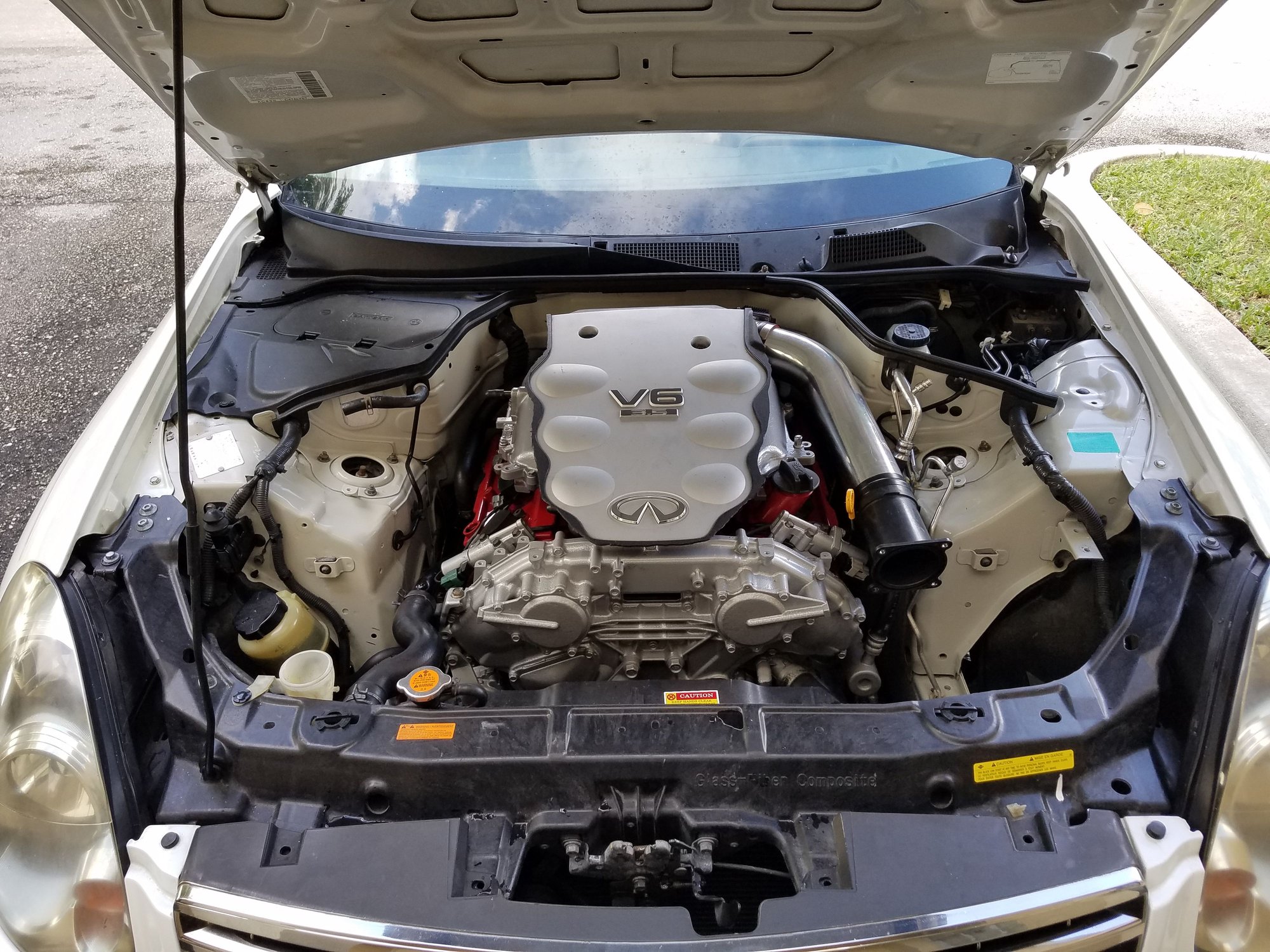

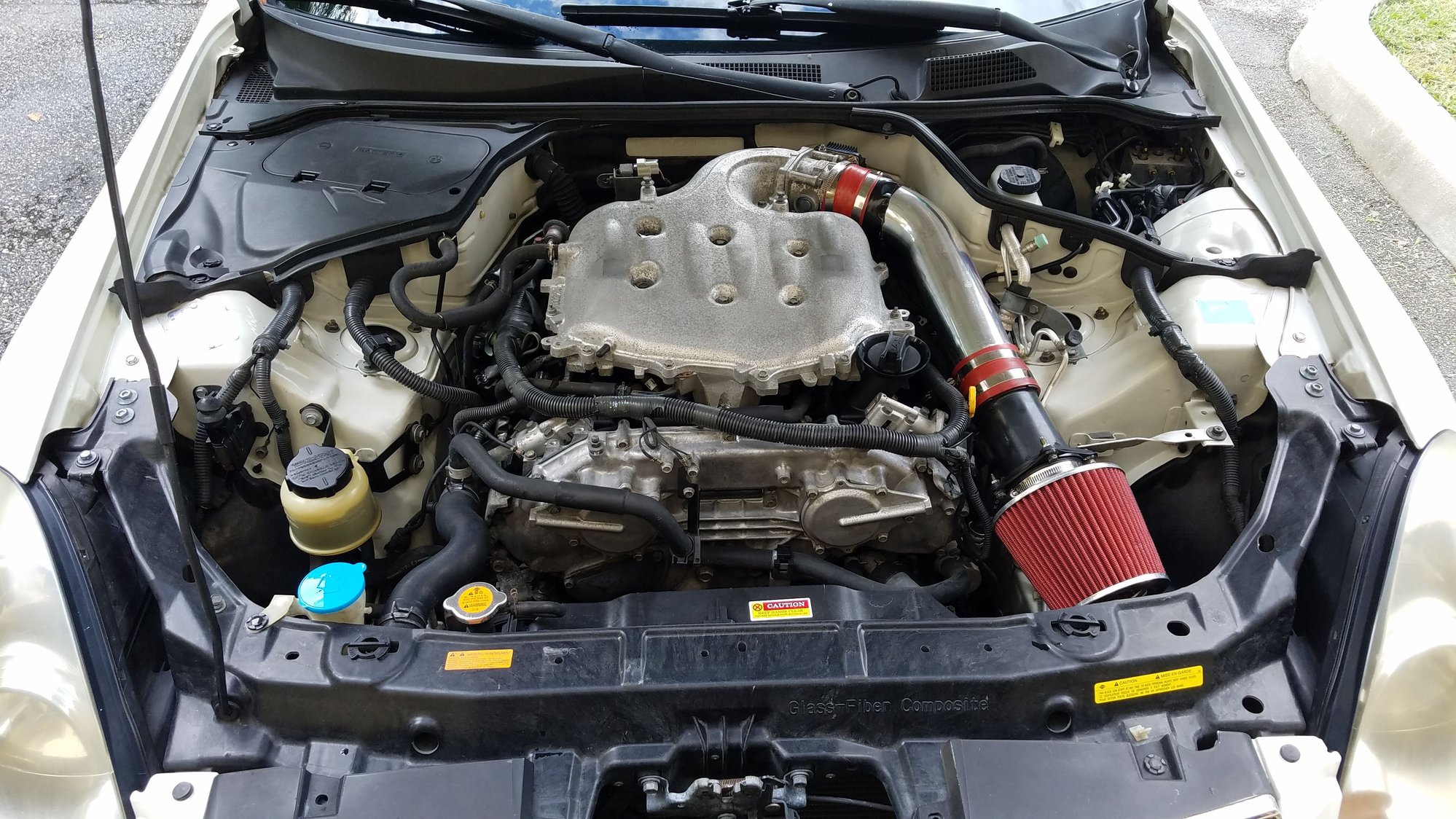

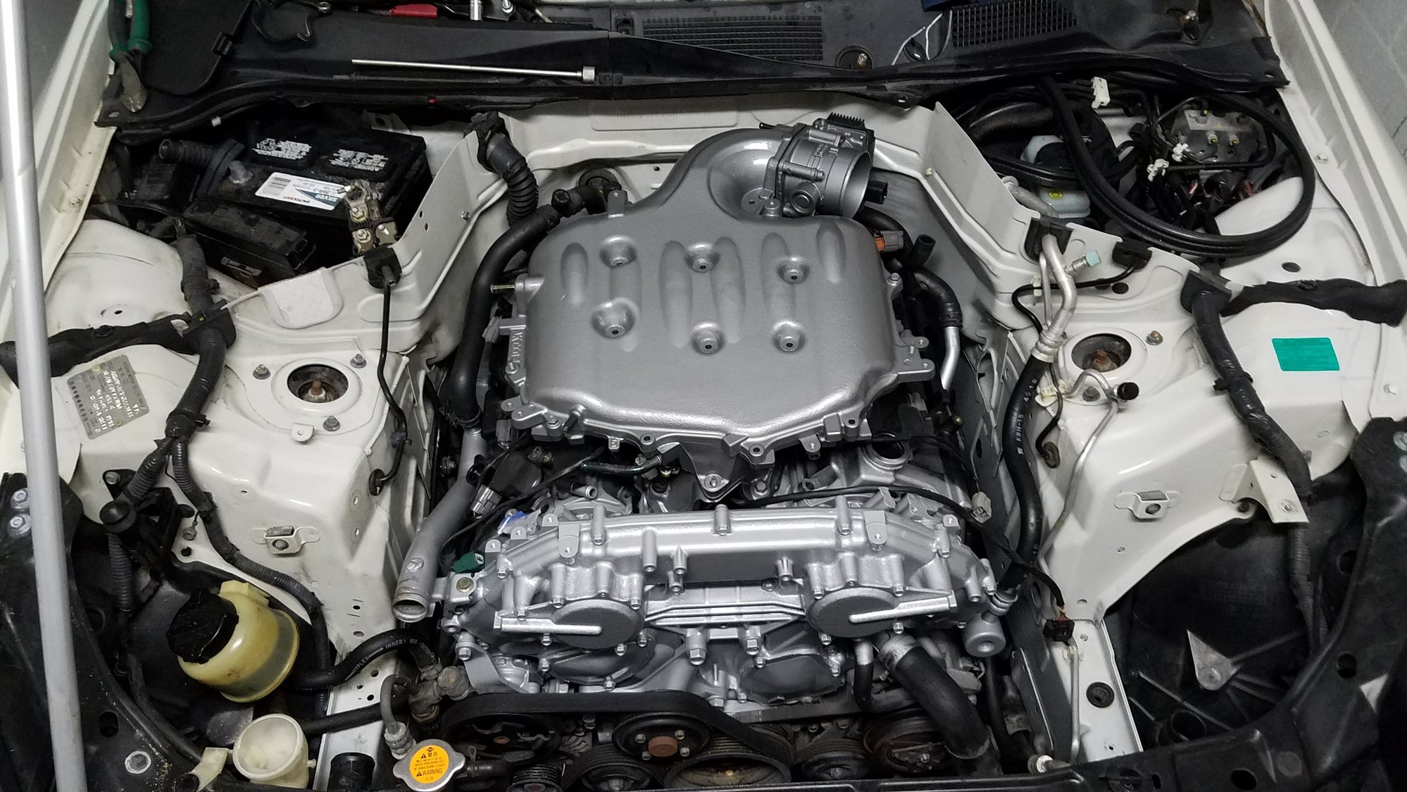

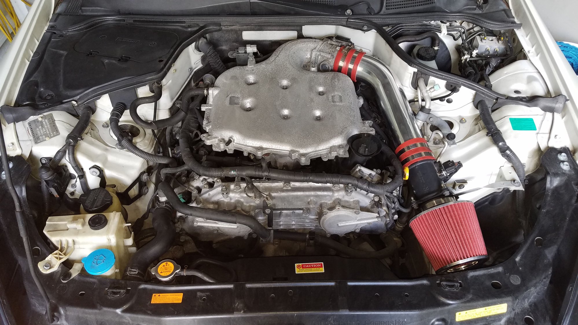

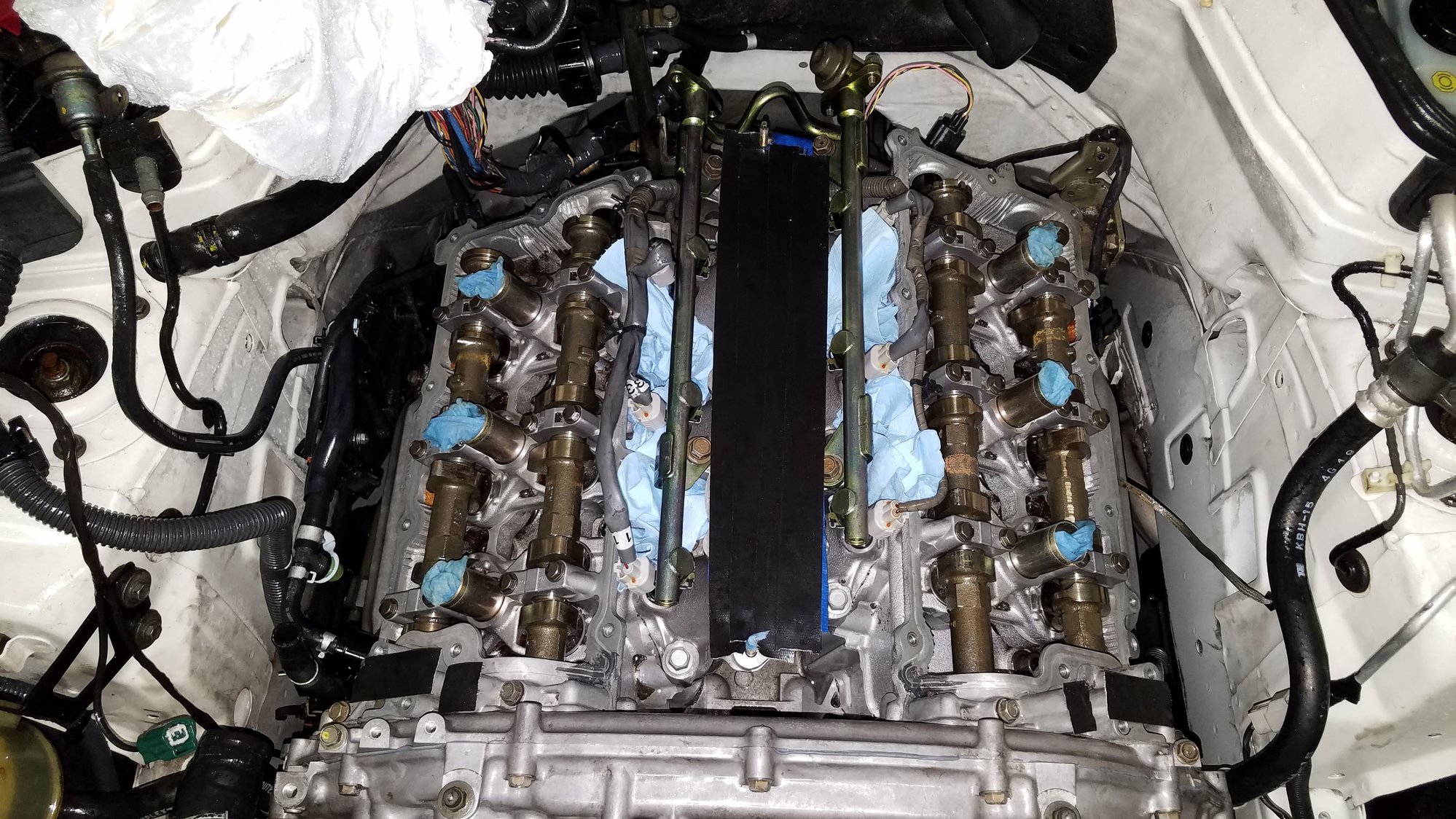

Hi everyone, this thread will be to show a bit of progress on this car.
Pictures will be huge
First engine pic
After Wash
Debadgin
It was here when it started getting real for me, The NO turning back point

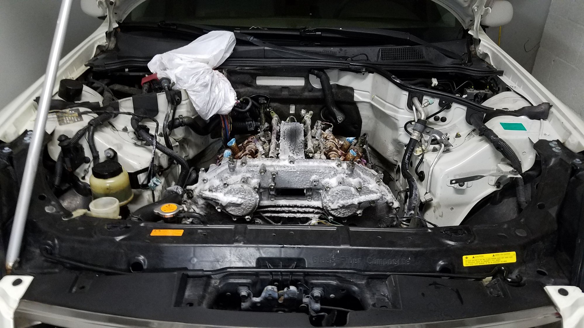

Laying it all down
Degreasing and destaining the engine
Same
After the wash
As you can see, the result is totally worth it

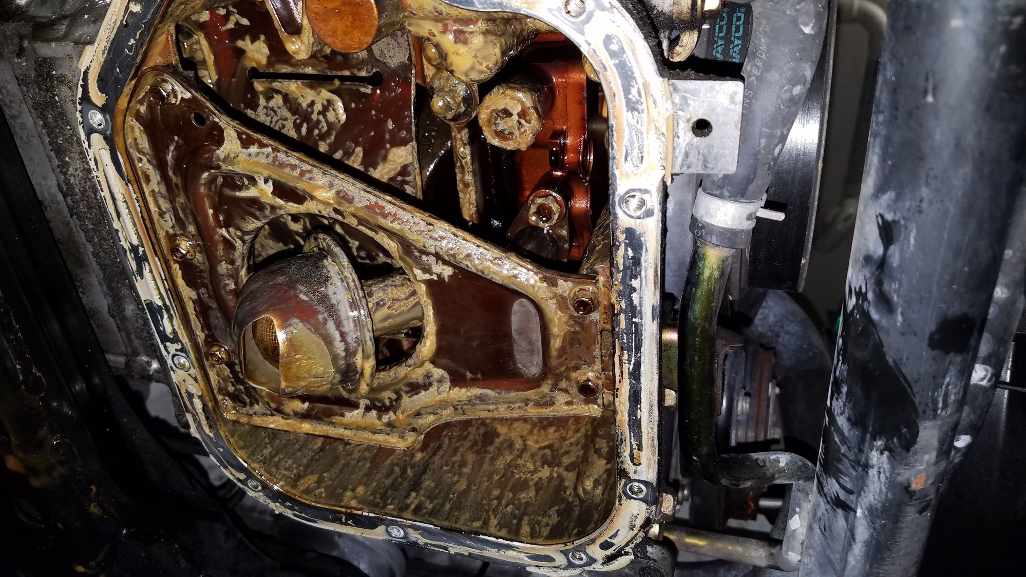

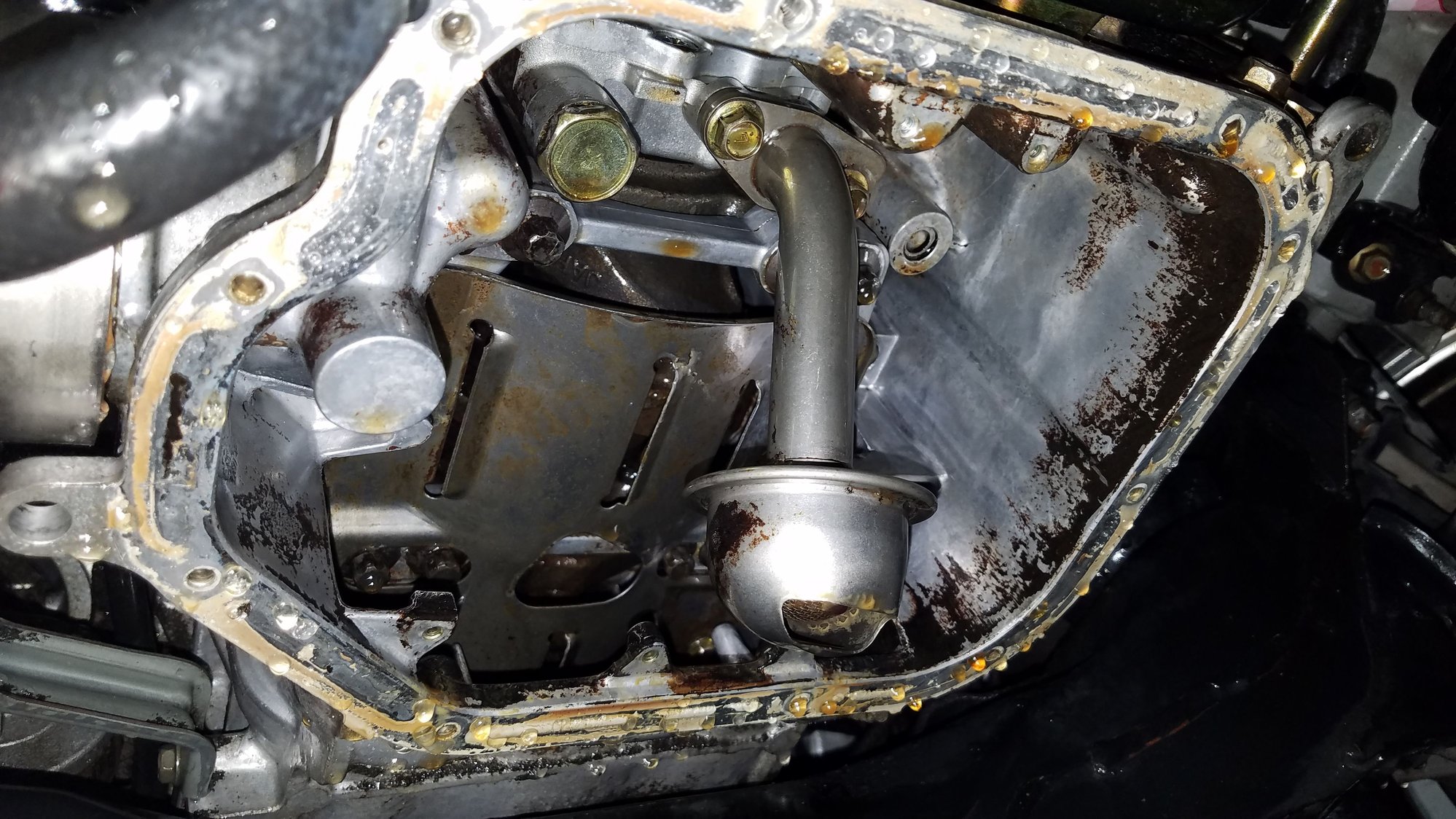

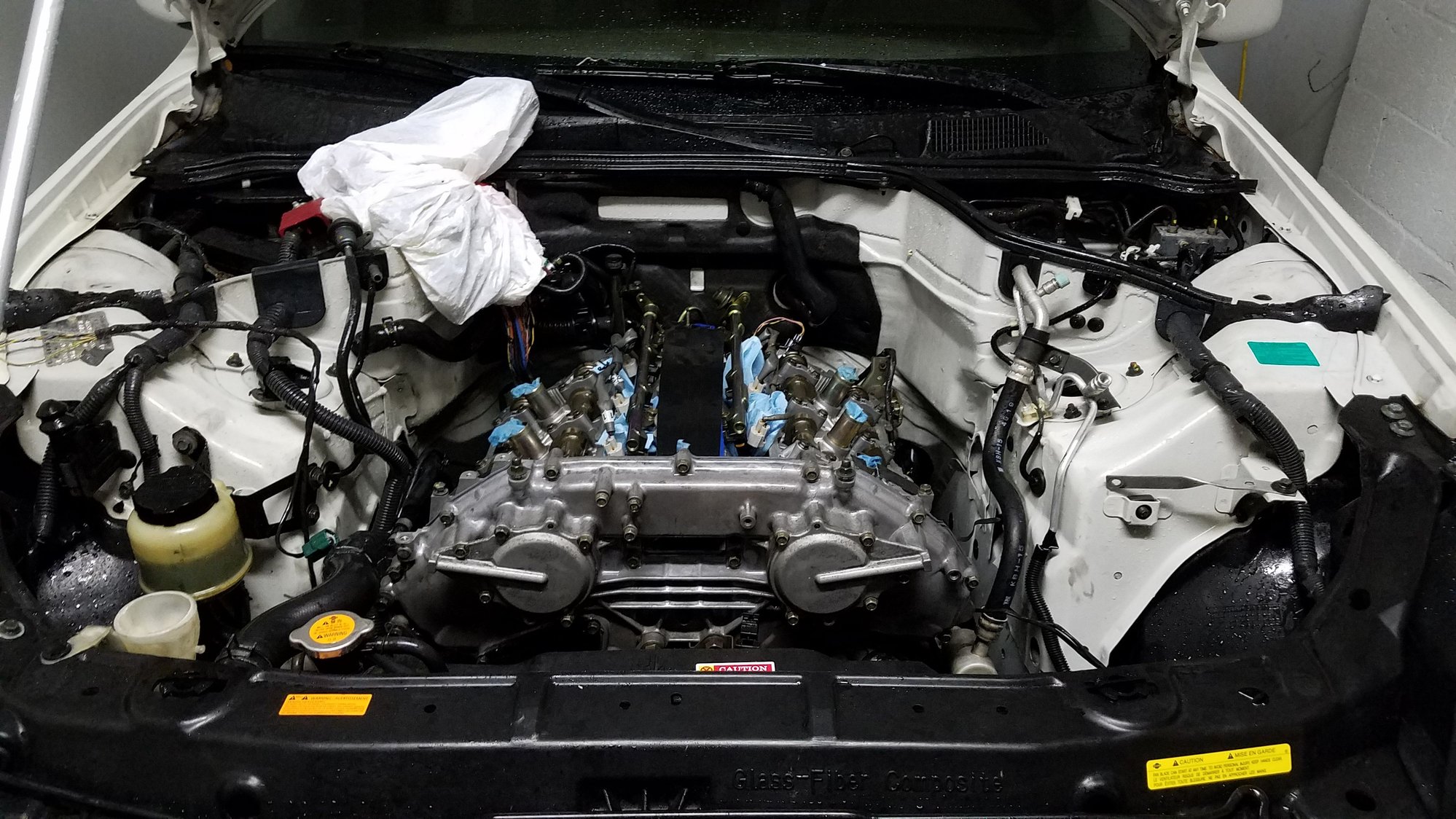

It looked like this because I removed the pan after washign the top
This was after the treatment
Starting to see less colors

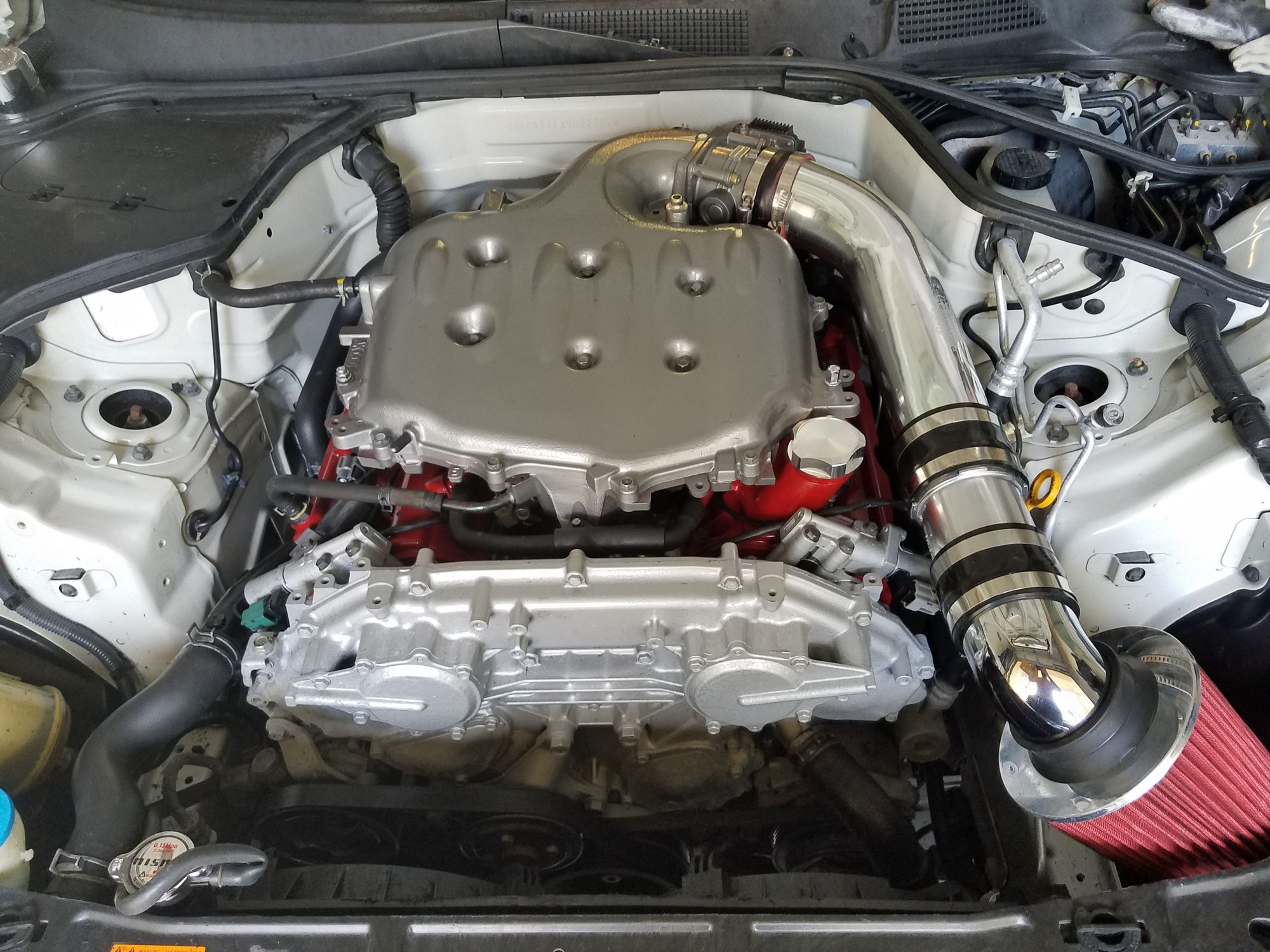

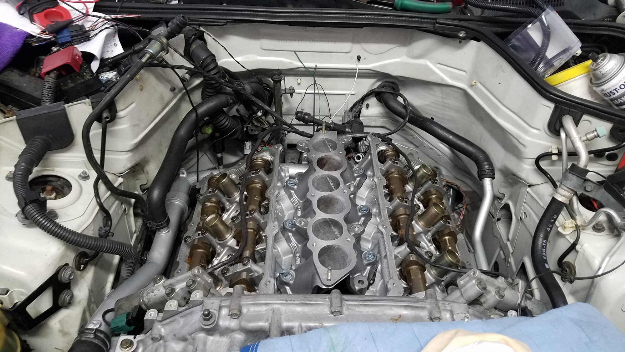

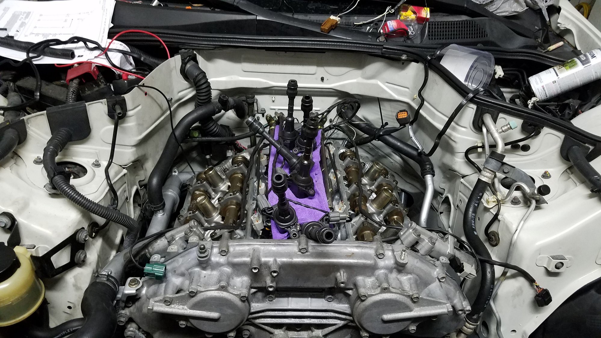

Runners are painted

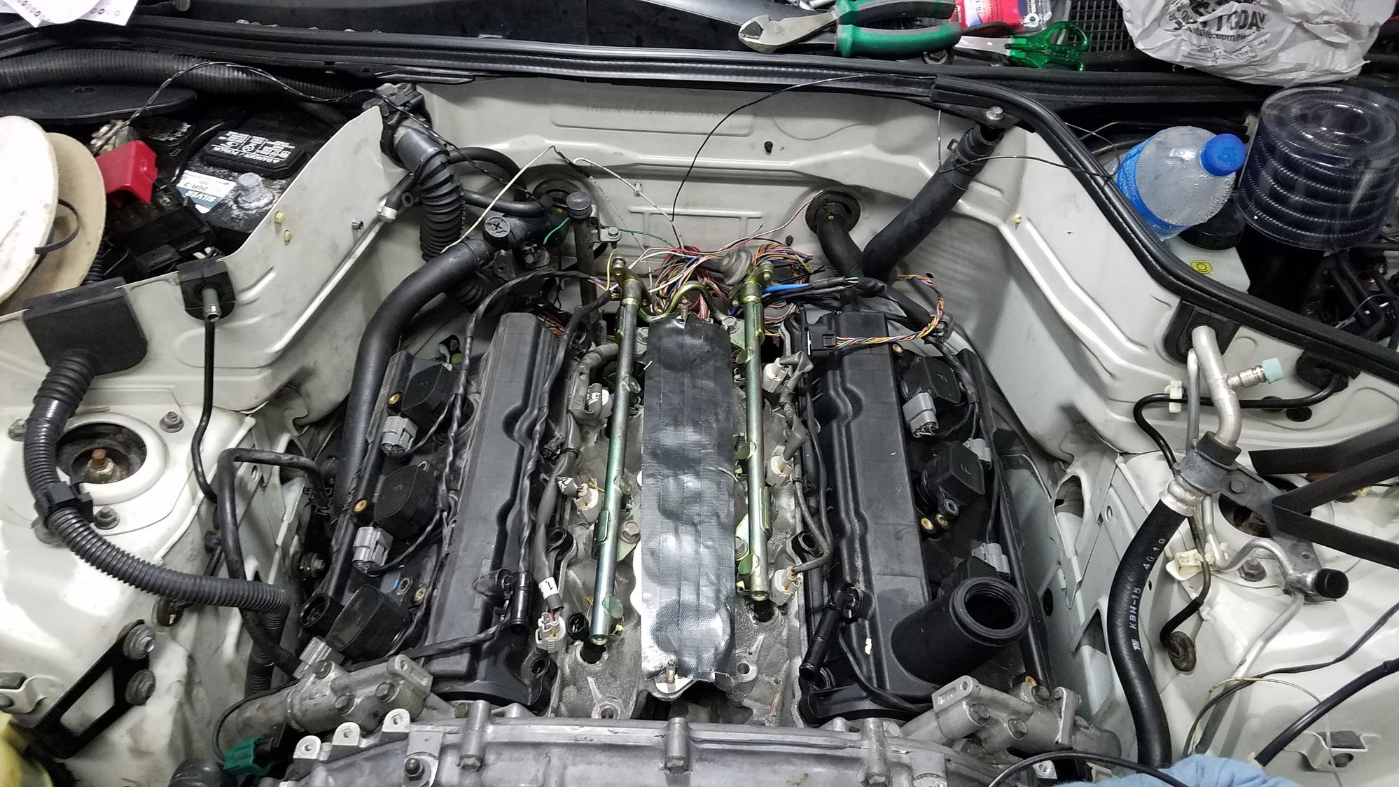

More measuring

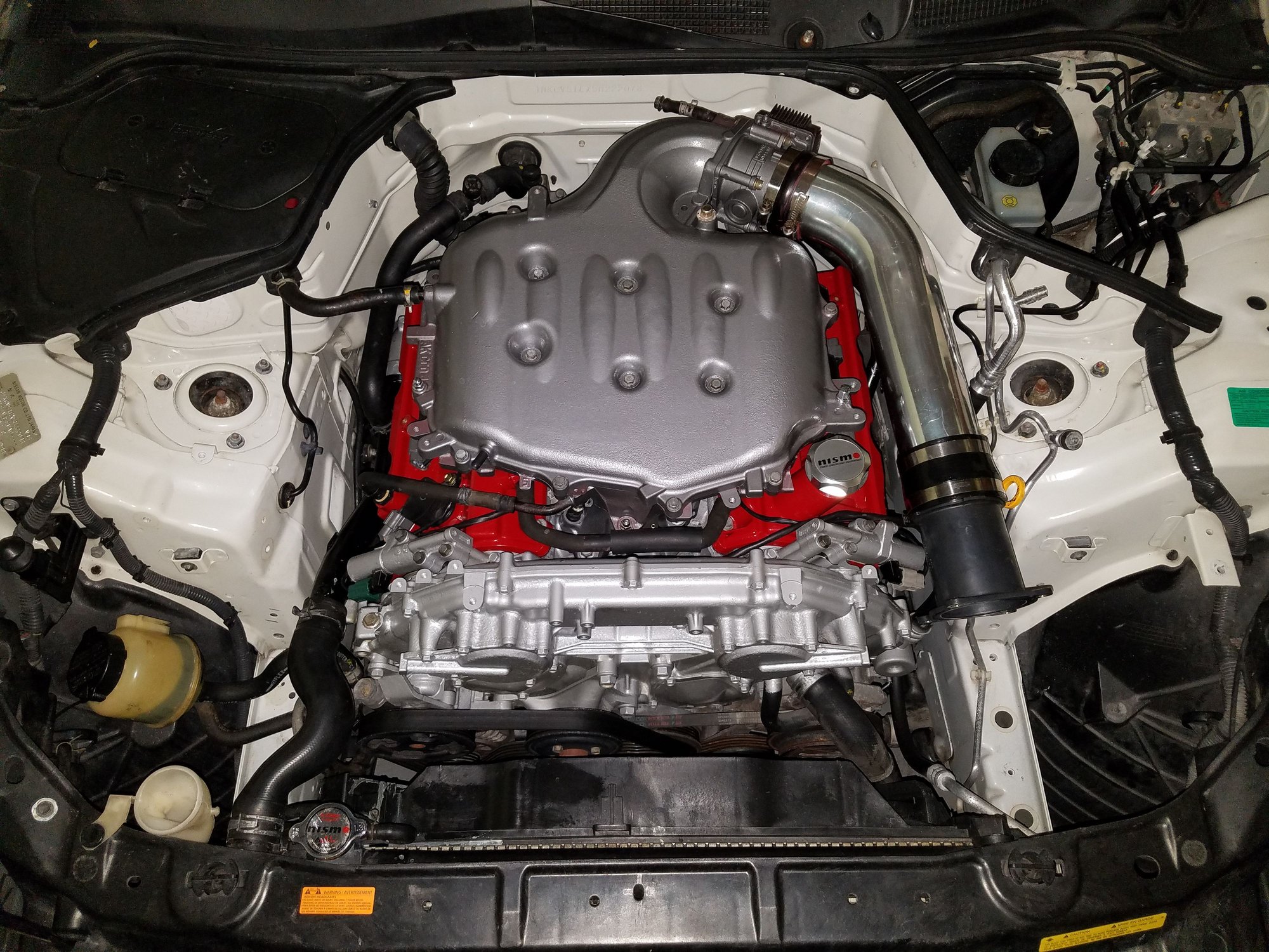

Top manifold is on and front cover was painted!
Prefer the look of this badge
When the vision started to become a reality
Something I did to the cover, unsure about it
After a month in the garage, removed the pinstripe
Running!

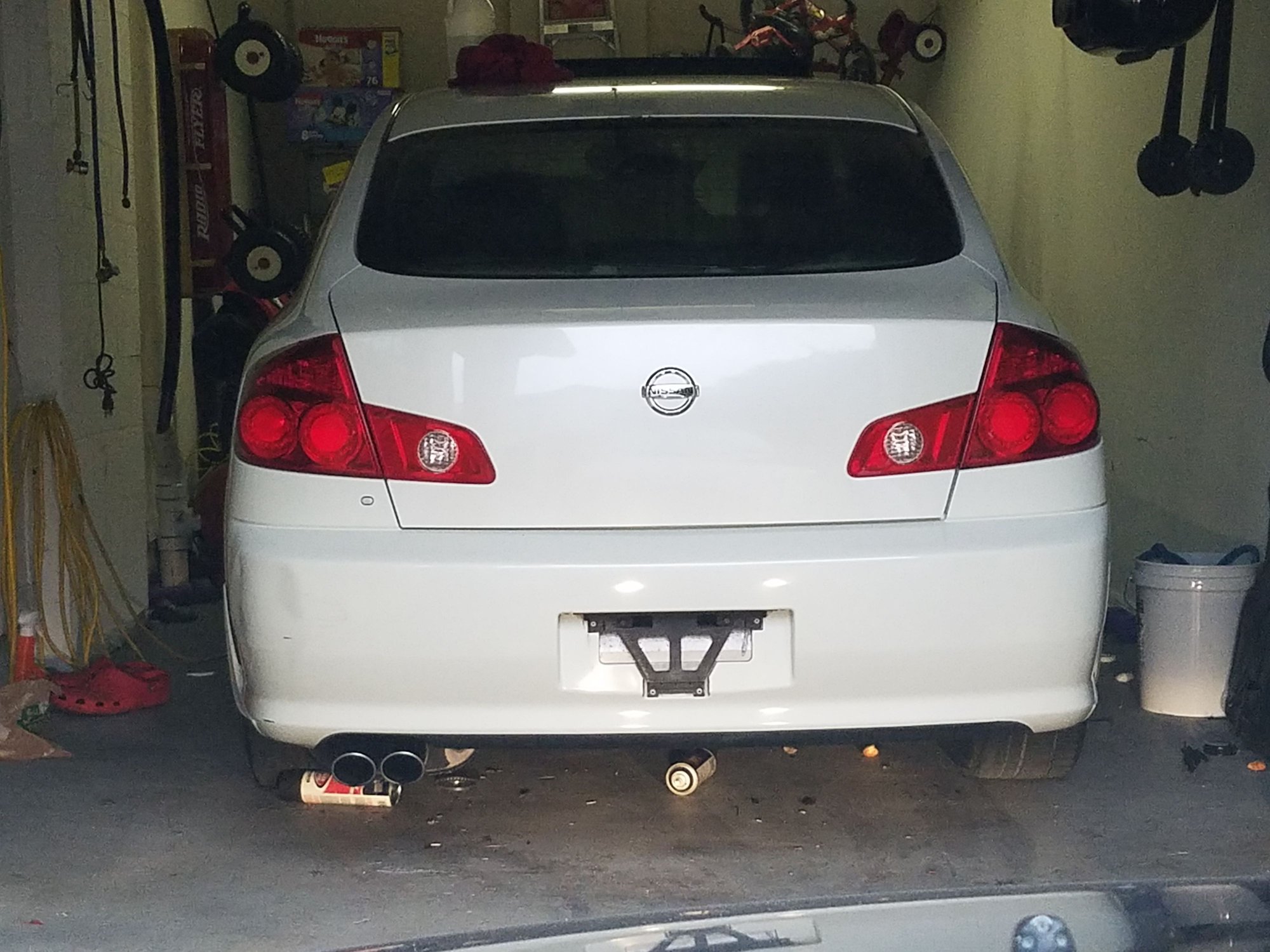

Polishing oem muffler
Current picture
Again, like the roundness of this emblem.

Looks nice, did you replace the battery that was in it? I noticed a significant amount of corrosion on the battery post in one of those pictures so the battery is probably shot.
Old Jan 3, 2018 | 01:16 PM
BULL's Avatar
Joined: Nov 2017
Posts: 96
From: Ft. Lauderdale
I thought so too at first however according to the test they passed so I just ended up cleaning everything and added some Dielectric grease.
Old Jan 3, 2018 | 01:49 PM
cleric670's Avatar
BANNED!!!
Joined: May 2017
Posts: 14,837
Likes: 2,497
From: Washington State
Coupe 6MT Premium RAS
It can pass a tester if the cells are still in good condition but that type of corrosion is caused by one thing only, leaking gas. If it's a vented battery then I would just clean everything with an acid neutralizer since they do vent atmospherically. If it's a sealed battery I personally would just replace it since it probably has broken the seal around that battery post but you could just acid neutralizer the area, apply anti-oxidation grease and see if it ever comes back.
The G has air ducting directly into the cabin via the cabin air filter and I wouldn't want any corrosives ingested into the AC system, or damaging the electronics inside the sealed battery compartment.
Old Jan 3, 2018 | 02:14 PM
BULL's Avatar
Joined: Nov 2017
Posts: 96
I know exactly what you're talking about with that fresh air Inlet. That's how I was able to find the source of the stink once I would switch to Fresh. I found stagnant water on the battery tray. I made a couple holes on it and cleaned it up so this doesn't happen again. I will keep a good eye on the battery, it will eventually be changed with a AGM.

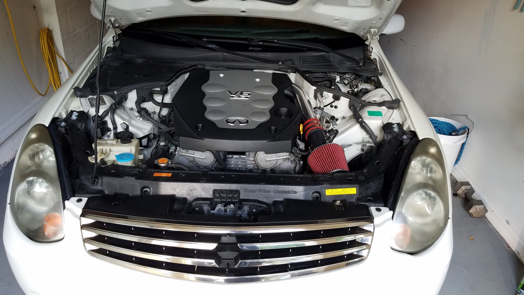

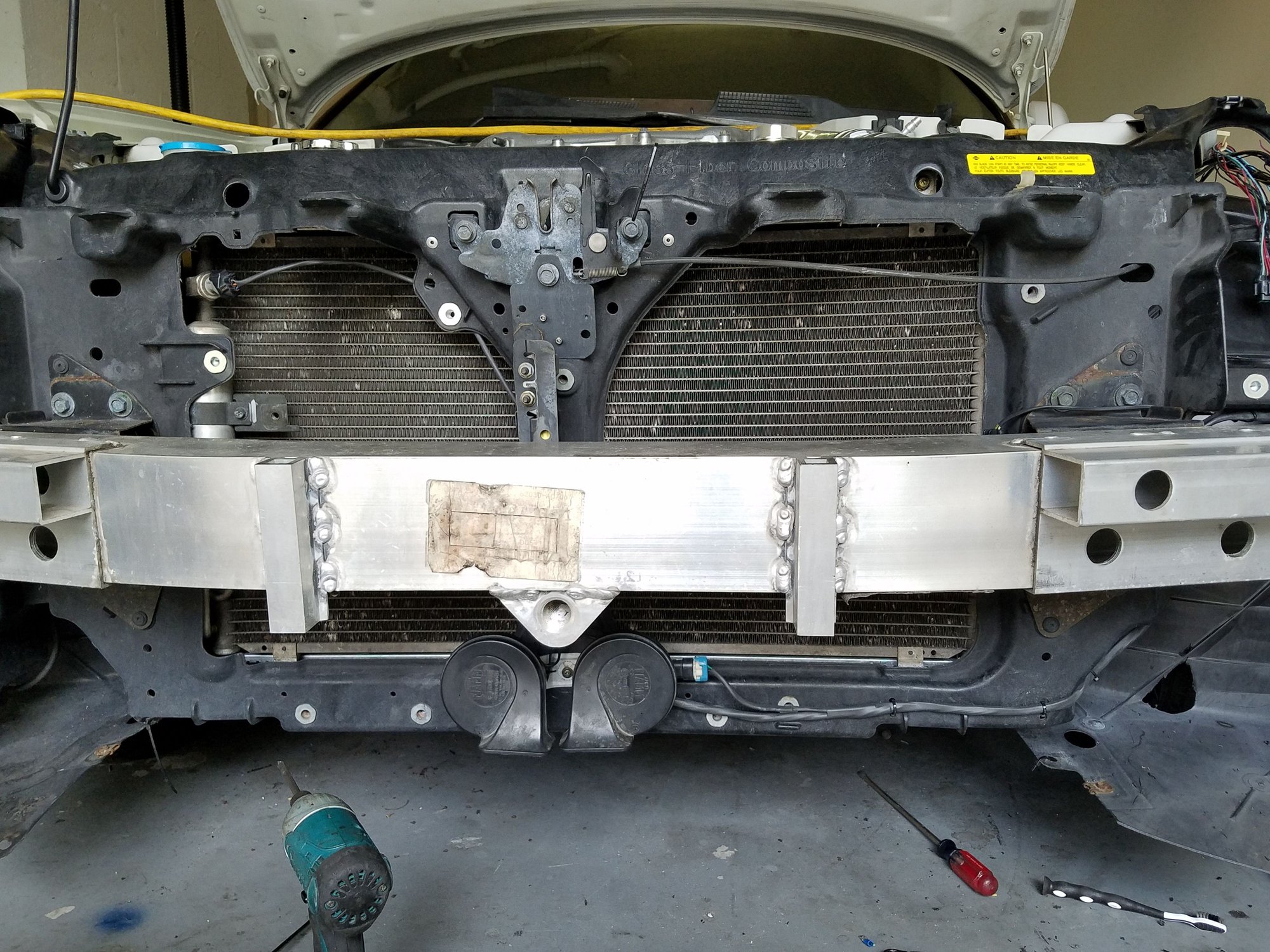

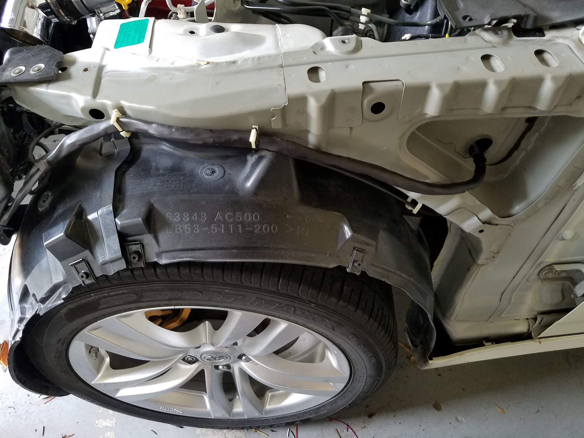

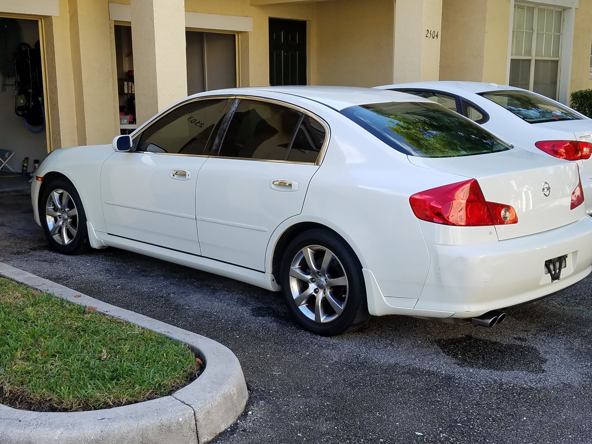

I've been driving the car for a couple of weeks now and my only complaint is gas mileage but in the infiniti world that world is almost non-existant.

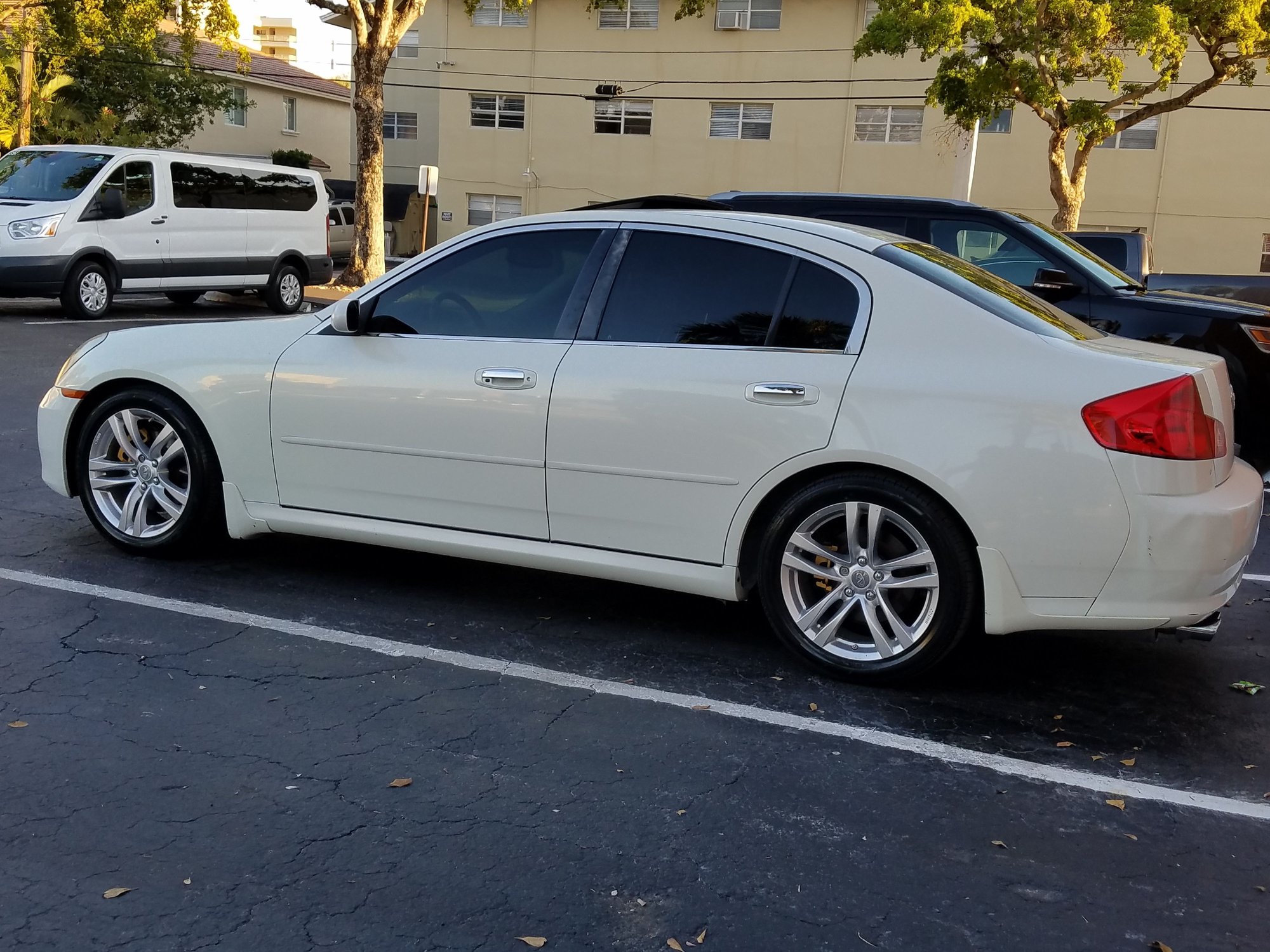

Bought some 2010 g37 coupe wheels and fished the wire tuck.
Passenger side
Front, also upgraded horns
Drivers Side

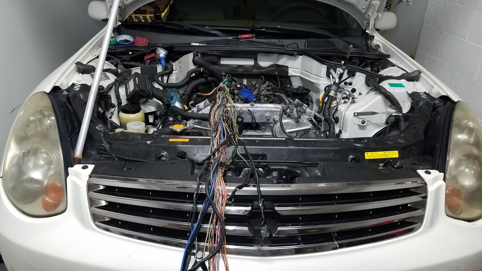

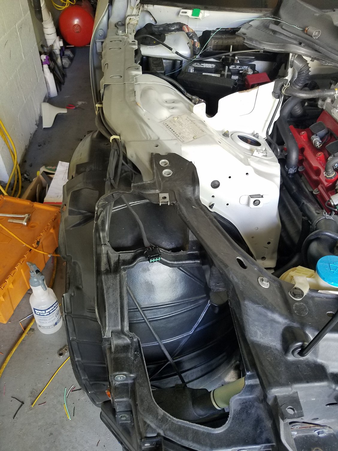

Engine bay shot after headlight harness was relocated
Current stance
The Main Idea.

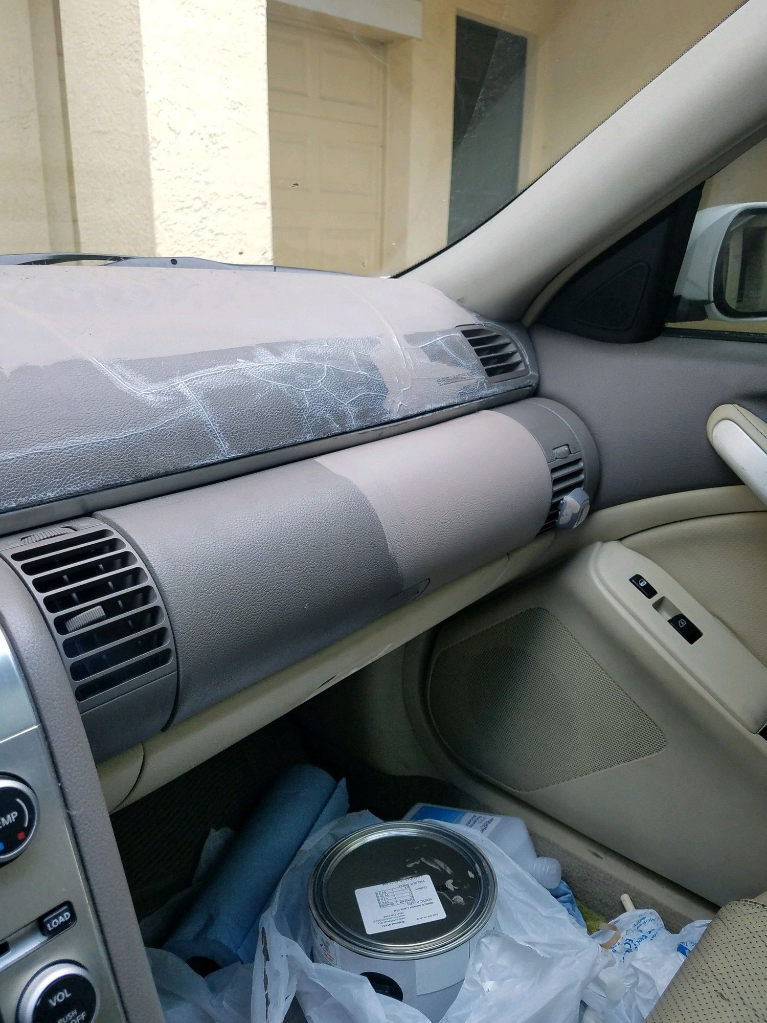

On another note I found the skins for the passenger side seat. Decided to work on the melting dash, this by far has been the cheapest of fixes. I'll upload some pics later. Thanks for checking in.
Old Apr 5, 2019 | 10:30 AM
BULL's Avatar
Joined: Nov 2017
Posts: 96

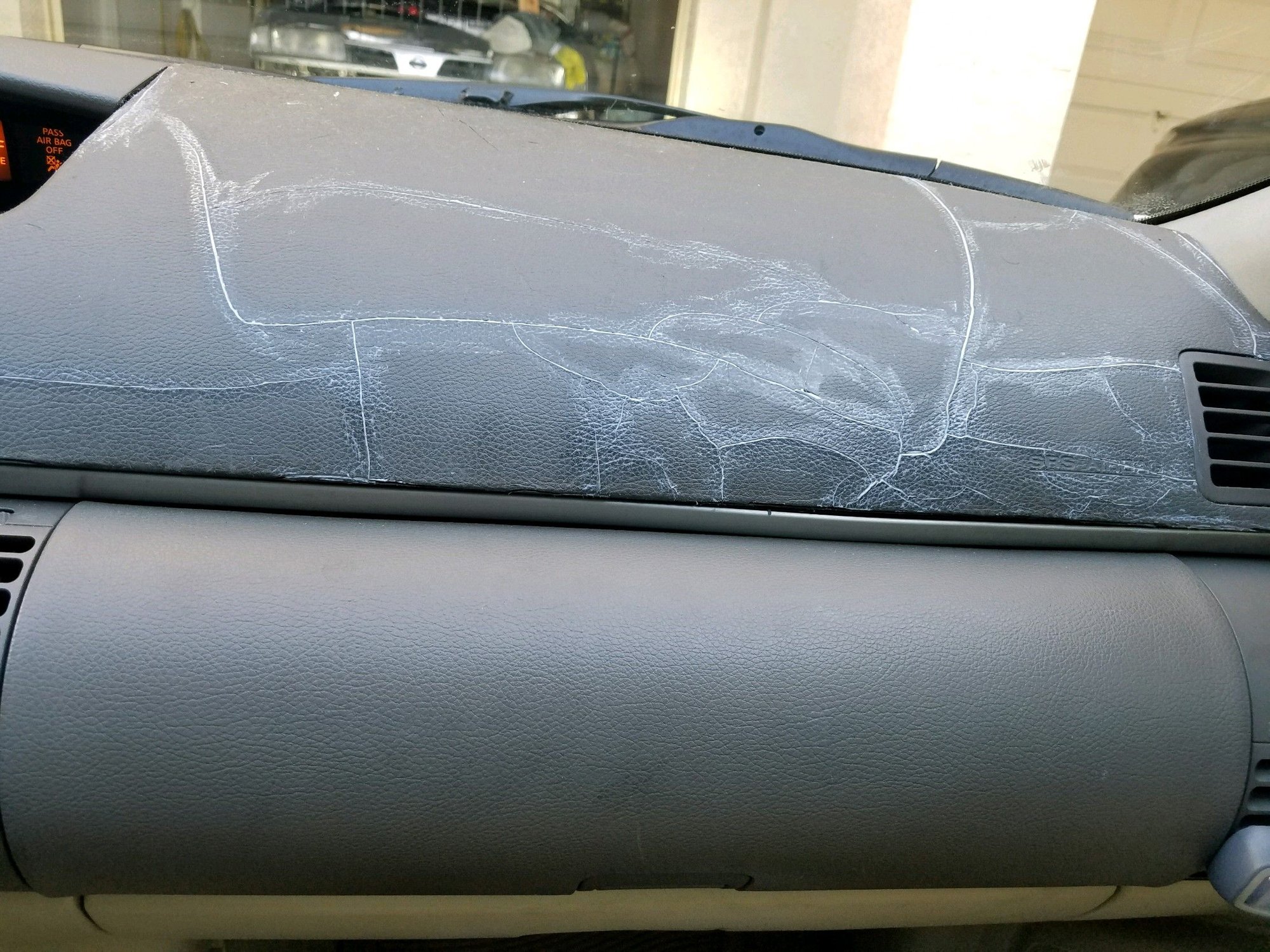

Sooo, I've discovered the power of liquid nails and it's many uses. After seeing some fixes and I realized fillers for the cracks had to be flexible. This meant a silicone/rtv adhesive would best, bondo and solid fillers would crack again.
Put the tube in a caulk gun and fill away. For excess use a dentist pick to scoop the excess and remove the extra from the dash pattern.
You might get it on the first try and on some you might have to re do them.
As for the paint, this part I half assed. Use interior paint for a better finish.
I used HOUSE PAINT WITH A ROLLER BRUSH, YES I DID. The results were far better than expected, after doing this I realized I could have used black and yeah...
So far it's been 3 months and no signs of fatigue. I'm happy with the results 80% happy with color.
