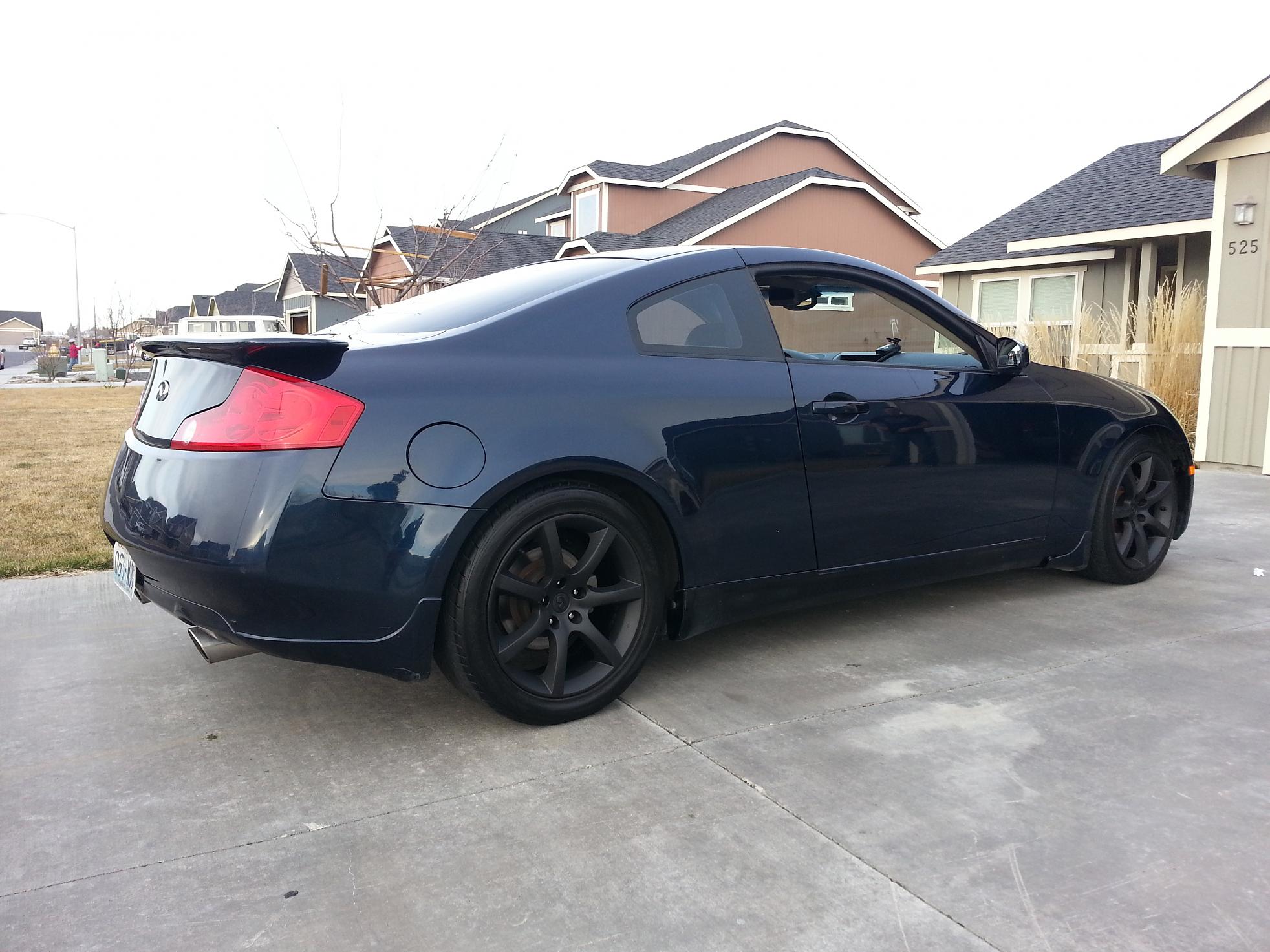

After some time in deciding if this was right choice im excited to say yes ... purchased completely stock had the wheels dipped black for meaner look added ztube and K&N filter
Swapped stock stereo with DD pioneer and ripped out bose amp and replaced with RockFord T400.4 amp ...looking to soon ST in process of doing my HW.
