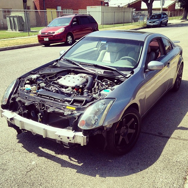

I've been off of here for a while now. A lot has changed over a few months. First off my engine developed a tick which i later pinpointed to be a faulty/worn out lifter that was also causing loads of raw oil to escape out the tail pipes. I ran the car for more than a year with the tick and it gradually got louder until it TICKED me off. I managed to snag up a used engine with tranny for cheap and decided to take on the swap once school ended. Alas summer came around the corner and things got cooking. I resealed the new second hand engine and replaced all major gaskets, new thermostat, waterpump and starter along with a new clutch. After a week of work my car is back on the road and feels better than ever!
FIRST a little bit of fun before the engine was pulled with the stock bald rubbers in the rear
[IMG][/IMG]

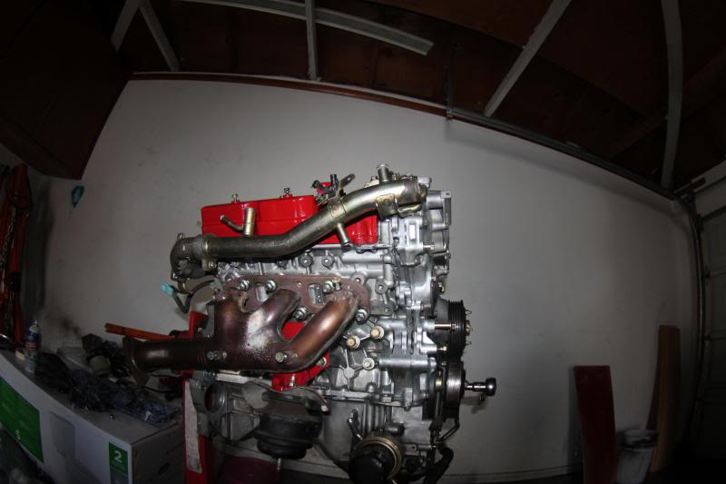

The new engine was dirty and covered in normal road debris/ dirt. After a couple of hours, a tooth brush and some parts cleaner it was looking like so
[IMG][/IMG]

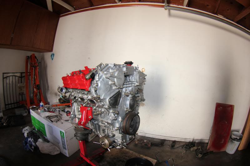

After some paint

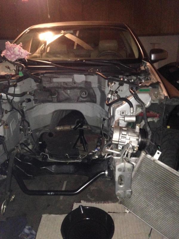

Then the teardown began.
So much more room for activities
No lift, no help other than my hands and legs and 2 hours later and she's out.
