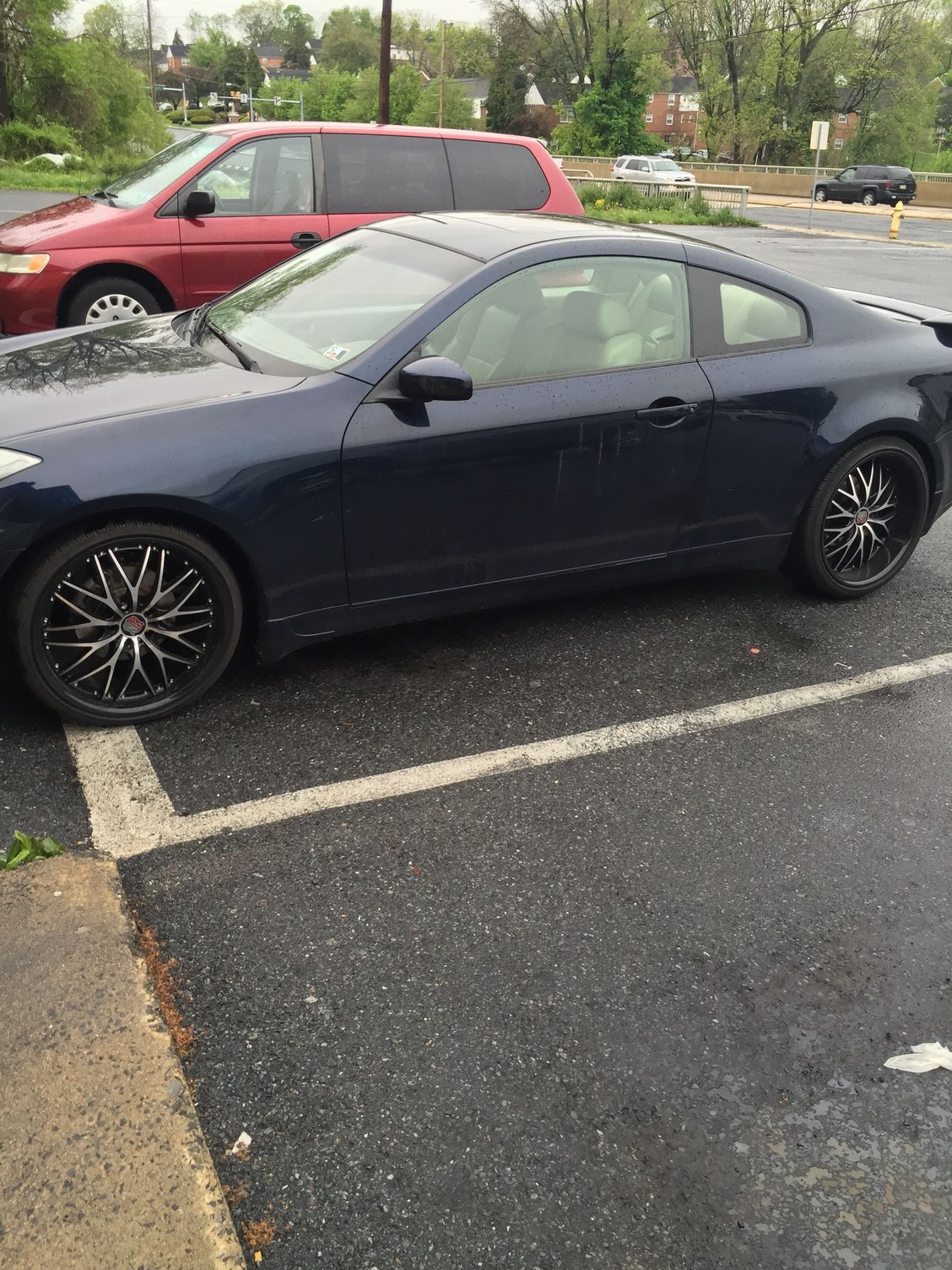

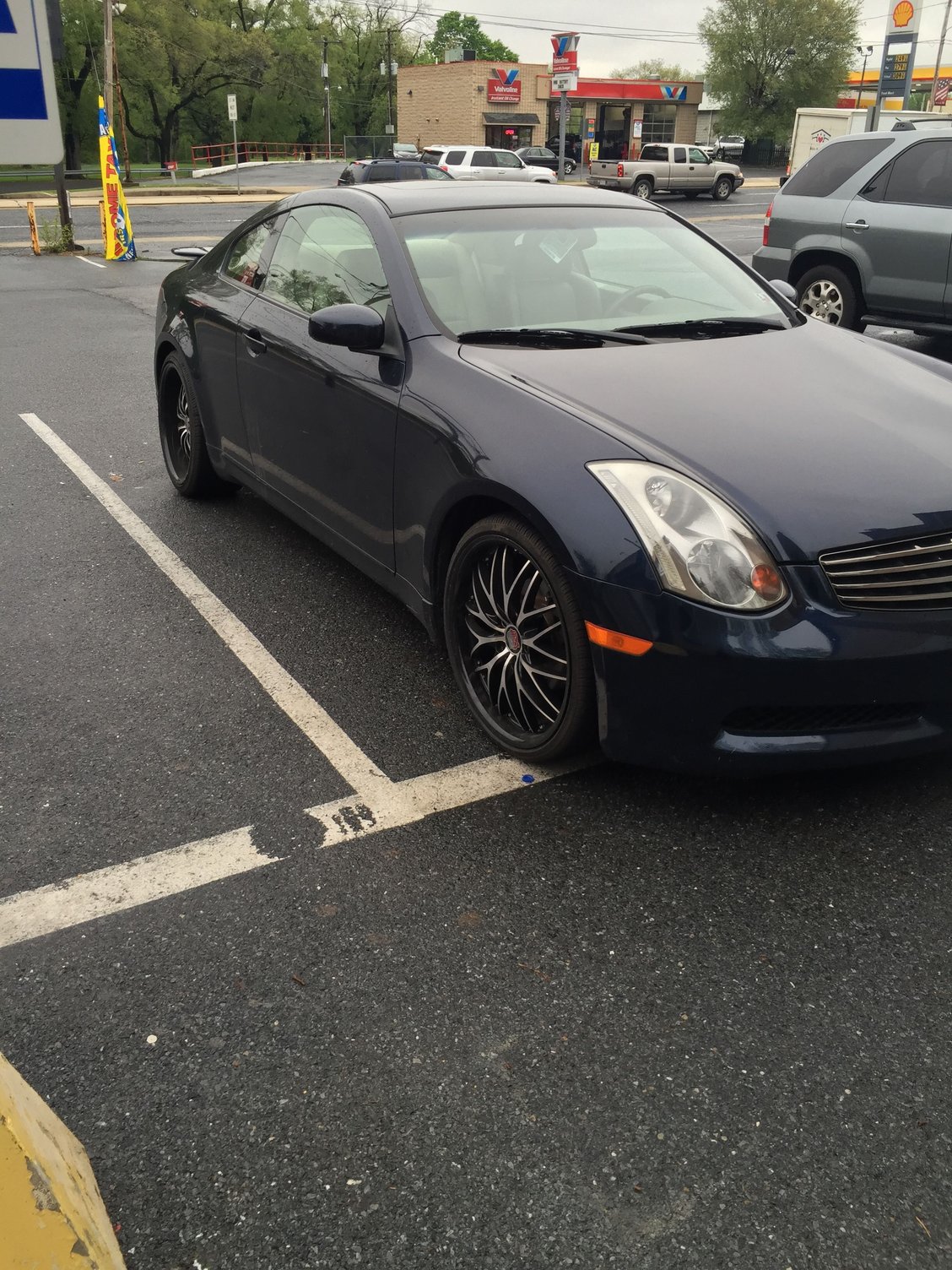

Hey guy! I am excited to be part of this communities. I am new to G35 and i do not know much about car which is why I decide to join a communities that know about car. Unfortunately I cannot post the picture right now because I dont have my car with me but I will definitely upload a pic when I get the chance.
I have some questions hopefully, you guy can help me out.
I bought my baby from a mechanic, its an R-title. The problem im having right now is, the driver rear wheels is scrapping with the fender. I also change my wheel to a 20' which very big and cause this issues. When I bought the car the mechanic also throw in the 20' wheele that he was planning to put on for a good price so as I was alright!.
Now the wheel scarping only on one side, I put some spring spacer on it to help raise the car up, it help but it still scrape when I hit bumps or go up ramp or turn right to hard or fast. Also I have alignment issues so after som
e research it seem i can use camber kit to help with that.
Please help, I love the car but I am a college student who have a kid on the way and clueless about how to fix this issue.

Welcome to the G35 Driver forums! No, no and no you don't need a camber kit! The best way to fix tire rubbing issues is to have you rear fenders rolled! That's where they flatten the inside lip allowing you an extra inch or so. Not sure where you live, we have a few guys that do a great job here in SoCal. Check with body shops in your area, sounds like you need it done soon to save your tires! Again, welcome and enjoy the ride...Gary
