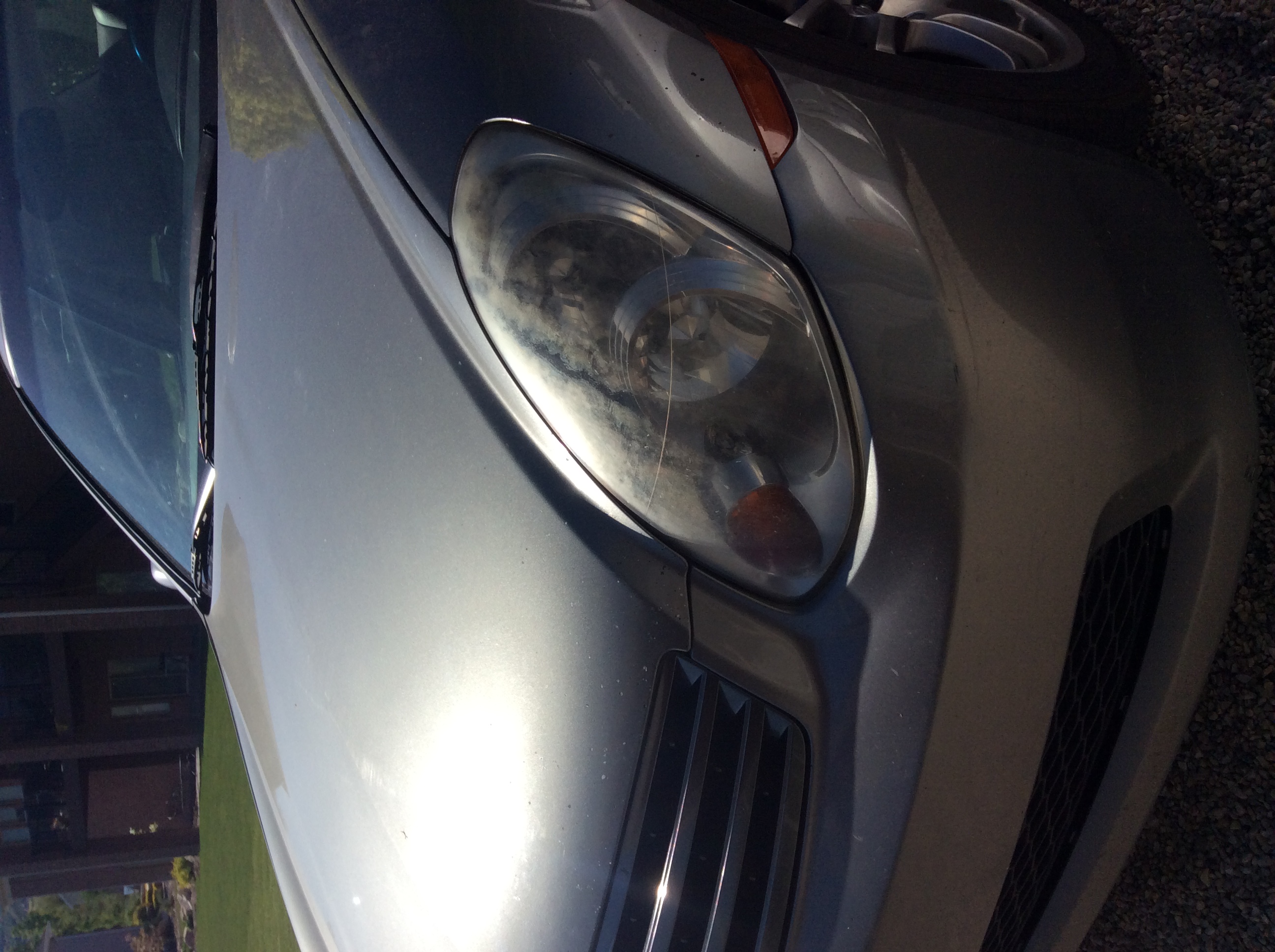

- Discoloration on headlights. Needs restoration. I'm planning on doing that first.
3-M Head light restoration kit, works wonders

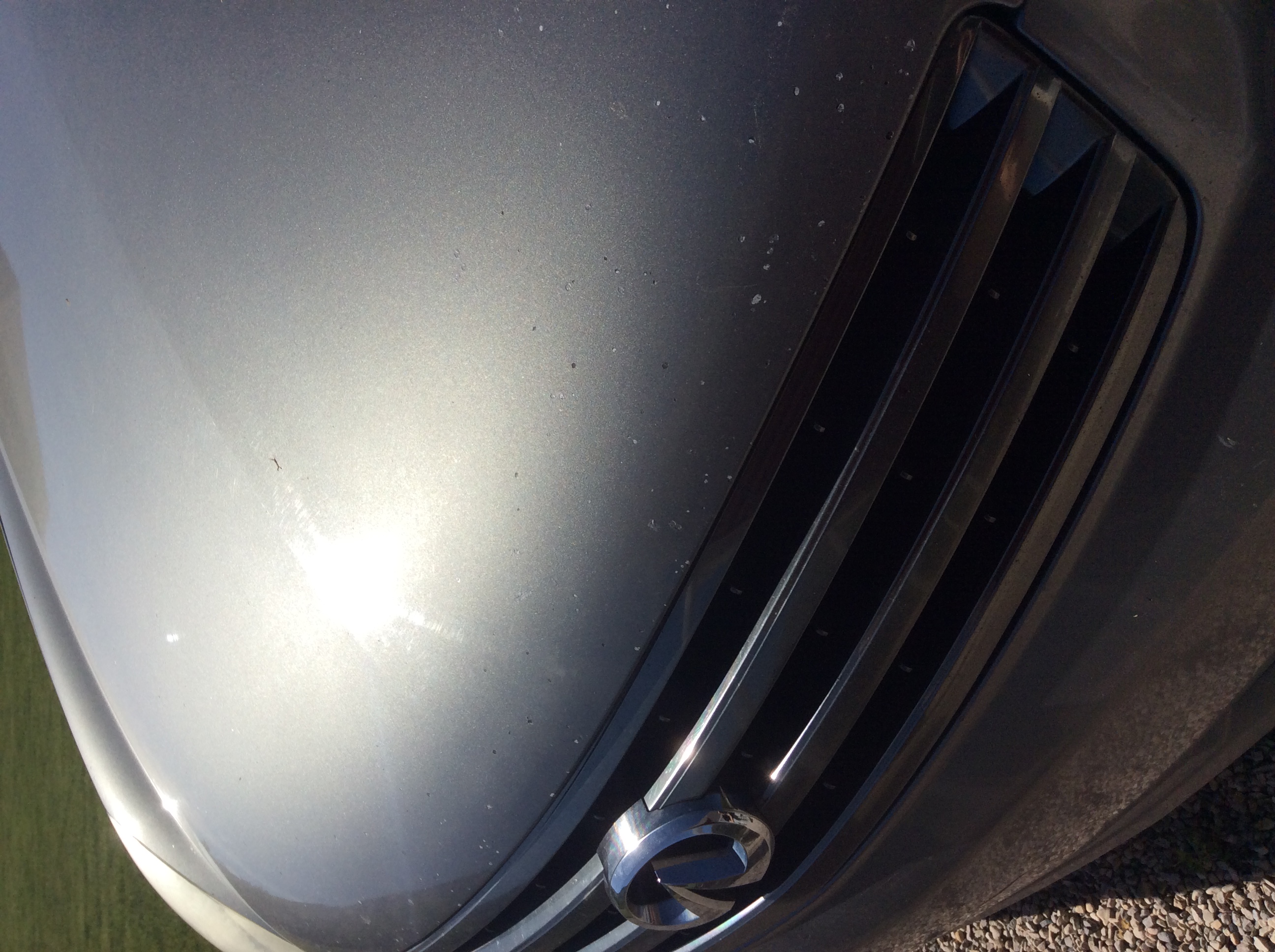

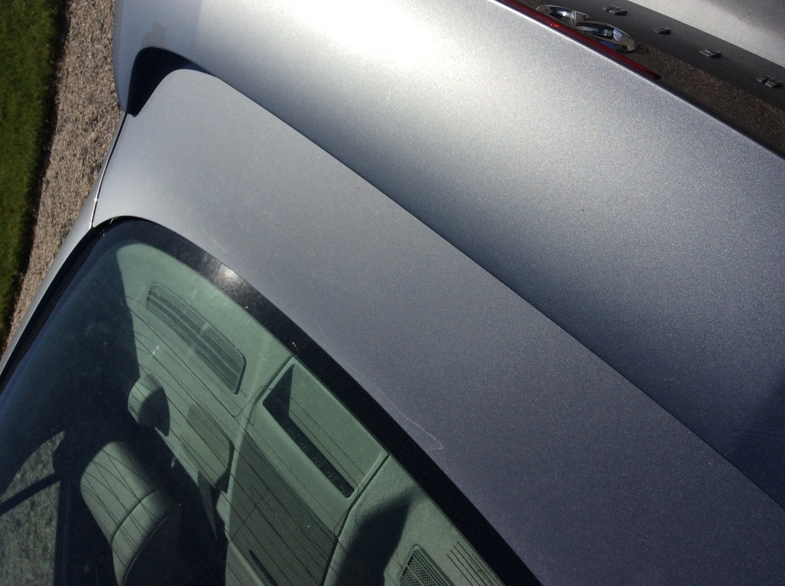

- Lots of paint chips on the front with multiple scratches all over the car.
Touch up paint, you know the drill

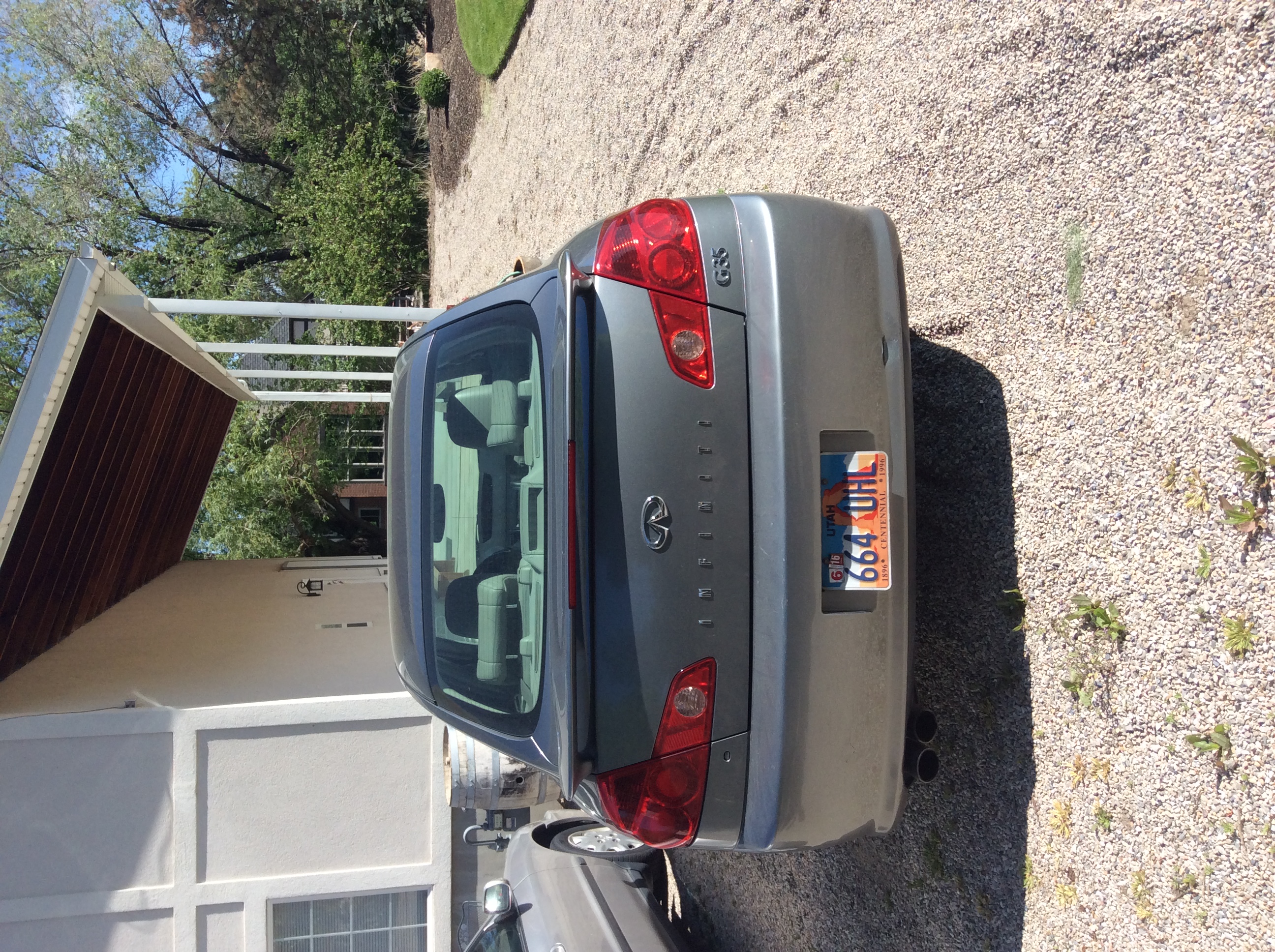

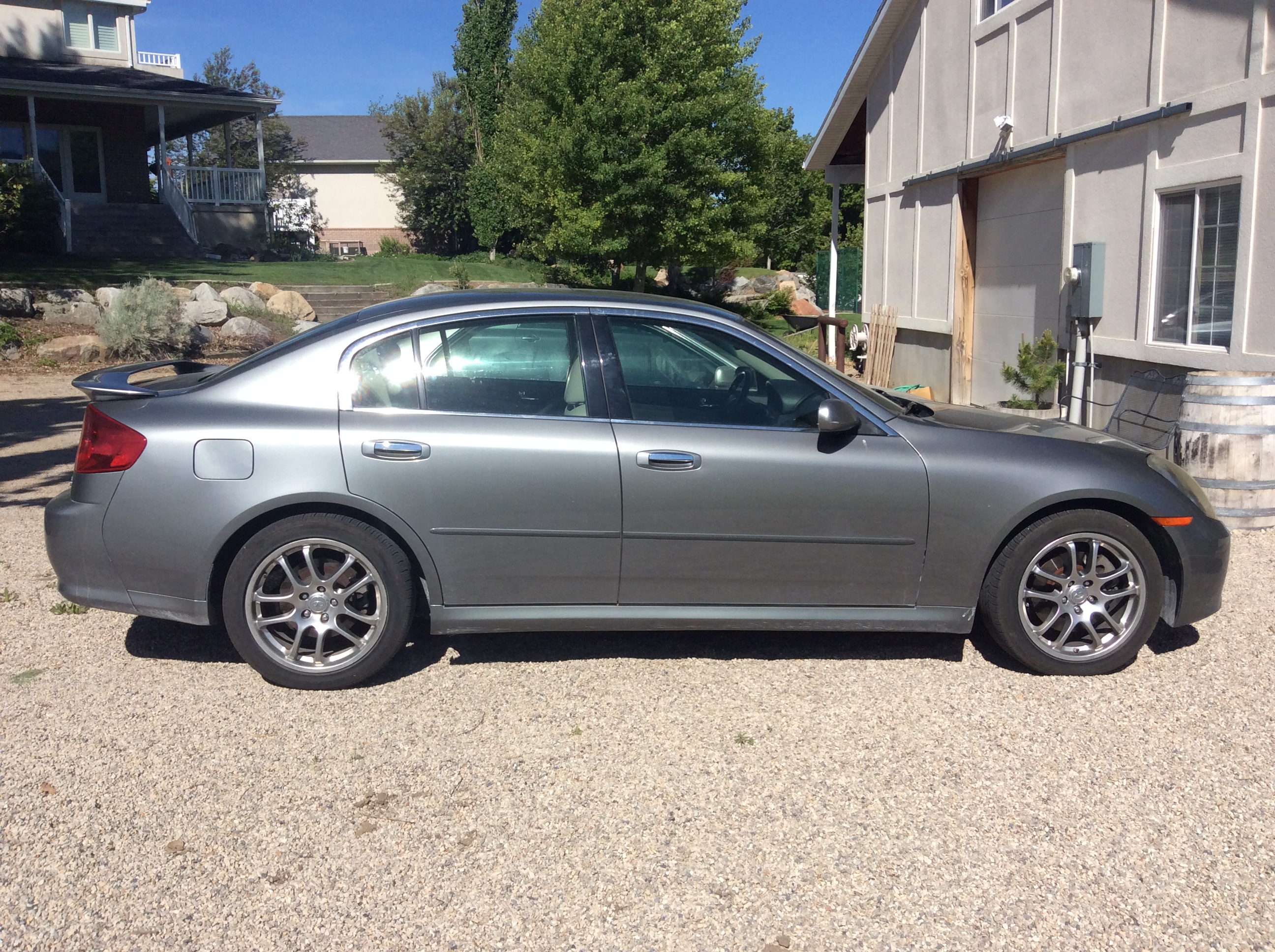

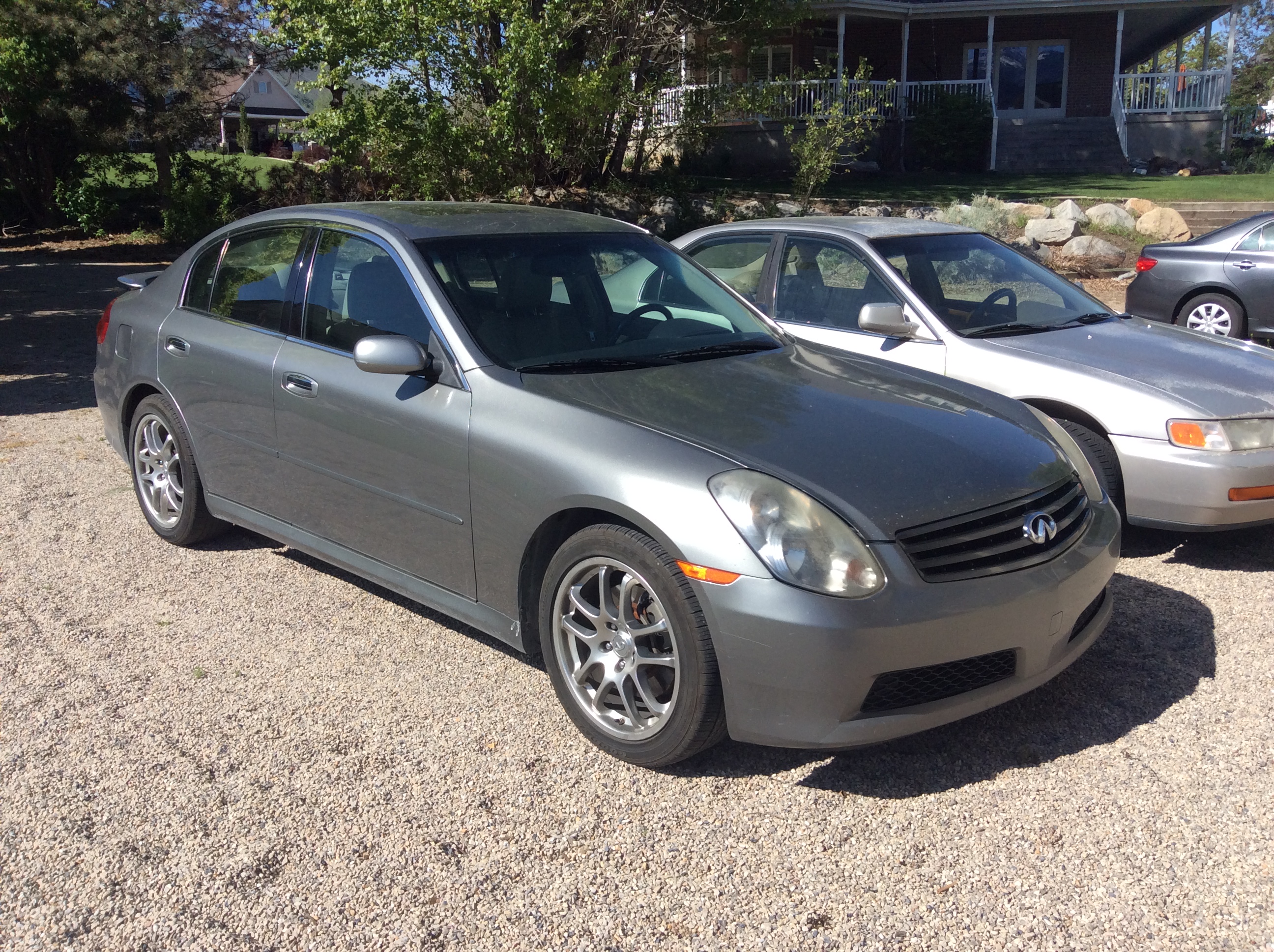

I've included some pics (they are rotated in the thumbnails for some reason but aren't when you click on them) and when my upload to YouTube is complete I will include a link to it that gives a little video rundown of the car so you can get a good feel for it.

FWIW our headlight plastic sucks. You can restore them but they'll just go yellow again in a few months. Just accept it. The only other option is replacement. If you're replacing them you can go with cheap ebay ones that look look too rice for my tastes, or find a nice OEM donor pair. They're out there, you just have to be patient.
