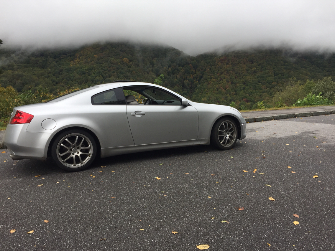

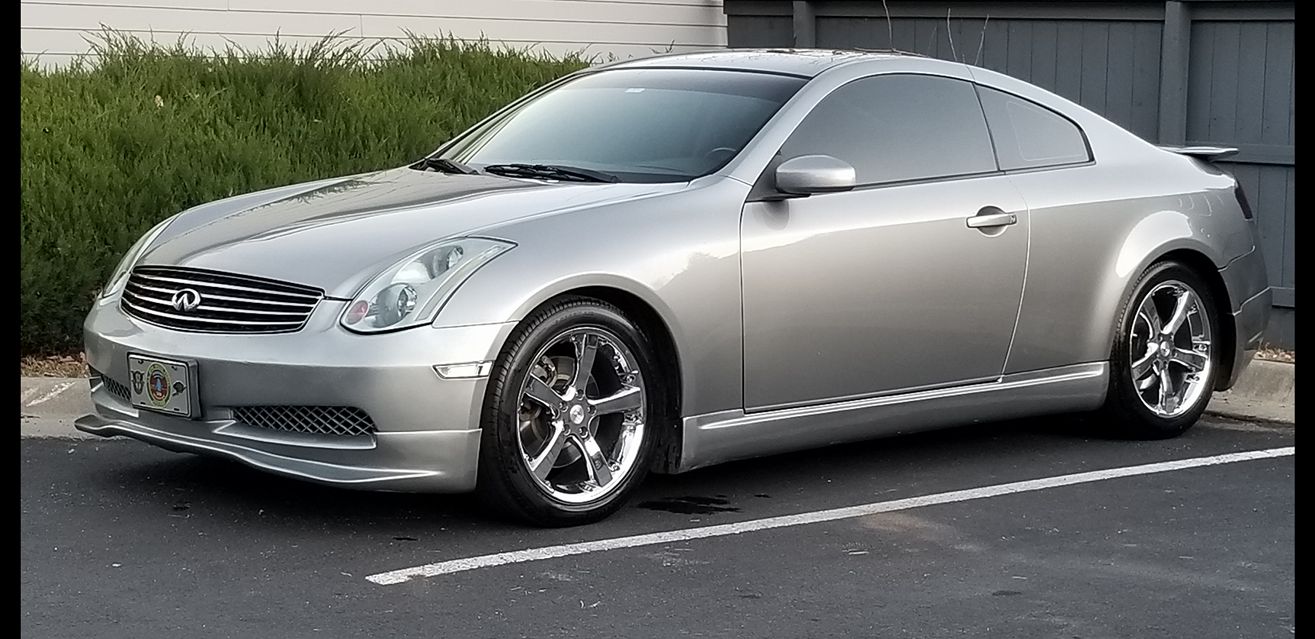

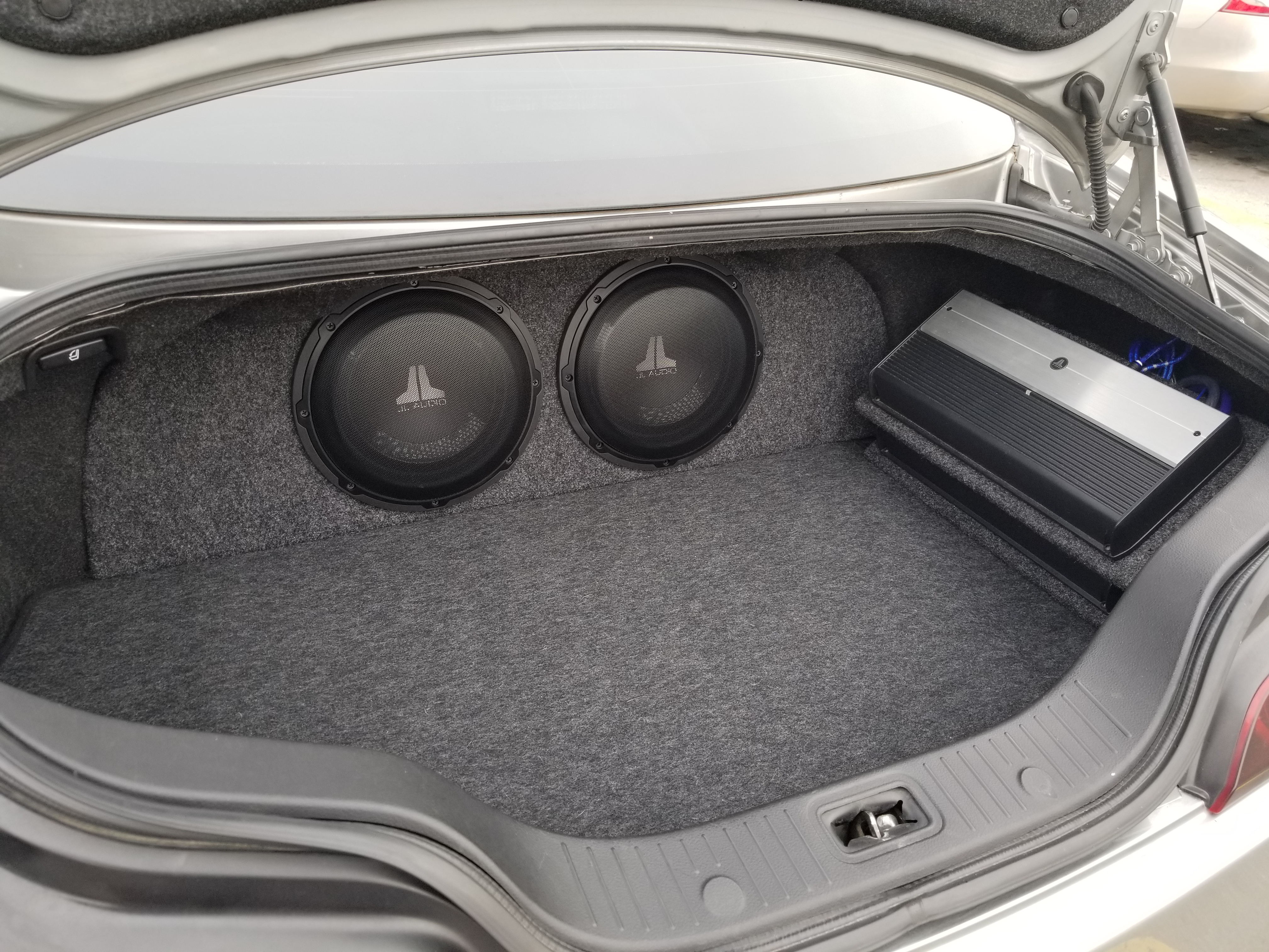

Attached Thumbnails Just Another New Guy Without a Clue-25358322_1059219384218333_3852581116189480733_o.jpg   Just Another New Guy Without a Clue-sc10.jpg   Just Another New Guy Without a Clue-20171219_133851.jpg

Btw I really like how clean the trunk woofer install looks, whole car looks great, welcome aboard!
