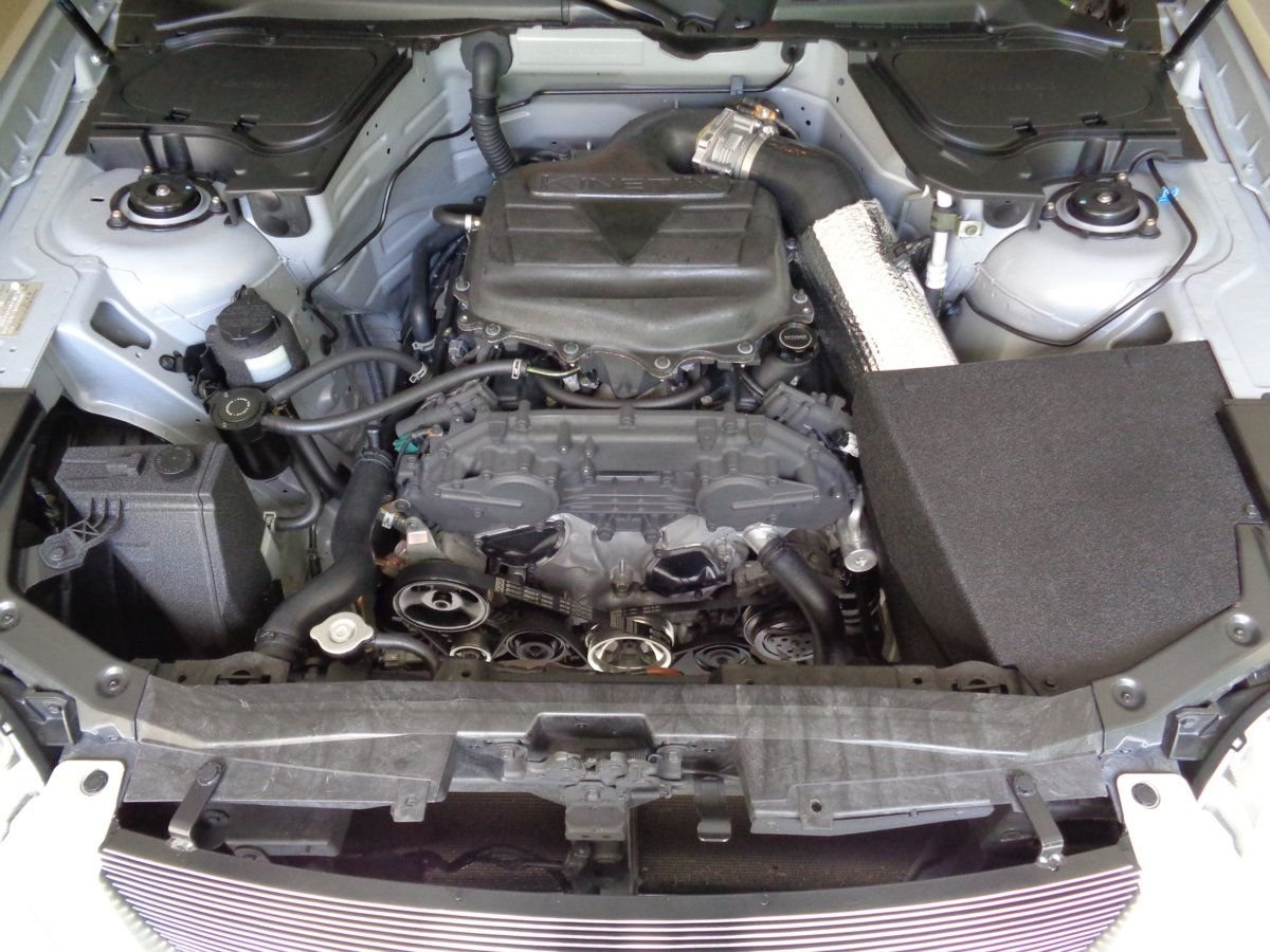

My little diy build thread; https://www.infinitiscene.com/thread...e-mods.230572/
