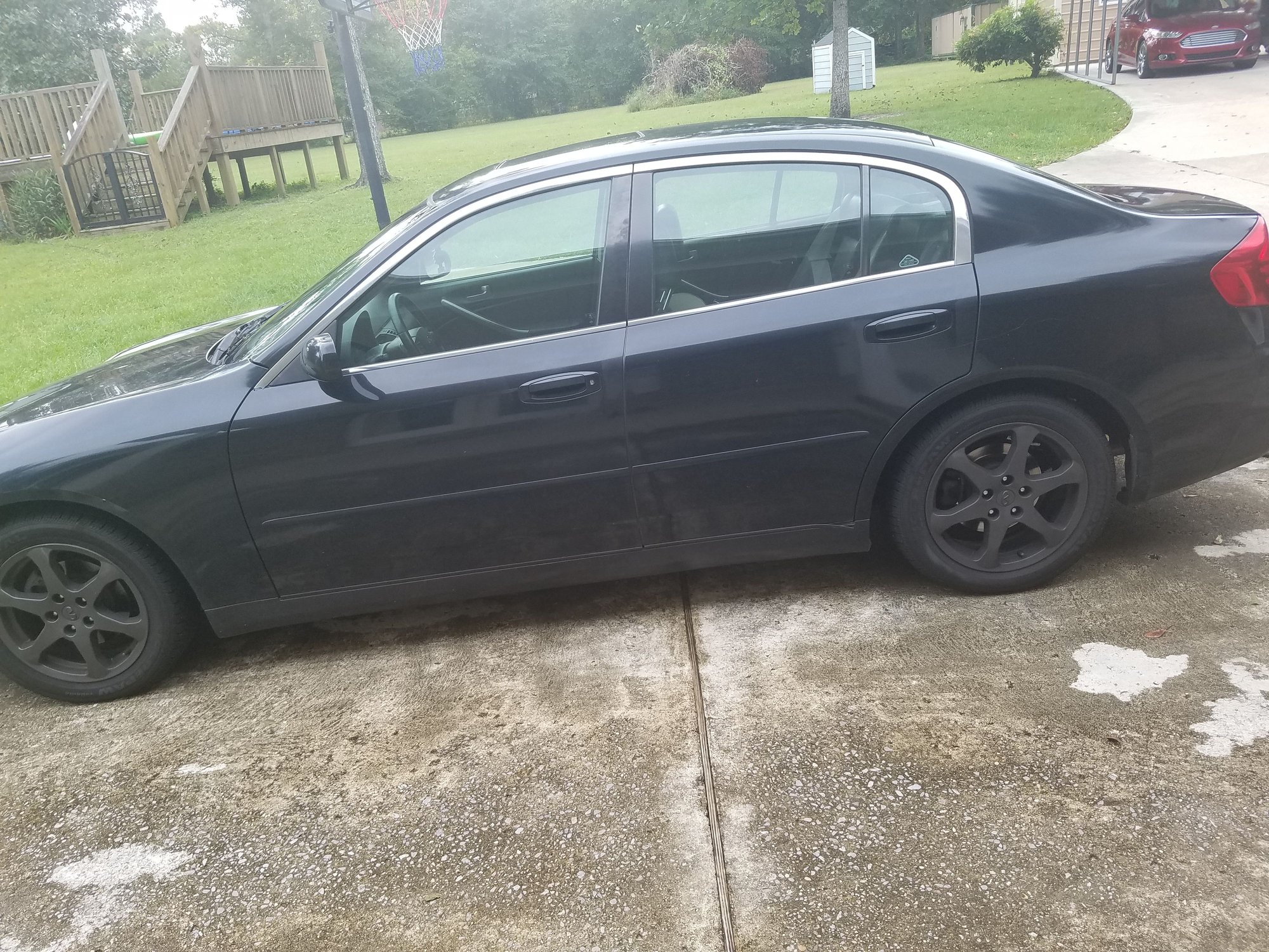

Figured id add some photos

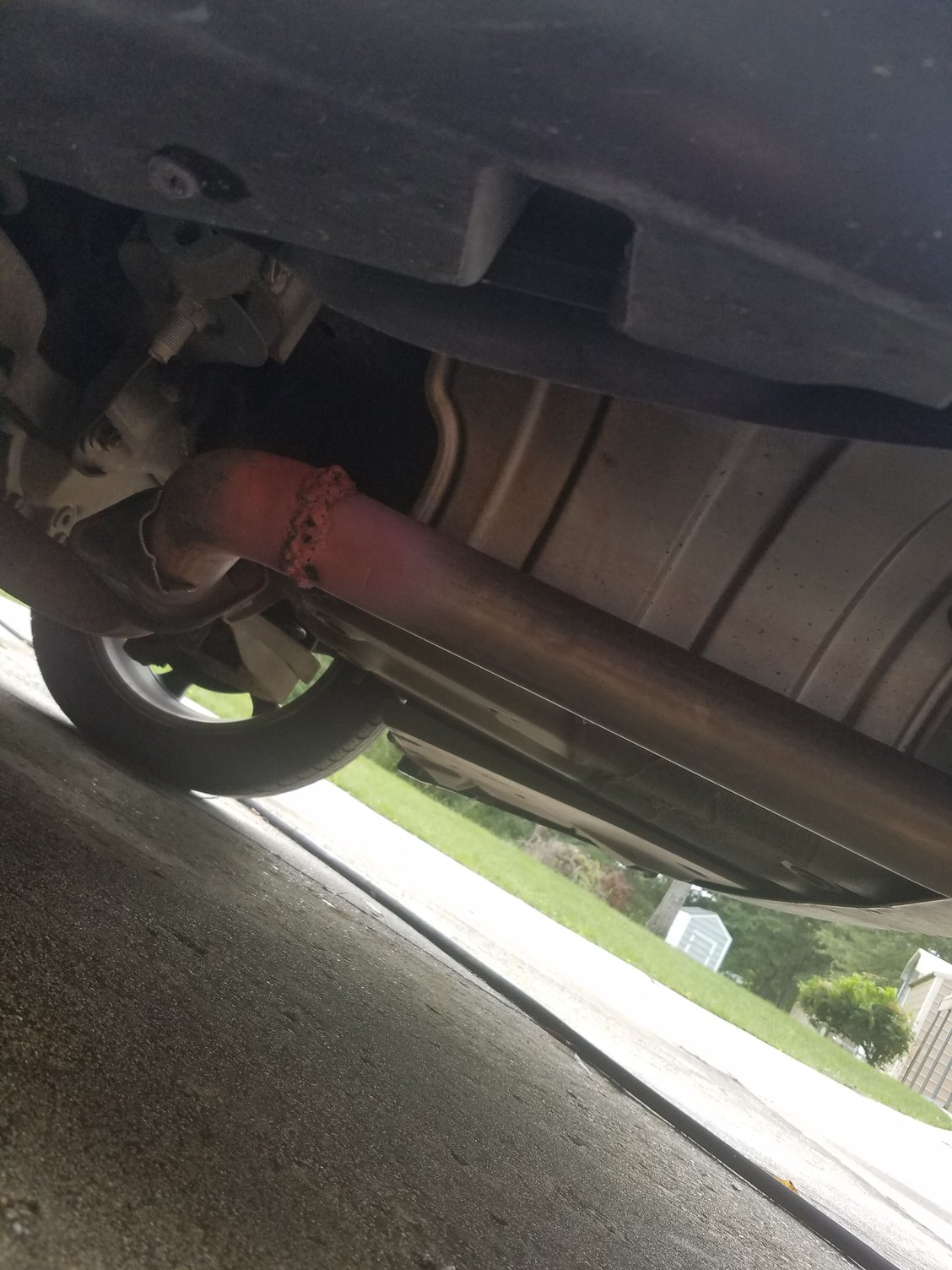

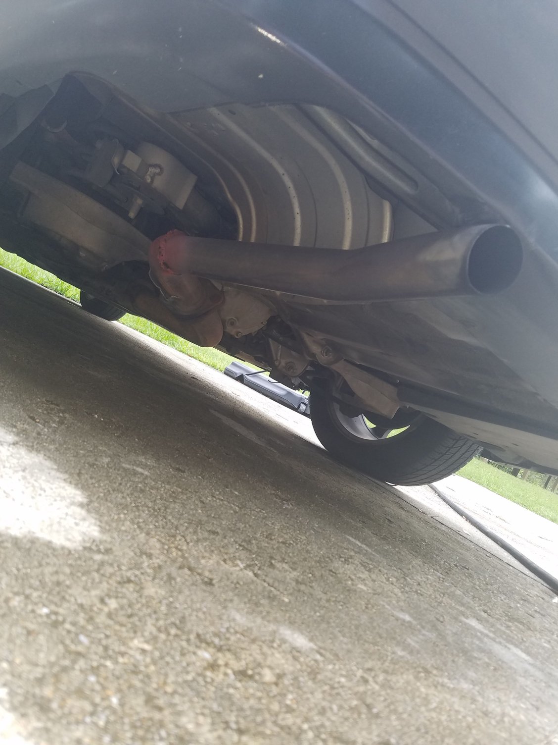

Plastidipped the front and back badges as well as the door handles. Painted the wheels gunmetal bc they looked like ***
Deleted the muffler and welded on a random exhaust pipe found in my friend's yard

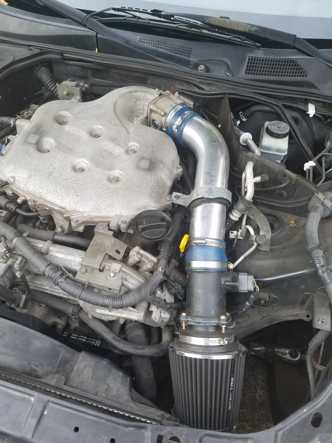

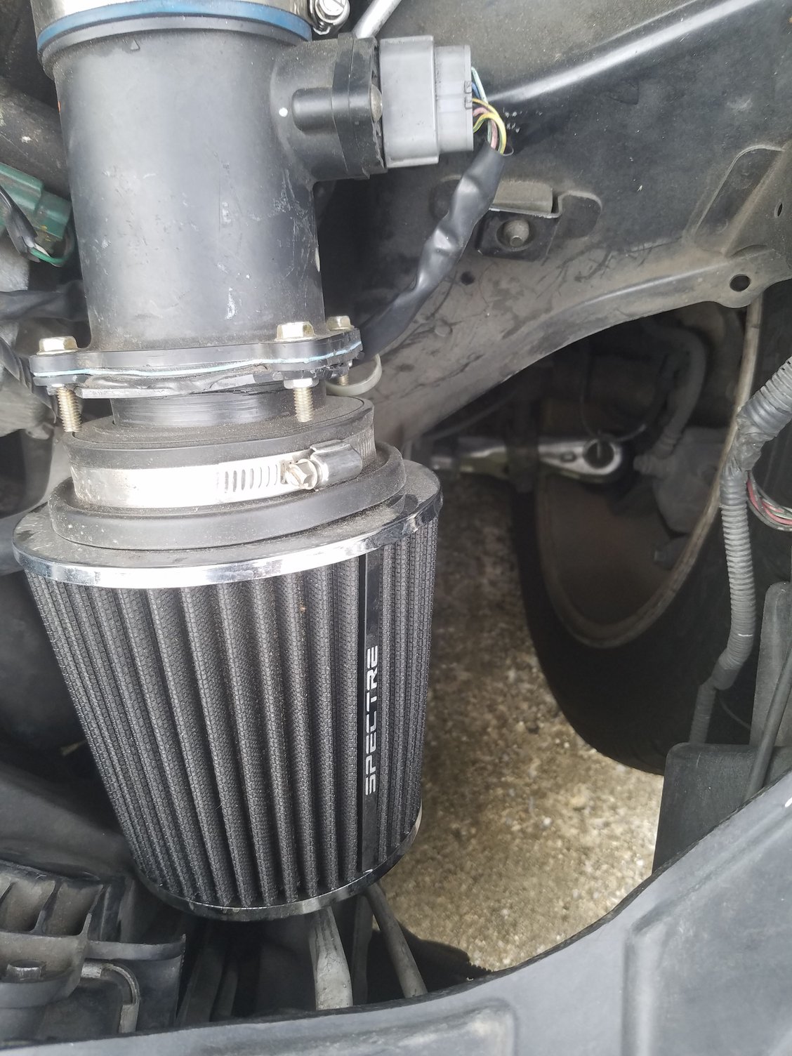

The plastic fender got ripped off when i took it offroad, so my RAM intake is now actually a cold air intake
The stock intake was dry rotted when i got it, so i replaced it with a garbage tube i found on ebay. The filter it came with ended up falling apart, so i got this one from autozone. Yes, that is a hurricane strap holding the tube in place. Lots of ghetto work done, but ive done it all myself (with help of some friends).
