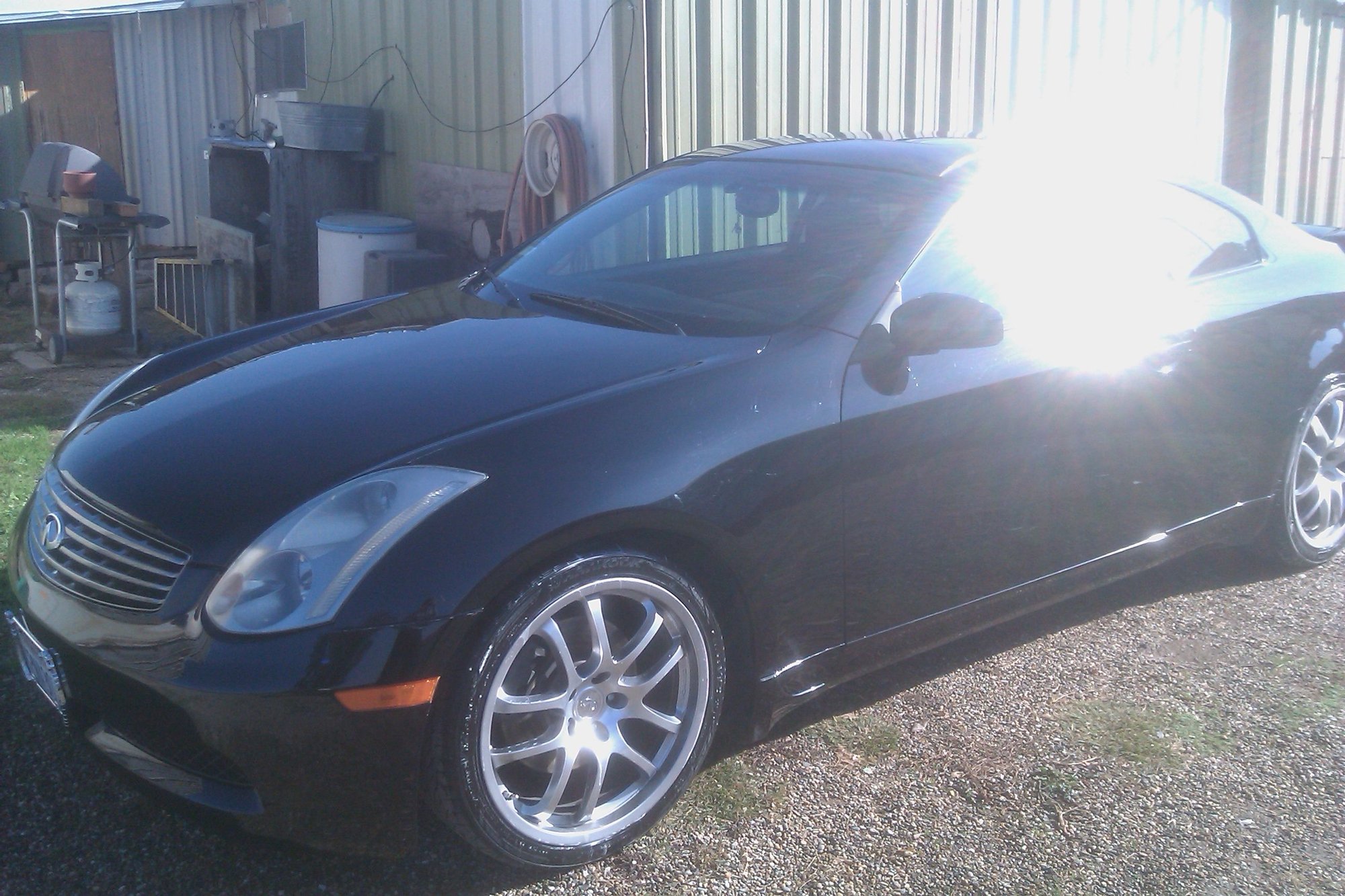

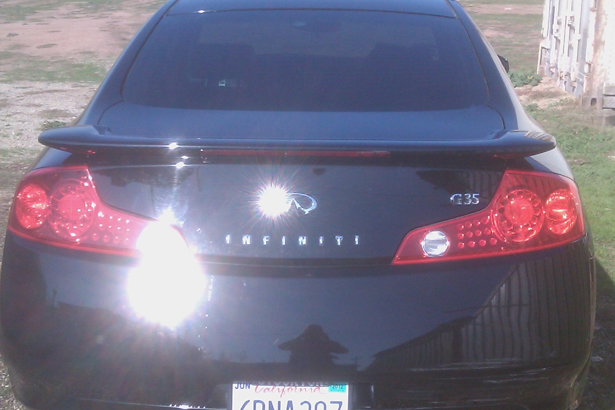

2005 g35 first infiniti
loved loved this car!

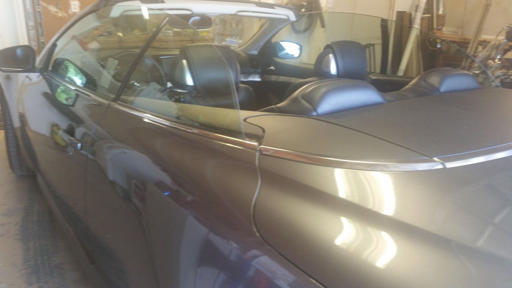

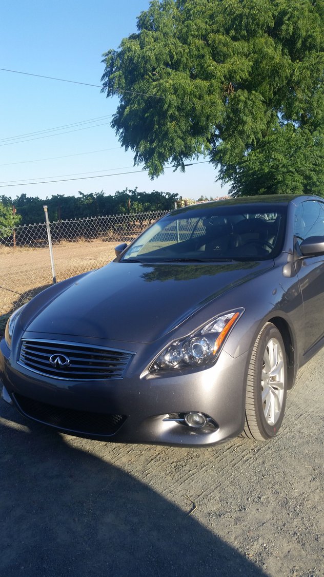

2013 coupe convertible

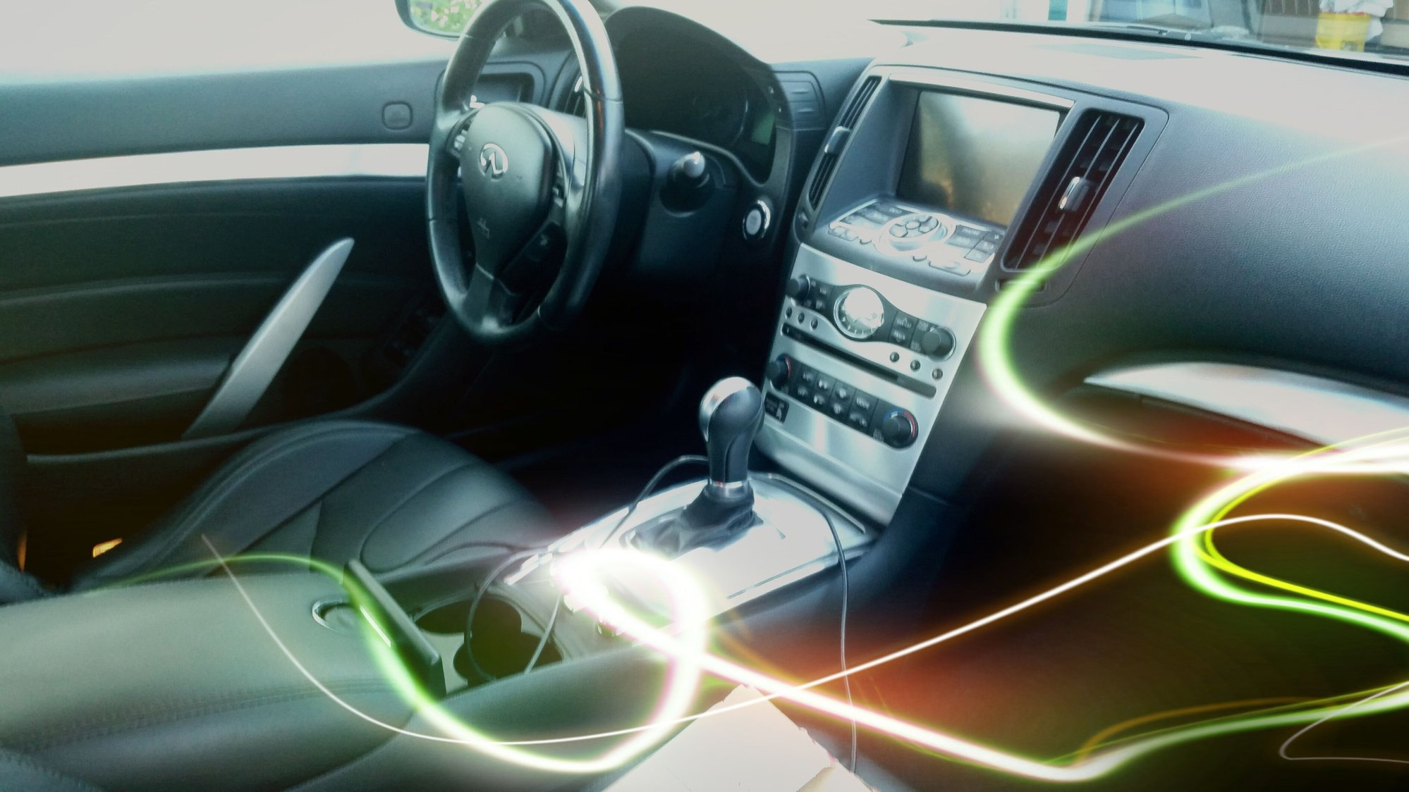

2013 g/37

Welcome to the forums, nice looking car.
Unfortunately the convertible option adds quite a bit of weight to the vehicle which you will definitely feel when accelerating, the best way to offset that is some power adder bolt-ons like high flow cats, good cold air intake, and an Uprev tune will get you about +50whp and will make the engine feel significantly peppier. If you want to go with a full cat-back then you have a TON of options but they will all be LOUD. The HFC's will make it louder than stock but not LOUD.
However that 7AT will still hunt for the right gear, the Uprev tune will help since they can adjust line pressure but the real solution will be the GTM valve body upgrade.
You should also look into a front lip spoiler, makes the front fascia look MUCH better and gets rid of a lot of the "roundness".
