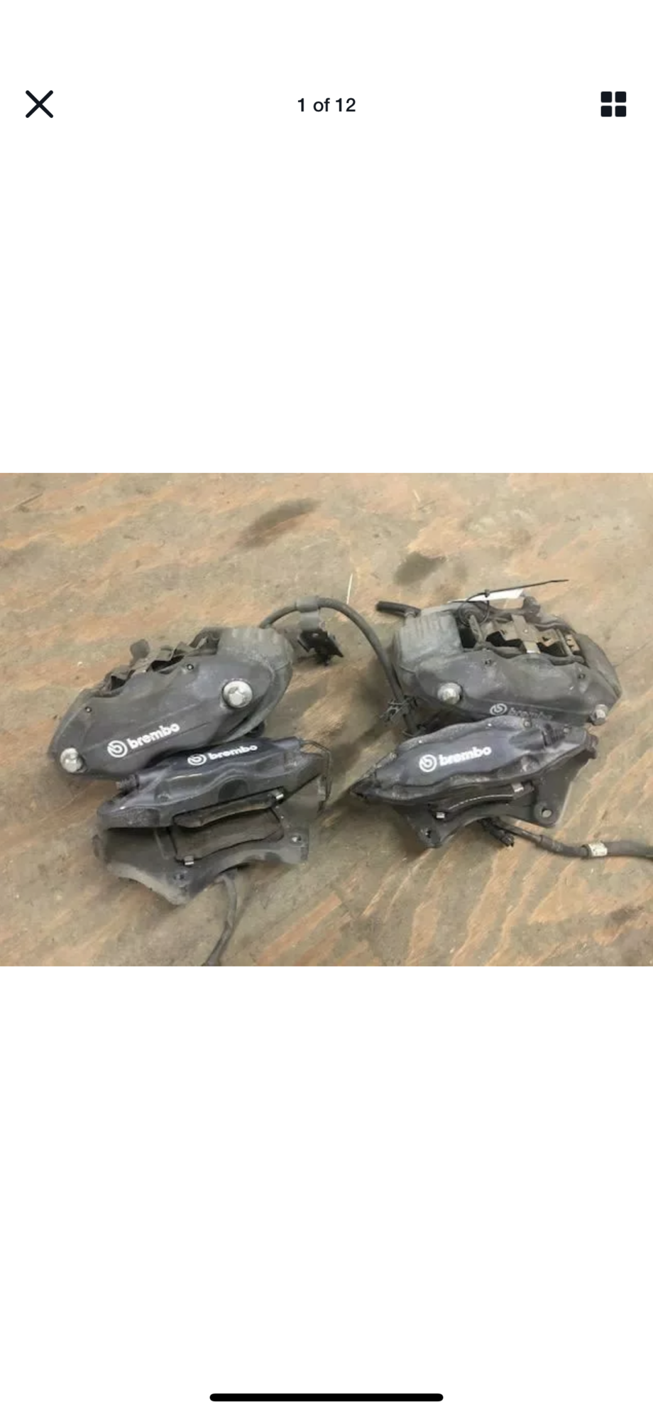

I’m in process of buying a set of brembo calipers they are all 4piston I have an 06 g35 couple what size rotors should I get ? Is this project possible?

Should be 4-piston front, 2 piston rear. You'll need the rotors that came on the Brembo equipped G's/Z's as well. This has been done hundreds of times before, info is very easy to find, search is your friend.

There are HUNDREDS of different Brembo calipers out there, you need the ones that came as factory OEM equipment on the 2003-2004 G35. Brembo makes OEM calipers for MANY different vehicles.
Anything else will require a custom made bracket to adapt. The OEM rears were only a 2 piston so whatever you're buying is probably not from a G35/350Z and probably won't work without manufacturing custom bracket and finding rotors that will fit.

So basically if they are from Nissan they wouldn’t work ? Below are the set of brembos from an 2012
srt 8

Nearly every model of Nissan uses a different brake caliper, 2012 WHAT exactly.
Nissan Rogue? GT-R? what?
It's like going into a parts house and saying "I need an air filter for a 2012 Ford". There's a dozen different vehicles Ford made in 2012 and they all used a different air filter.

Those are 2 piece front and monoblock rears, tbh they look exactly the same as my buddies Charger SRT8 OEM brembo calipers.

2012 srt8 I forgot to finish my sentence lol

Ok that makes sense, I thought it looked familliar
No it won't fit on the G without making an adapter bracket and sizing some appropriate diameter rotors.
