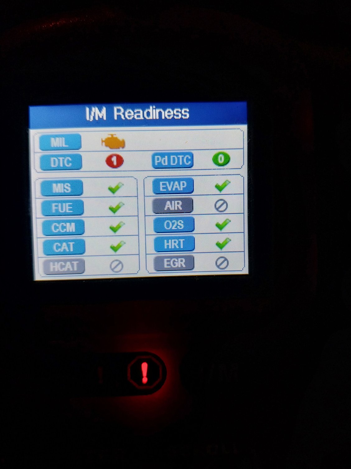

What is going on here guys
Both upper o2 sensors replaced. Went back and threw a P0420 code. What could be the real problem?

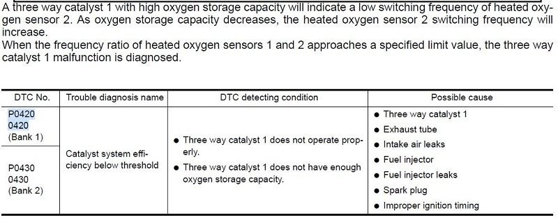

Welcome to the forum. That DTC is not necessarily indicating sensor 1 is bad. It may not even be a bad sensor, a lot of things can cause that - a bad or clogged cat might be the most likely. The troubleshooting steps are in the Factory Service Manual found here. Go to section EC and lookup that DTC.
