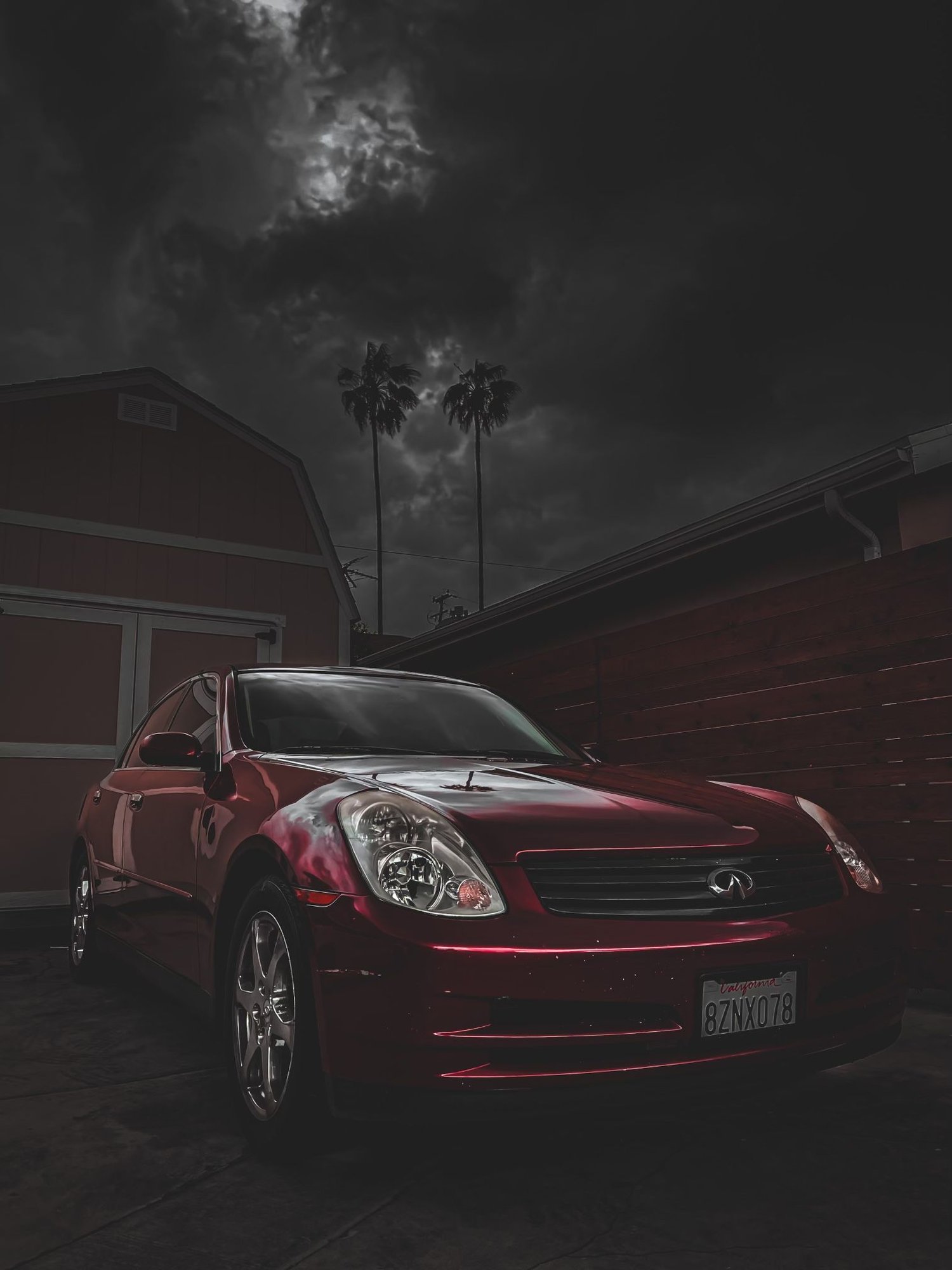

Hey, my name is Ethan! I’m new to the Infiniti family and have started planning different parts to replace. I’m looking to get new valve covers but I’ve been seeing different brands other than the OEM ones that are a bit cheaper. Looking for some insight to these other brands and which ones I should look out for.
Also here’s my G. Thanks for the responses!
