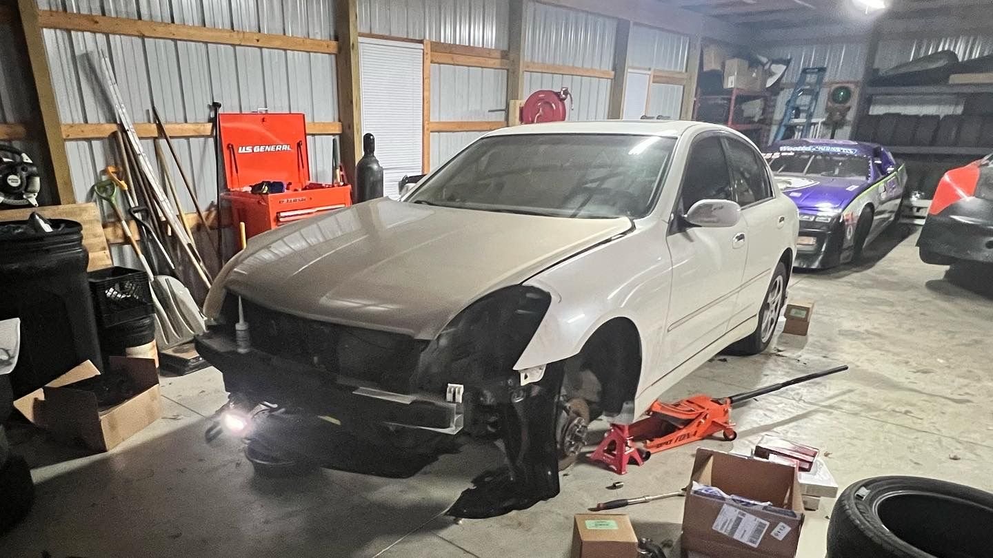

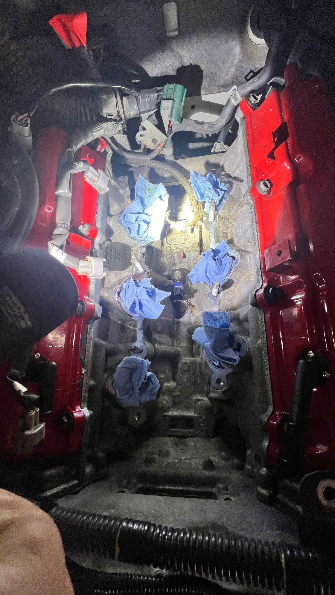

When I bought the car, we knew there was a single cylinder misfire, issues with the rear suspension, all rotors were rusted and falling apart, the calipers were locked up.
Upon tear down, we noticed a rats nest under the intake manifold, in the valley of the engine. The knock sensor harness as well as the fuel injector harness were chewed up. The “single cylinder misfire” turned into replacing the valve covers with an aluminum set that had serviceable spark tube seals. Cylinder one had blown seals that caused oil to leak into the spark plug tube.
in the past two months, the following items were replaced/overhauled:

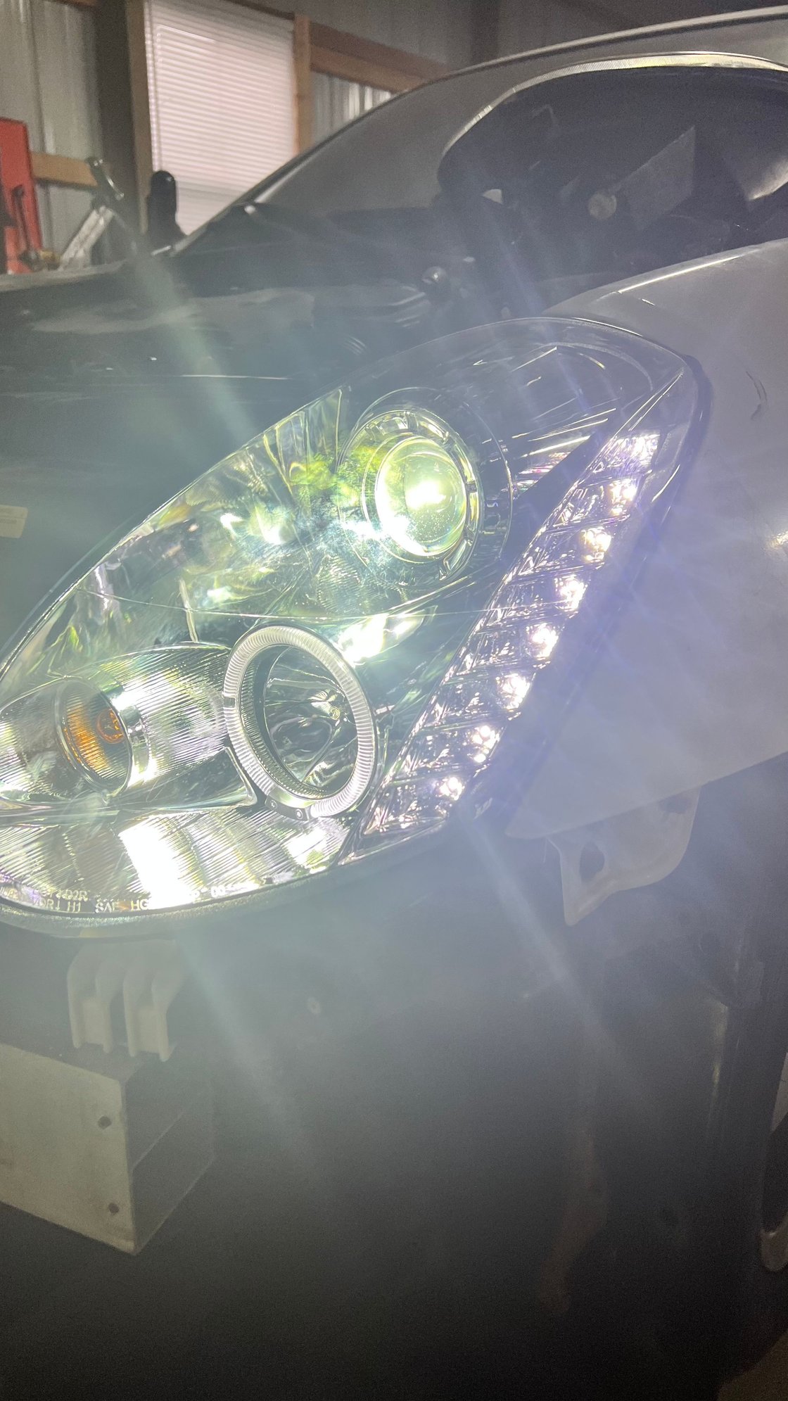

and the first aftermarket part… Spec-D projector headlights

Right before the initial tear down, where we removed the mismatched hood for easy access LOL

Realizing we had more work to do than the valve covers…

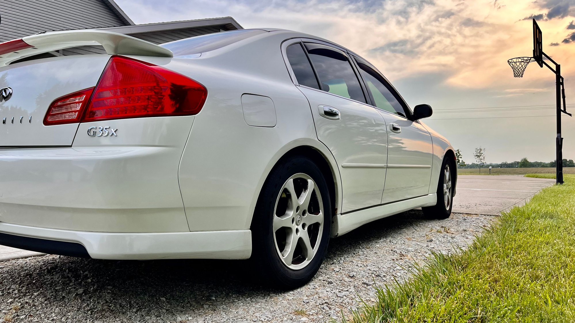

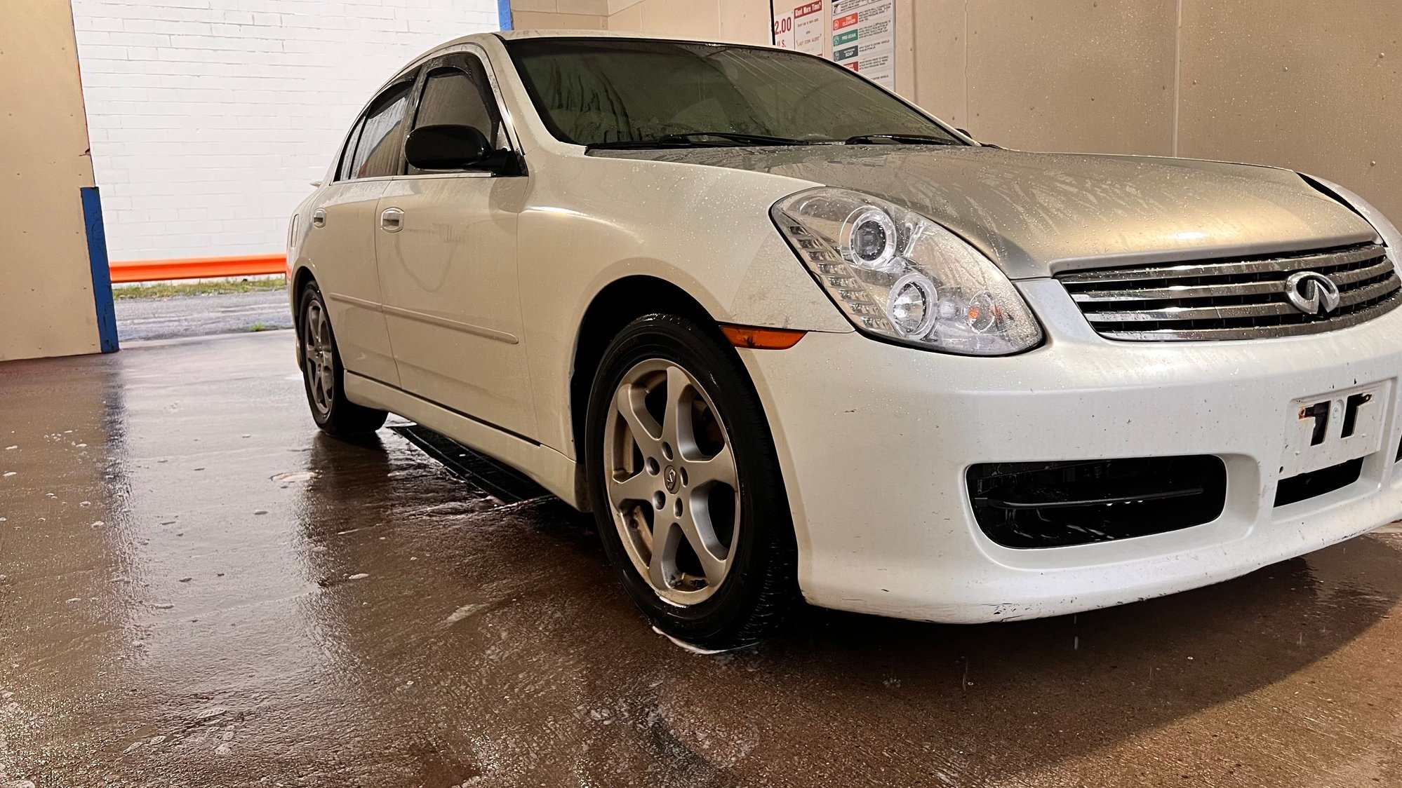

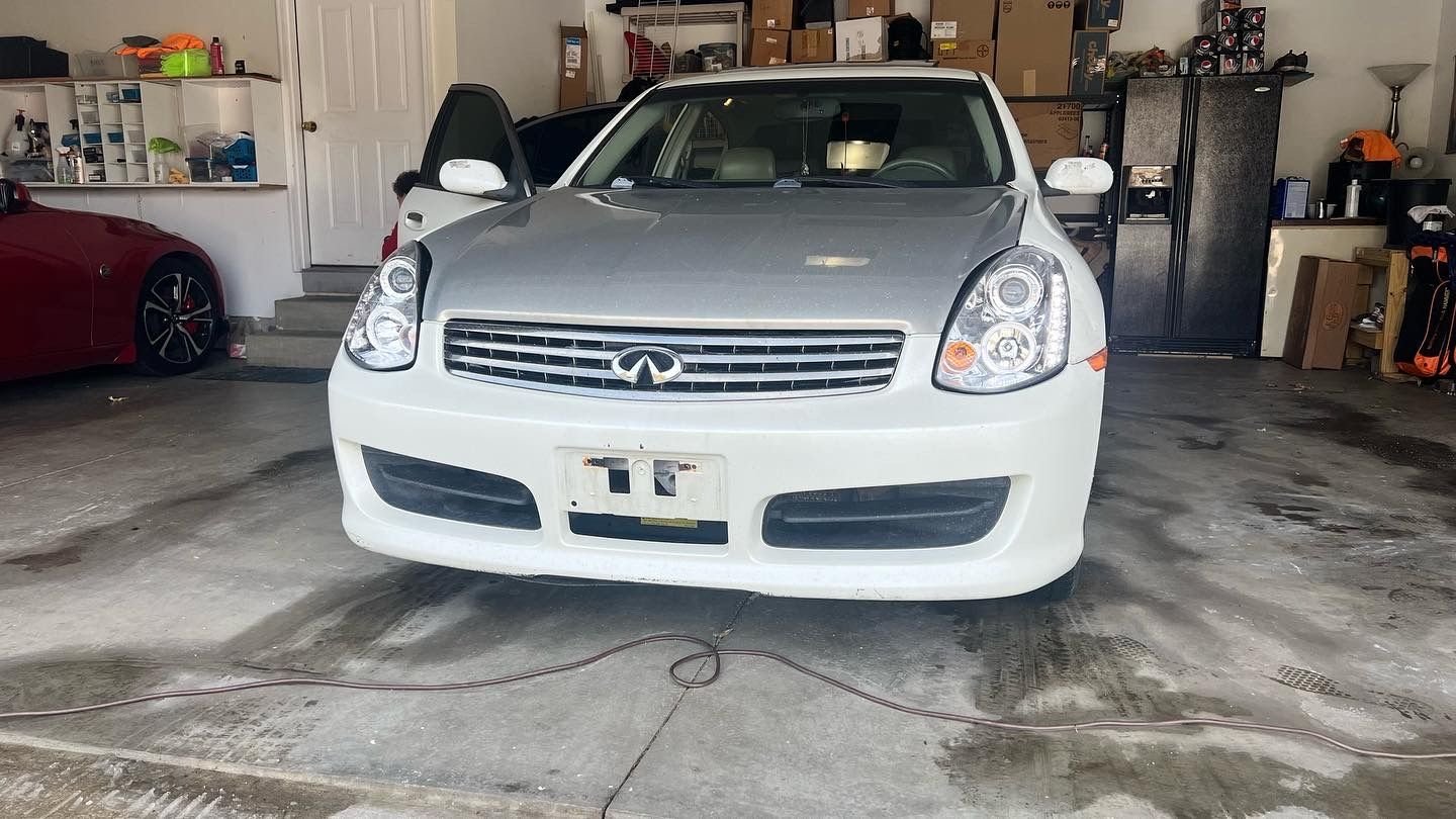

Registered, power washed to remove gunk and back on the road! Planning on a deep detail this coming weekend.

Looks good, should be a fun ride. But I gotta ask, what is going on with the headlights??? Are those coupe headlights that you stuck on there?

My car initially looked like that but it's a black sedan. My driver's side headlight assembly must've been from a coupe because it looks odd plus there's a noticeable gap between the assembly and the hood. My liking of a junkyard 1.5 hours away had me replace that assembly with a better one. Now I'm stuck with a coupe assembly.
Nope, they're just 05/06 headlights I bought. The mis matched body lines don't really bother me much. I wanted projector headlights since I live out in the country kinda, and do a lot of night time driving. It's given me some headaches as far as the wiring goes. But I want to retrofit the stock headlights eventually.

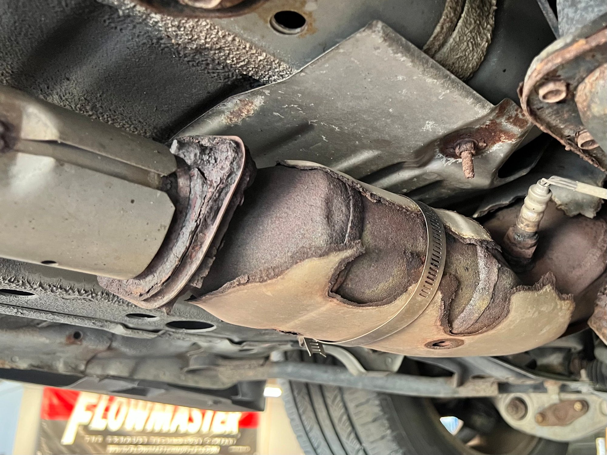

Exhaust work finished

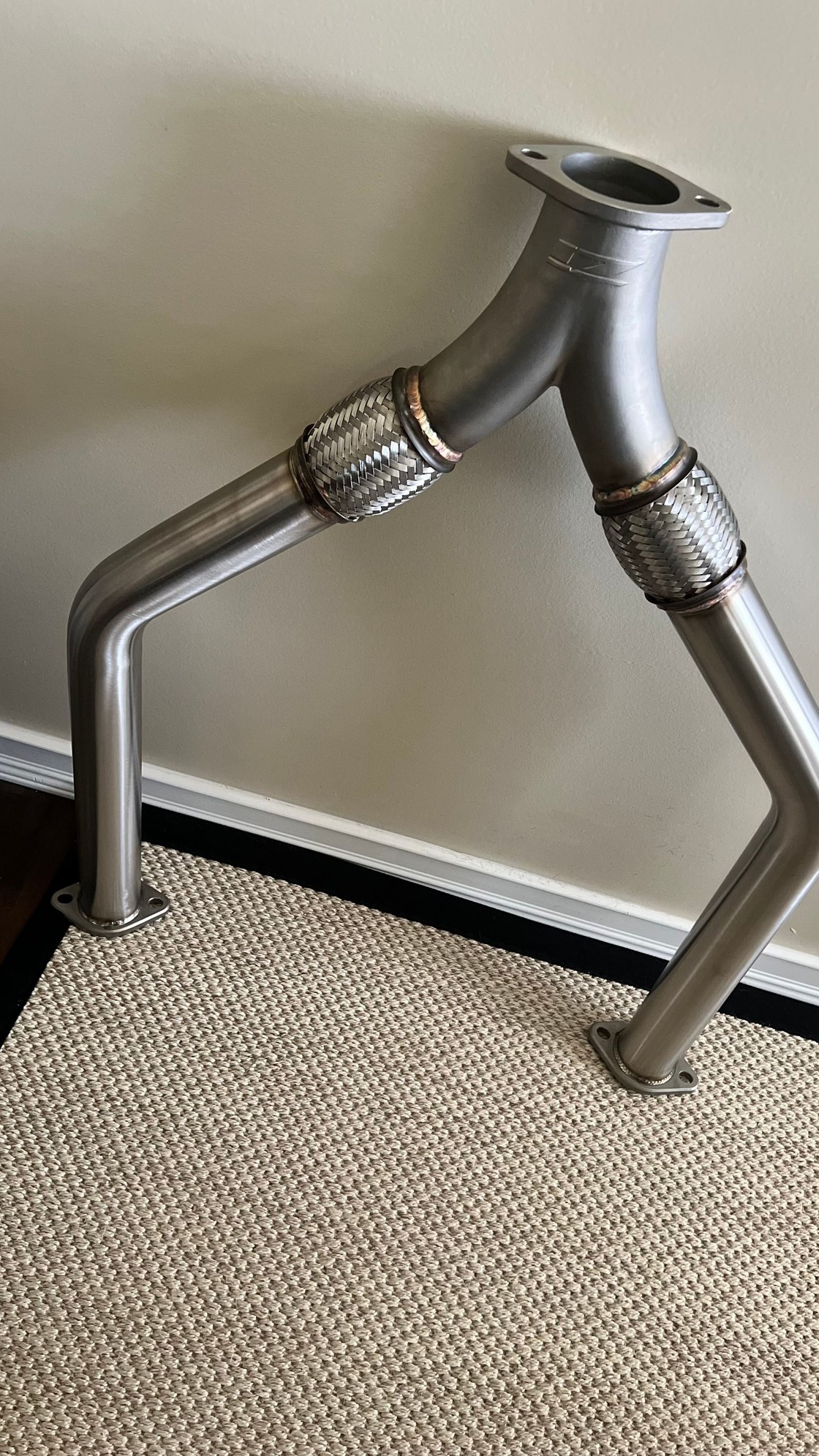

My resonator fell out during a stop at Panda Express one day. I had a straight pipe welded to the stock Y-pipe all the back (&#128169 in April.
Piece by puece I ordered a full exhaust.
Megan Racing resonated test pipes, AWD Y-pipe from Z1 as well as their muffler.
FINALLY got it installed this past week, and could only be a little happier. There's a little rasp left is whatever... it's a straight piped V6 at this point 🤣 Luckily Z1 sent a silencer with the muffler that works surprisingly well so I'm happy.
Now we move on to suspension...
The stock exhaust was in pretty bad shape already. Both sides looked like this and I felt compelled to give this car the exhaust it deserves for now...
I'm sure the bit of rasp left over is due to the flex pipes in both the Y and test pipes
Updated pic after a single stage polish 😮‍💨

It’s definitely the test pipes, it’s where a majority of the volume and rasp comes from.
Recommend HFC or resonated test pipes only. If you are feeling fancy, Motordyne ART pipes do a great job of quieting the rasp and increasing power. I know a guy looking to sell a set too 😉 (I need to make a post!)
I've already got resonated test pipes on.

OP, resonated test pipes won’t stop it. HFC or art (type) pipes.
