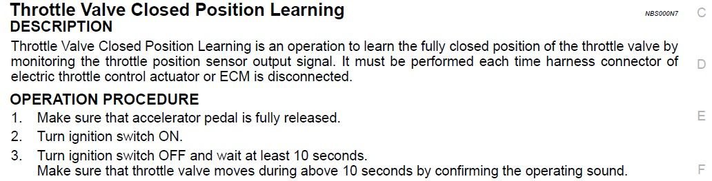

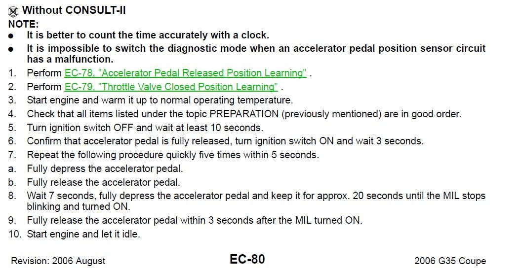

There is a recalibration that needs to be performed. Also, when unplugging stuff from your computer make sure you DISCONNECT THE BATTERY.
If it still isn't functioning after recalibration double check the harness to make sure you didn't bend the pins, it's pretty easy to do.
If it still doesn't work you probably got sold a defective unit.
Also, when in limp mode like that you should be throwing a CEL code.
Here's the throttle closed recalibration, and the ACC pedal recalibration. Do them both, use a stopwatch or timer because the seconds counts need to be very exact.

You will also need to perform the idle relearn after you do the two previous recalibrations.
