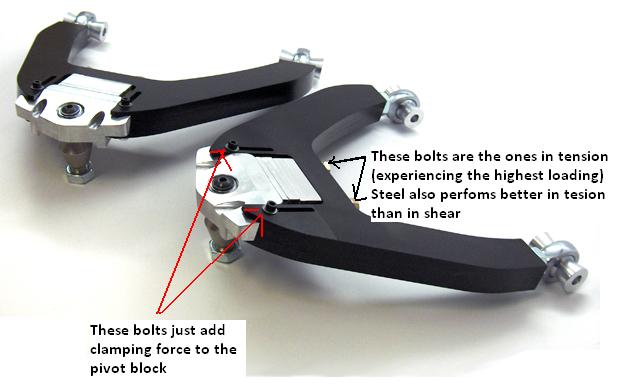

I understood that they were different, but I dont see the gains in going with the more expensive set. Could you elaborate Arnab?

Well, the SPLs are shim based adjustment and they also put the adjustment bolts in tension(stress along the long axis of the bolt) instead of being in shear(stress across the diameter of the bolt). This will allow for greater lateral loading of the entire conrol arm. They are also machined out of a solid block instead of welding(induces much more stress and bending into the part). Also, shims are usually a better way(if designed properly) to adjust things than sliding grooves or slots.
The SPLs are also just "beefier" and have pivot bearings instead of shaft bushings like the SPCs. This allows for a litte more natual movement and allows for slight miss alignment with out any negative effects on the system.
There is nothing wrong with SPC(I am actually looking into these as well) but the SPL arms are just a better design from an engineering standpoint.
correct me if I am wrong. But these are my thoughts...
hope this helps.

Rambo nailed it. SPCs are very solid pieces too. I am definitely considering them as well. The SPLs are as Rambo said, better engineered for track duty and a bit more solid overall. Honestly speaking the SPCs are perfectly fine for everyday driving and tracking the SPLs just give you that extra degree of engineering for marginally improved performance. Not sure if it's worth the extra $225 yet based on my needs. But I only buy things once and Id rather just get them now if I anticipate I may need it in the future.

Great explination Guys! I do see the difference now thanks to the pics...and I agree that I couldnt justify the price difference for my car. If you guys get them, I would love to see them in person to see the engineering superiority.
