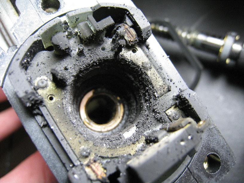

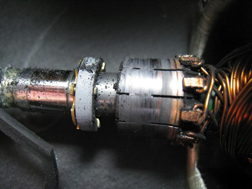

I had the same issue about a month ago...My window got stuck in the down position though...and would NOT come back up.
I tore the door apart and pulled the motor out. What you do is take the motor apart. You will need to separate the two halves and pull out the armature. You will see two metal contacts inside where you pulled out the armature. They are called brushes. You will need to make sure they are clean of debris (mine was really gunked up). Do a good job cleaning it up and and spray some lithium grease back down into the gear and put it all back together. There is a procedure on how to reset the anti pinch mechanism once you get it all back together. if you search you will find it...I don't remember off the top of my head but it was easy. Get in there and go for it!

I forgot to mention....My window works as good as new. It even sounds stronger when its operating. Save yourself the $200 and do it!

From what I understand it is really only a problem on the coupes. Some people think its because coupes have heavier glass but use the same motor.
