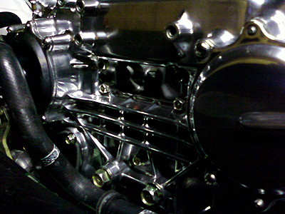

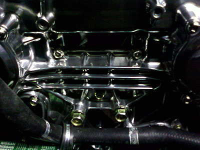

Originally Posted by Elmecano
ok
I know for the dremel it is what I use for tiny place and corner.right now I am on 400grit by hand but I cant figure how do go in these deep hole all the attachment have like 80grit that is way to big
if this is the area you're talking about (see attached pix), just take your time because its particularly rough. my process was sanding up from 400 -> 600 -> 1,000 -> 1,500 -> 2,000 grit sandpaper, then finishing up with jeweler's rouge and a dremel. that area is very tight and deep (giggity), so i wrapped the sandpaper around a 1/2" wide x 1/8" thick piece of wood so i could get in there with some force. btw, make sure you're wetsanding (a spray bottle of water is useful). don't just go sticking something in there dry and expect for things to go easy (giggity).
Attached Thumbnails RRYDE Custom Engine Bays-timing1.jpg   RRYDE Custom Engine Bays-timing2.jpg
