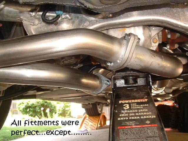

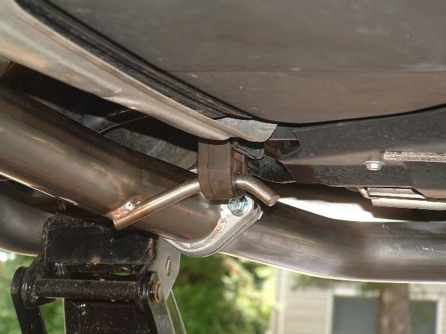

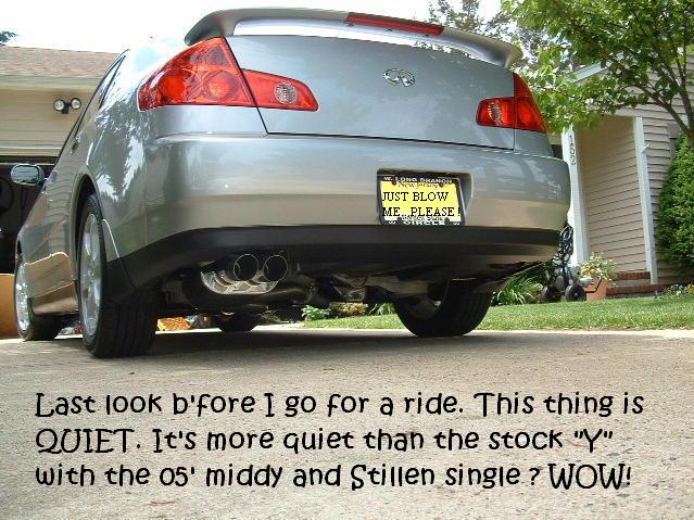

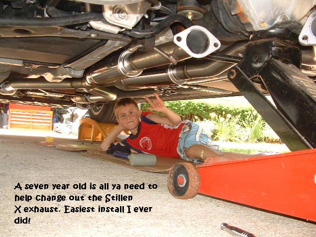

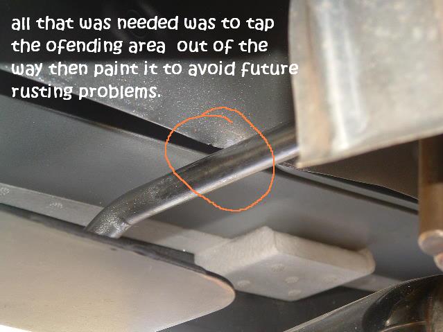

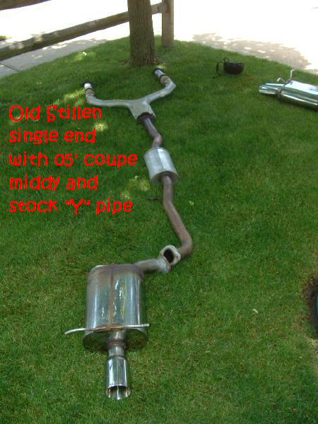

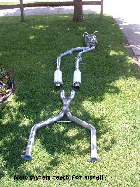

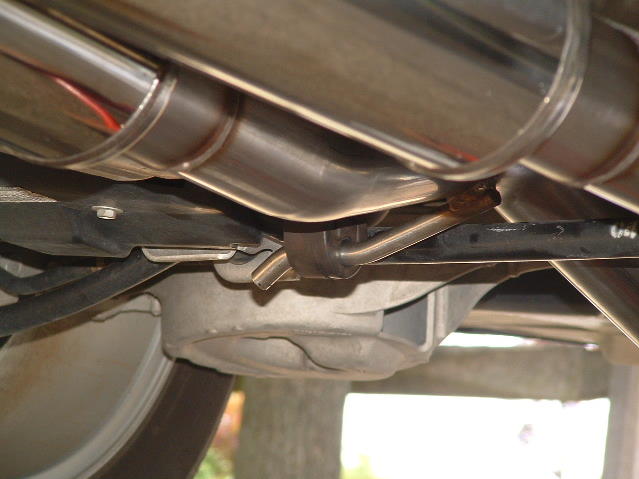

Nothing cheap 'bout anything on this system. Had Borla on my SC'd 02' Avalanche. Nice too, as you said.......many pieces and I also had major fitment issues. The 'final solution' was that I went to Corsa and never looked back. As far as my Stillen gen II CB goes...luv it and feel it was a worthwhile mod. UBC, jbx
Attached Thumbnails Kinetix cats on 05 6MT Sedan(long)-dscf0004.jpg   Kinetix cats on 05 6MT Sedan(long)-dscf0012.jpg   Kinetix cats on 05 6MT Sedan(long)-dscf0016.jpg   Kinetix cats on 05 6MT Sedan(long)-dscf0021.jpg   Kinetix cats on 05 6MT Sedan(long)-dscf0037.jpg
Old Nov 2, 2005 | 06:58 AM
JustBrilliantX's Avatar
Misanthropic nut-cracker
Joined: Dec 2004
Posts: 803
From: On the water at the "Jersey Shore"...Toms River

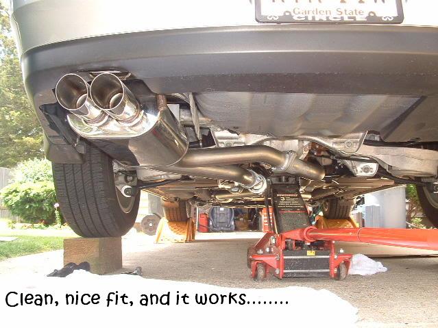

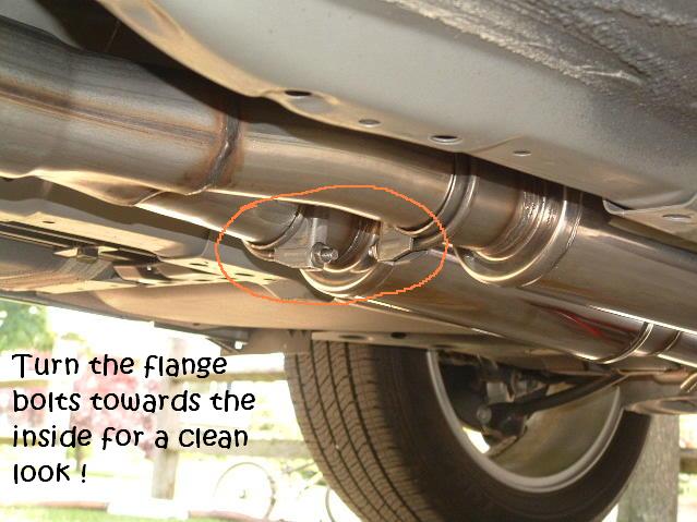

rest of pics
outta sequence, but you get the idea........
Attached Thumbnails Kinetix cats on 05 6MT Sedan(long)-dscf0033.jpg   Kinetix cats on 05 6MT Sedan(long)-dscf0038.jpg   Kinetix cats on 05 6MT Sedan(long)-dscf0039.jpg   Kinetix cats on 05 6MT Sedan(long)-dscf0045.jpg   Kinetix cats on 05 6MT Sedan(long)-dscf0048.jpg
