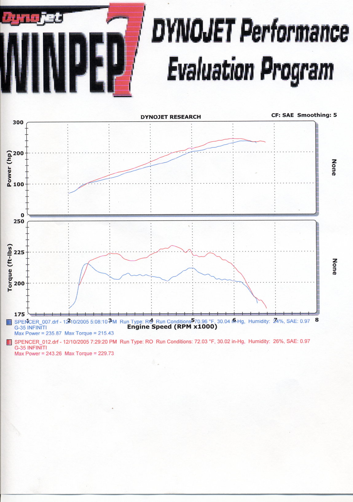

When I installed my mrev plus, I did not notice a difference at all. You can see it on a dyno chart around 4500rpm where the stock torque curve has a dip. At 2500, you can see the better torque curve of the mrev. As for the borla dual exhaust, I dynoed three times with the stock cats and manifolds. I ended up with exactly ONE hp and more noise. The drone is the worst around 2.5k-3k at part throttle in the higher gears. The dyno was so pathetic, I could not embarass myself by printing and posting it.
OK
Try this Take two aspirin, drink plenty of fluids, get a good amount of rest,
And PM DR. DaveO He will take very good care of you, And. Your friends here will get you dialed in, You will live thru this, and be happy. Pasta

Originally Posted by GEE PASTA
OK
This is DaveO's exhaust. The drone is not so bad but the power gain is less than minimal for the noise.
That is a very impressive dyno chart. Were these two runs the "best of" before and after runs? And it looks like they were about 2 and a half hours apart. Was the MREV installed at the garage after the first set of pulls? And did you get a chance to do an ECU reset before you started your second set of pulls? Also, did you dyno in 4th or 5th?
This comment isn't directed at you, but I'm disappointed that most dynos of the mrev we've seen haven't been taken out to 7k rpms.
Regardless, impressive numbers.
