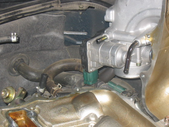

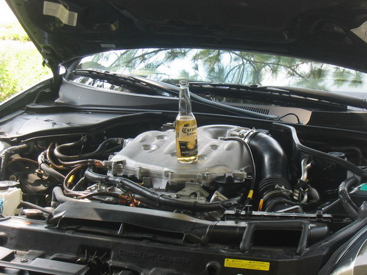

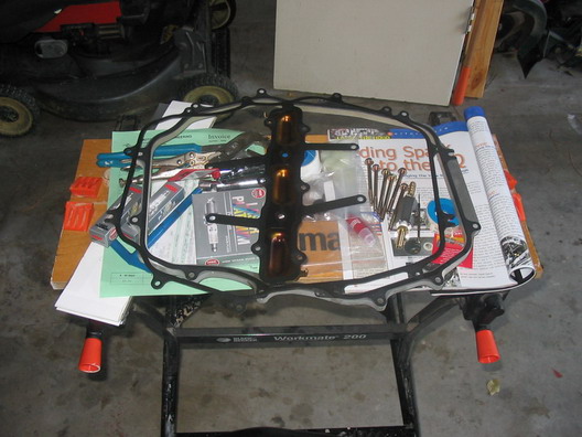

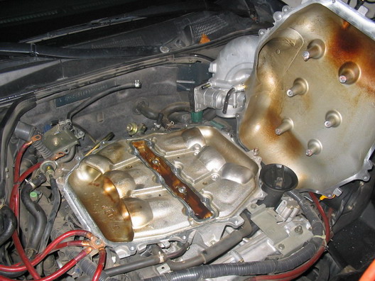

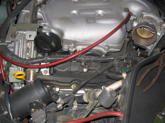

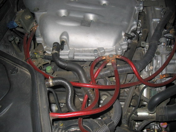

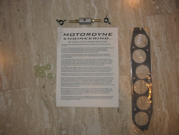

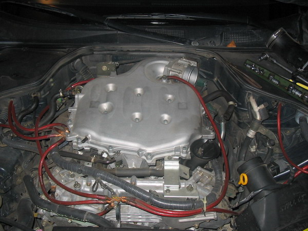

We had both previously bought and installed the Motordyne 3/8 " spacers. The first pic is of the Iso Thermal gasket upgrade along with the Coolant Control Valve. The next 4 pics are of my 2003 G35 Sedan's plenum before removal.

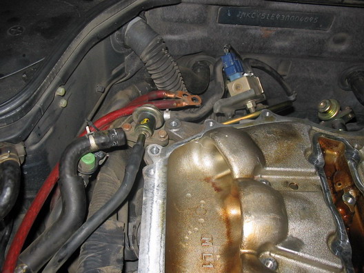

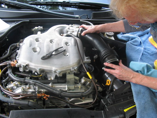

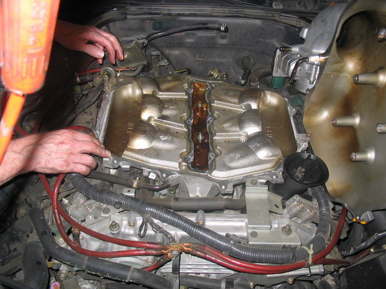

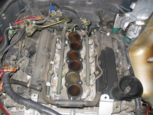

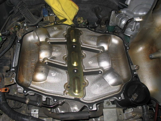

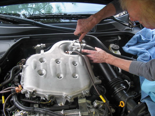

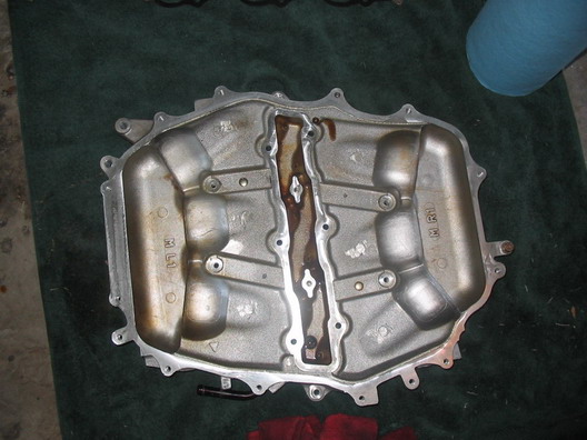

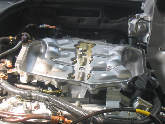

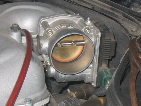

Removal of the upper Plenum required all the hoses around the throttle body to be disconnected. This was a real pain in the a** and does require two people to do it.

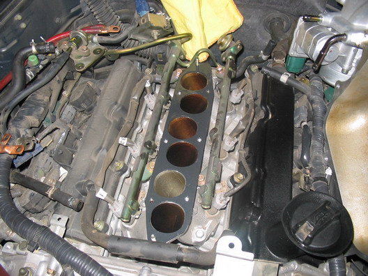

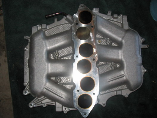

The fifth picture shows two bolts that were required to be removed before the lower plenum could be taken off. These two bolts were not mentioned in the Motordyne install guide. The fourth picture shows the plenum spacer and the two gaskets removed, sitting on the workbench.

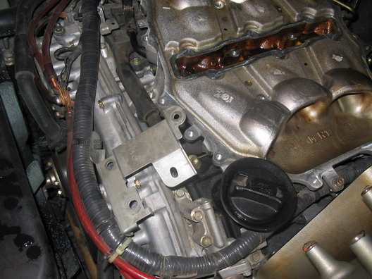

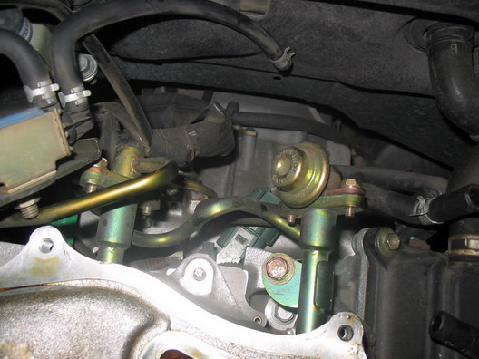

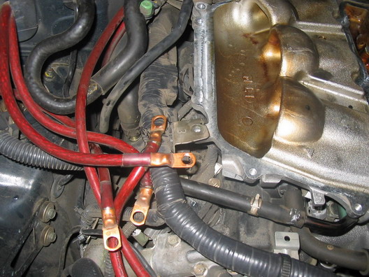

Now let's get the lower plenum off! Wait! The instructions don't say anything about all the other bolts that need removal....
#1)Another pic of the two extra bolts needing removal from the left rear of the lower plenum. #2) The bracket that has the 3 stamped on it needed removal as well.
#3) Showing the three bolts at the front bracket that also needed removal. #4) shows the rear lower plenum bolt removed #5) the front lower plenum bolt removed.
These bolts are in addition to the six bolts within the lower plenum that attach it to the intake manifold.

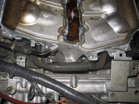

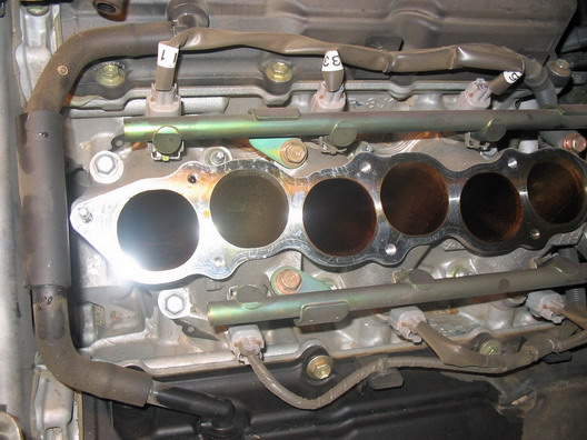

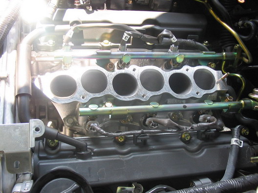

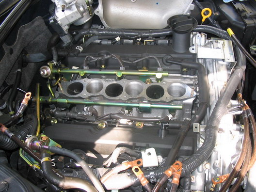

Remove the lower plenum and expose the intake manifold! Pic #1) intake manifold. Notice that the second intake appears to be completely clean while the others are discolored. This worries me! Pic #2) looking downward into the intakes. Pic #3) the lower plenum as it sits on my garage floor. Pic #4) the bottom of the lower plenum that makes contact with the intake manifild gasket. Pic #5) another view of that beautiful intake! Also notice in pic #1 how the right hand side near the oil filler appears to be oiled up. I never spilled oil when I changed my own oil...I bet the Stealership spilled oil all over the engine when they did their oil changes.... Lousy gorillas! I took Mineral Spirits and cleaned it up in pic #5.

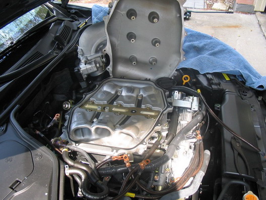

Oil up the Iso Thermal gasket and place it on the manifold. Then reverse the process. Man...my back was aching after all the leaning over the engine.
Pic #1 is my 2003 Sedan getting put togeather. Pic #2 is the 2005 Coupe lower plenum exposed. Pic #3 is the new Coupe again. It is a 2005 with a little more than 4000 miles on her. Quite a bit cleaner than my 69,000 mile 2003 Sedan! Pic #4 &5 are the Coupes intake manifold. Notice how clean the intakes appear.

Why is it necessary to have two people for removal of all the plenum hoses? I haven't looked at mine yet, but I was planning on doing this upgrade this weekend.

Well...... You might be able to do it alone. But I was glad I had someone to hold the upper plenum while the other disconnected the hoses. The two hoses that are relly tough to remove are situated at the bottom of the throttle body, with hose clamps face in a particulary nasty direction. It requires that somebody hold the upper plenum while the other squezes in to remove the hoses. You will need pliers to get the hose clamps off the hose. Good luck if you are planning on doing this yourself. I think you will regret it.
