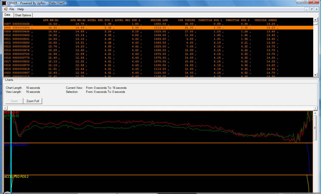

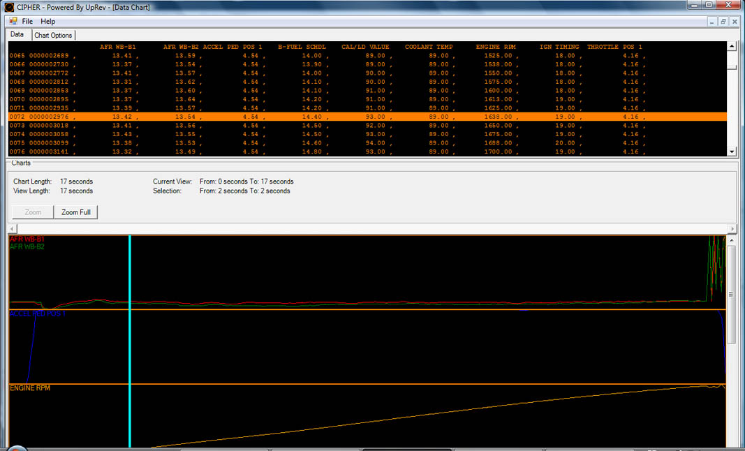

I'm very satisfied with this mod. One more thing. I did some logging before the flash, just so I can compare. Well, you see for yourself at the before and after logs. I don't care how he does it, but the AFR was pretty much a flat line all the way to the rev limiter. After I emailed him the logs, he did some finetuning to it, and it still look flat to me. I guess I'm a believer too. Now, I'd like to get it dyno'd again after the mods.

Thanks. The car before the tune was really rich at the top end. At points it got into the 10s. Keeping it steady around 13.5 all the way to red line has woken up my engine.

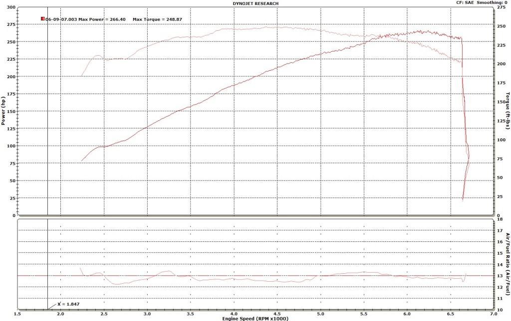

13.0:1 or 13.1:1 is the typical sweetspot for this engine. But of course, each individual engine is different.
For example, here is my latest dyno pull. That was in >95 degree weather, so the SAE correction factor was 1.06. That means that even after the tune, the factory ecu was dumping fuel to cool the combution chamber. And also keep in mind that that was a tailpipe sniffer. When Sharif tuned my car on his Dyno Dynamics, he used a wideband and got the tune to an almost perfect 13.1:1 all the way till redline.
