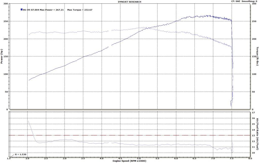

I gotta say it's a good bit more than that. He picked up ~20rwhp from a tune, which IMO is pretty believable. I didn't pick up that much, but my car isn't an HR, and I was tuned with a utec. I *assume* that technosquare can get a little more out of it than the utec for the DE. Also, I don't know if you remember, but Cheryl's car bone stock ran pig stinking rich. I would post a link to the dyno plots, but its late, and g35driver has decided that it doesn't want to accept any more requests. I just hope it doesn't lose this reply.Originally Posted by DaveB
There is nothing "fake" about the numbers, but the everyone seems to be forgetting that every dyno reads differently. Also, this isn't the first time I've seen crazy high numbers from TS dyno. IMO, the real test is to see what this car does at a good track like Sacramento. I would say it is very likely this car will run like most any other NA modded HR 350Z, 13.1-13.3@103-105mph. I would venture to say that this car would put down more like 270-275whp on a Dynojet. For whatever reason, NO ONE in LA seems to use Dynojets
There are certainly HR 350Zs running 12.9-13.1s with next to nothing in mods, but one needs to look at the tires and tranny. If you take a stock HR 350Z 6MT with 26" slicks and launch it at 6000rpms, it going to yank a mid 1.7 to low 1.8 60'. That's a given. If the halfshaft doesn't snap, the car is going to run a 12.9-13.0 on a decent track and maybe even a 12.8 on a quick track. Most of the HR 350Zs running stellar times have drag tires, are 6MTs, and they're run at quick tracks. They're certainly not the "norm".
As for weight of the HR 350Z. IT DOES NOT weigh significantly more than the DE-equipped cars. Everyone seems to have this idea that the 350Z and G35s gained weight as the years progressed. The truth is you can't really go by the quoted Nissan numbers. HR 350Z owners have weighed their cars and they're in the 3180-3250lb range.
** Edit -
Here's the post I was talking about: https://g35driver.com/forums/tuner-d...hr-videos.html
And here's the dyno(notice how rich it is):
