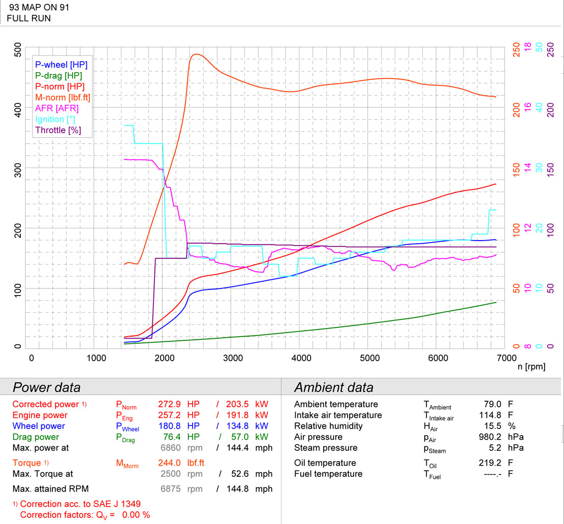

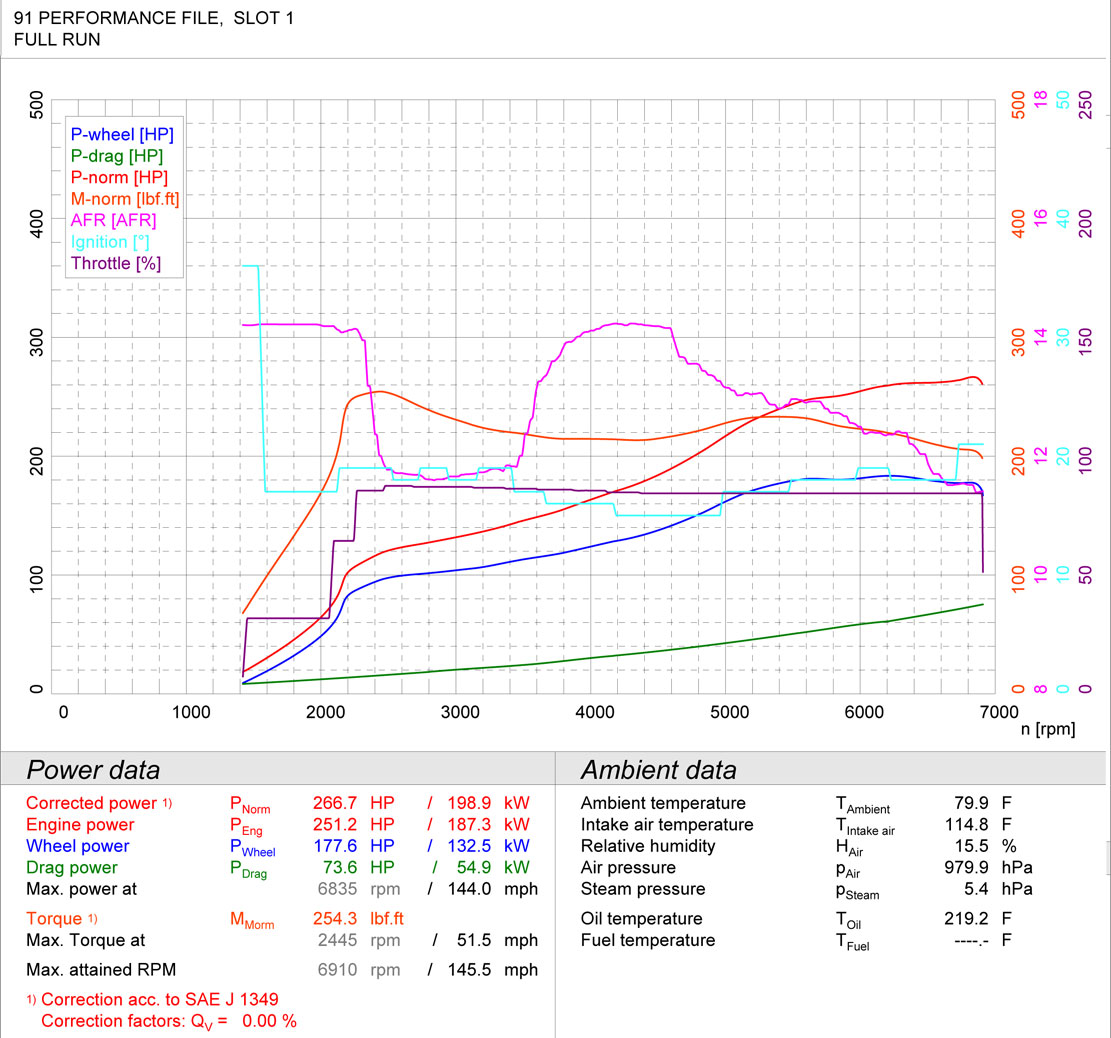

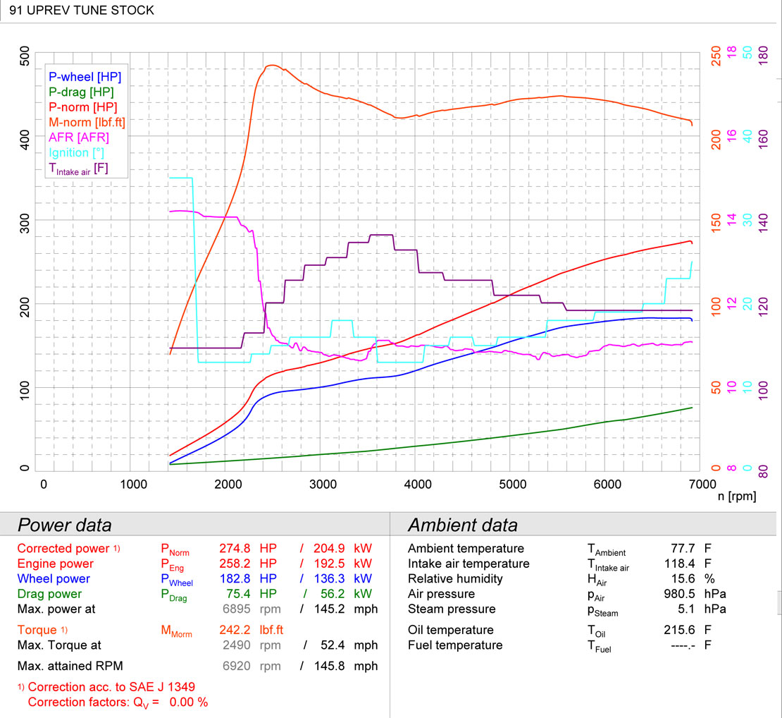

So I had a couple of dyno runs after I got my osiris reflash. I got the base maps "for my mods" I did not do a custom tune yet. This was done about 30 minutes after the reflash so the car hadn't had time to "learn" the new settings. I guess as I drive it more it gets closer to its new targets. Also I forgot to remove the +2 timing prior to the reflash which osiris recommends.
Car is an 05 5AT coupe power mods are:
HKS Hi-power TI exhaust
JWT Popcharger
Z-tube
Motordyne 5/16 spacer
Osiris Basic $400 reflash
Grounding Gear 10 wire kit(some people say it helps power others dont so I just listed it anyway)
91 octane pump gas.
Dyno's were done by goodspeed performance in az on a german MAHA LPS-3000 dyno which is able to calculate drivetrain losses, its a pretty fancy piece of machinery.
For the numbers show the only corrected value is the corrected value and torque numbers, everything else is not corrected.
I had him do other stuff like graph intake temp etc (i need to put the heat shield back on the popcharger....)
Charts are labeled at the top
Feel free to pick it all apart and give any comments, critique, whatever.
Attached Thumbnails My dyno runs-g35-1.jpg   My dyno runs-g35-2.jpg   My dyno runs-g35-3.jpg   My dyno runs-g35-4.jpg

your A/F ratio is too rich on the first three graphs and is all over the place on the fourth. Have you had a re-tune through Uprev yet or is this the initial tune based off your mod list?
Not yet this was just the initial reflash based off the mod list.

send this info back to the guys at Uprev and they will get you a new tune.
