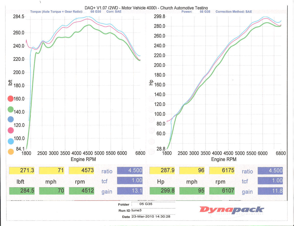

Most bolt-ons + RevUp Osiris tune @ Church Automotive 299.8 hp and 284.5 lb*ft
Was excited at my results and just wanted to post them up. My previous dynos from exhaust and up were done on a dynojet, so I unfortunately do not have direct comparisons to make.
My last dynojet numbers were under the following conditions:
400 miles on new motor
KN filter, plenum spacer, port-matched non-RevUp lower collectors and manifold, JWT flywheel, HKS exhaust
These dynapack numbers were under the folllowing conditions:
4000 miles on new motor
Same mods above + Berk Tech HFCs
These formed the baseline. There was no tuning done prior to today.

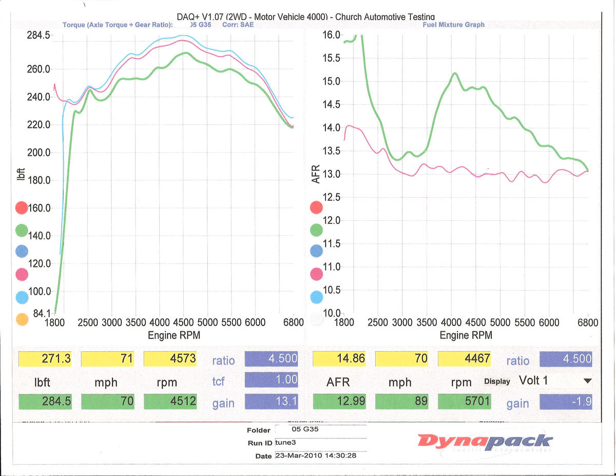

Green bands show baseline, Pink shows heatsoaked (tuned), Blue shows run after a ten minute cooling period (tuned)
I probably have an exhaust leak so it looks leaner than it actually is. Would have rather they used a wideband instead of sniffer, but oh well.
Original dyno runs: Linky
Attached Thumbnails Most bolt-ons + RevUp Osiris tune @ Church Automotive 299.8 hp and 284.5 lb*ft-torque-vs-afr-small-.jpg   Most bolt-ons + RevUp Osiris tune @ Church Automotive 299.8 hp and 284.5 lb*ft-torque-vs-hp-small-.jpg

I made just slightly lower.
Do you think your port matched manifolds made a difference? I always wanted to do it to avoid getting headers and avoid smog issues.
How is the JWT flywheel? I got my V2 replacement approved at Riverside and wondering if I should get the clutch and flywheel replaced at the same time.
How does the new motor compare to the old one?

New motor = fantastic. I did the super hard break in during the first 20 miles as detailed on http://www.mototuneusa.com/break_in_secrets.htm. Whether its better or not who knows, but it worked for me.
When they do the flywheel install, ensure they follow the directions to torque, unscrew, add loctite and retorque as detailed on the one random sheet of instructions that comes with the JWT flywheel. My crankshaft bolts got stripped because the tech I took it to at Tustin Infiniti just impact wrenched them on and ignored the instructions. I also recommend you buy new crankshaft bolts before they start. It gets loooudd when its hot. Barely noticeable compared to stock when its at moderate or cold temps.
Port matching was recommended by a friend and he and I both got solid gains, but i'm sure its just a reproduction of what the MREV2 is, just taken a step further because it includes grinding the intake manifold as well.

I was really tempted to go buy a block of ice to put on the plenum... but then I figure I'm probably -10 hp anyways vs a DynoJet so I'll save the ice for when I'm around 309.8.

Yup, well aware about the Dynapack. Taking the weight of both the rim and the tire and using the calculations given on their website for the difference in torque readings at the hub vs at the tire like a DynoJet, it shows that at 7000 rpm, there is about an 8.40 hp difference between a Dynapack and a Dynojet. Conservatively we can just state there is about a 10 hp diff. On the extreme end, there has been said there is a 7% diff, so 278.8 hp. Pick that or 288.8. Either number is good enough for me and my mods =).
