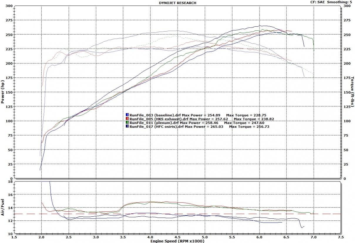

Originally Posted by 03threefiftyz
About what I expected......good reference for all the people who get tuned at Churches......was the dynojet SAE or STD?
all SAE
updated dyno chart

I'm guessing you have a revup?
Most stock revups on Church's dynapack yield about 260-265 whp. So, you're looking at a gain of about 35 hp +/- 5hp.
What is your complete mod list?
Do you have a stock vs final numbers on the same dyno? That last dyno you posted doesn't state if the baseline is stock or not.
Good gains either way.
Old May 18, 2010 | 07:31 PM
  #24
whiteg35c2's Avatar
Joined: Apr 2005
Posts: 95
From: San Diego, CA
yes, the baseline is from an almost stock rev-up on the same dyno (K&N filter is the only "mod").
Complete mod list (dyno/chronological order):
(Run 3) K&N Drop-in filter (included in baseline)
(Run 5) HKS exhaust
(Run 11) Machined intake manifold and lower plenum, 5/16" Spacer
(Run 17) Berk HFCs, Osiris tune
