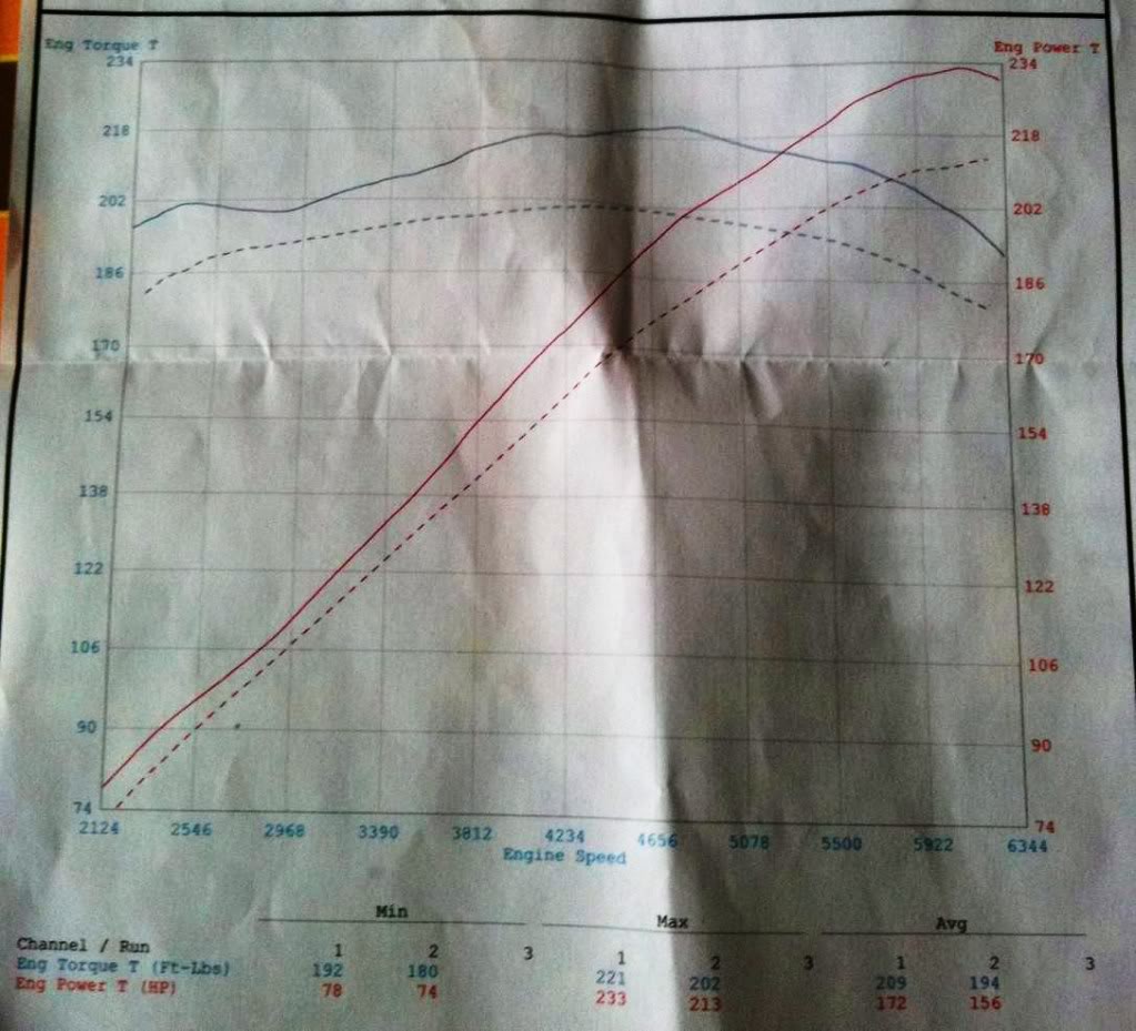

I just had my 04 G35 6MT Osiris Tuned and the results seem kinda low to me...
I had it tuned at Secret Services Auto in Houston, TX which is a pro-tuner.
My mods are: JWT Pop Charger, MD 1/2' Plenum Spacer MD ART test pipes, and Stillen Dual Catback Exhaust...
I have posted my Dyno sheet but if its not very clear the numbers are as follows:
Pre Tune Run: Max TQ: 202 Avg TQ: 194
Max HP: 213 Avg HP: 156
Post Tune : Max TQ: 221 Avg TQ: 209
Max HP: 233 Avg HP: 172
Max TQ inc: +19 Avg TQ inc: +15
Max HP inc: +20 Avg HP inc: +16
My A/F ratio isn't posted on the dyno but it was about 13.0 throughout with a dip into high 12's in the upper rpm range...
Are these number consistent with my mods and car? I have the DE engine non rev-up...
I was thinking my pretune number would be higher as well as post tune....
They said stock G's put about 215 to the wheels on their dyno but mine put down 213 with all mods pre tune...
Anyways let me know what you guys think... I appreciate the feedback...

Thats a really good increase and just remember diff dynos are going to read high and low.It is the gains that are made and you got some good gains and if you dont believe it get it on a another dyno to verify it.Also what kind of dyno was it.

It says Mustang Dynamometer on the sheet... so you think the gains and number are consistent with my mods etc.?

Mid-upper teens in gains both avg and peak, is pretty solid for an N/A tune IMO. I think the mustang reads lowers so don't let that fools you. Just look at the benchmark gains that you have made, that's money well spent. It's probably going to put down 260s ballpark on the dynojet if it'll make you feel better about your numbers. But it's hard to guess as dyno will read differently base on their calibration and type.

Mustang DYnos are heart breakers for sure...

If it was a twin roller Mustang Dyno, then yes, the #'s will be low. Make sure the correction factor is set at 1.04 and they pulled it in 5th gear. Nevertheless, the gains are what's important and they are good considering your mods.

Yeah it was a twin roller mustang and yeah I was considering doing a CAI... I might just quit it at a CAI...
they pulled in 4th... I don't know why...
would I need a retune if I change to a true CAI? and will it tune different in 4th vs. 5th?

first you gained a lot 20/19 and avg 16/15 is pretty awesome. i gained max 13/13 and avg 9/11 so you really did well.
second dynos are all different. and while mustang dynos are heart breakers you shouldn't worry yourself with the final numbers. whats important is the gain and the area under the curve. i would like to see what other cars put down on the same dyno. any other Gs or Zs get dynoed the day you did too? thats really the only way to know if your G really is weaker than others.
your car didnt get slower. and most likely if you hadn't known the dyno numbers you would be happy with the gain and probably could tell the car runs much better then before. the only thing that should matter is if you take it to the track.

It doesn't matter if they tuned it in 4th or 5th. We tune in 4th just so the pulls are shorter and the engine stays cool. After we are satisfied with the tune, we wait 30 minutes for the last two pulls (in 5th) because everything is heat soaked from tuning.

Good gains... no problem in my opinion.
FYI mustang is a brake loaded dyno so it cannot be compared to other dynos not even other mustangs....there will always be variations. Only an intertial dyno (dynojet, ect) can really be compared to other dynos given the same corrections mode.
