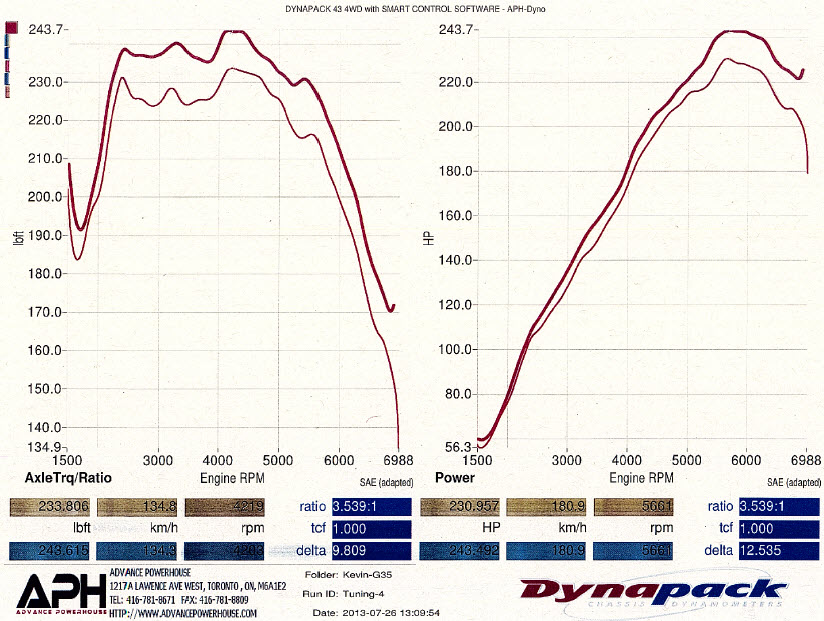

Base dyno with these mods was 230hp. After the tune I gained 13hp & 10tq (Note: One of the dyno pulls showed 244hp, hence why I'm rounding up to a 13hp gain). Is a 230hp base with these mods "normal" and is a 13hp gain with a dyno tune "good"?
Other than my results being OK, I'm also disappointed that when I inquired about an economy map and adjusting the throttle body (for better/smoother throttle response) my local tuner was not familiar with this and no adjustments were made. He was a great guy and did seem like a very experienced dyno tuner with many different vehicles, including some previous G tunes that were on his computer. However after probably 2+ hrs and ~15 pulls I seem a bit disappointed with these results... should I be?

If you're running all intake bolt ons and stock exhaust I could understand low-ish baseline but 230 is still in the lower than normal side especially at your altitude.
