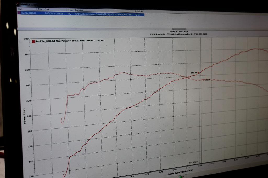

My Osiris ECU Tune...
07 G35S Sedan 5 AT
Full Exhaust, HFCs, CAI, and this ECU tune.
Video link is here >>>
280 HP and 250 Torque.

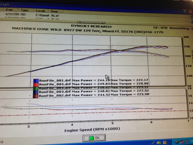

Finally I flashed my car with the Osiris tuned this weekend.
My current mods installed before it was flashed (2004 6MT), it did 244whp:
Injen CAI, Motordyne 5/16, ART Pipes, Motordyne TDX2 Full 3" True dual version
Same mods with the Osiris flash, 250whp
It gained 6whp after the flash. Are this the normal gains, or do you guys think I can get some more out of it?
After researching here on driver I see almost everyone gains well over 10whp.
BTW check engine light came back on again, =( I though it would be gone after the flash.
Thanks for your input.

It gained 6whp after the flash. Are this the normal gains, or do you guys think I can get some more out of it? .
Absolutely no way to tell without seeing the Dyno sheet, gains under the curve are more important than just peak HP
Talk to the tuner, he should be able to take care of that easily

I did the flash myself with the tune from Uprev, spoke to them today and they told me that I had gotten the basic tuned map, and to email them the datalogs for a more specific tune. I will try to datalog the car tomorrow.
Here are the dyno sheets I will definitely appreciate the input
Attached Thumbnails Osiris Tuned: Dyno Sheets FTW!-dyno2.jpg

Then you're just running on the base tune.. You need to dial it in now with the datalogs

Cool hopefully the gains will be better, I will definitely get them those logs asap

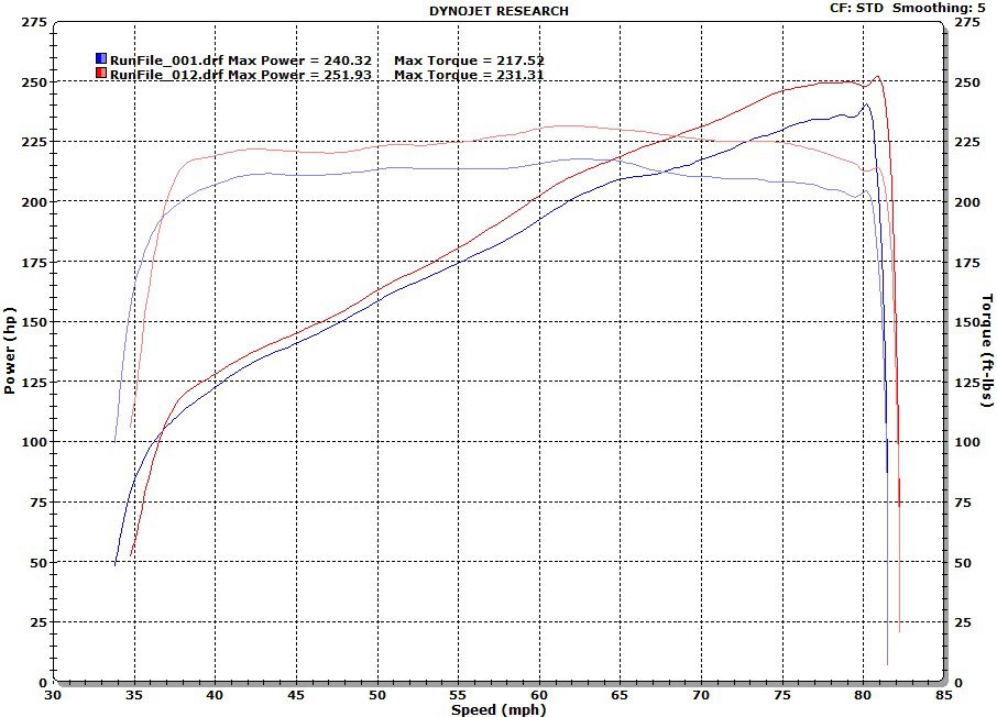

You should pick up around 10-15 whp with a proper tune. The attached dyno is pretty typical for a non revup 6MT with spacer and exhaust (I tuned it FYI)
Attached Thumbnails Osiris Tuned: Dyno Sheets FTW!-joe-dyno.jpg

Awesome man those are the gains I been seeing on the forums more or less with the Osiris, I sent them the datalogs today, let see how it does when it come back.
Just to know If I sent you my ROM and datalogs could you optimize it?
