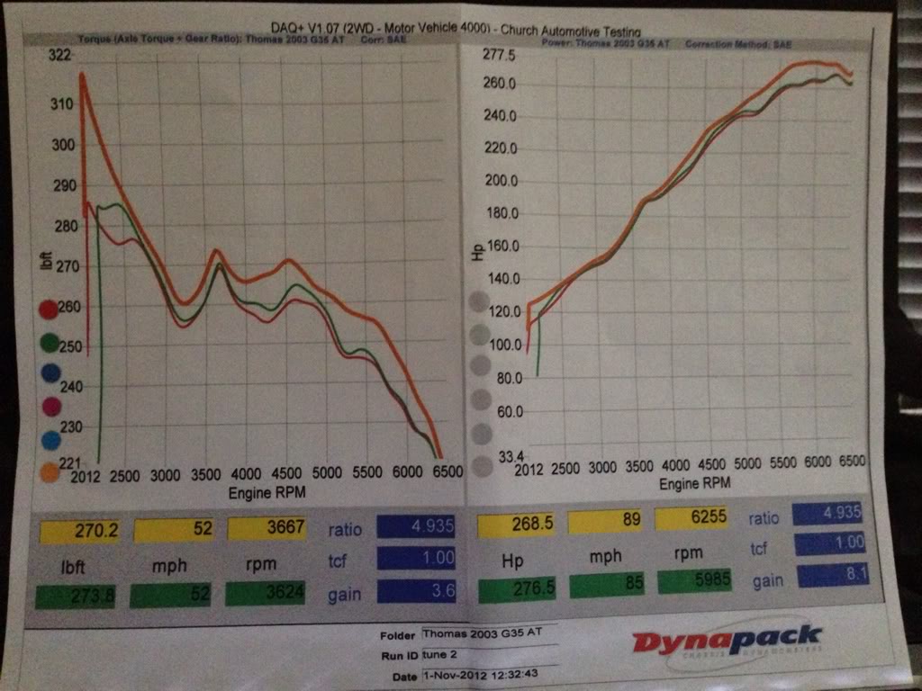

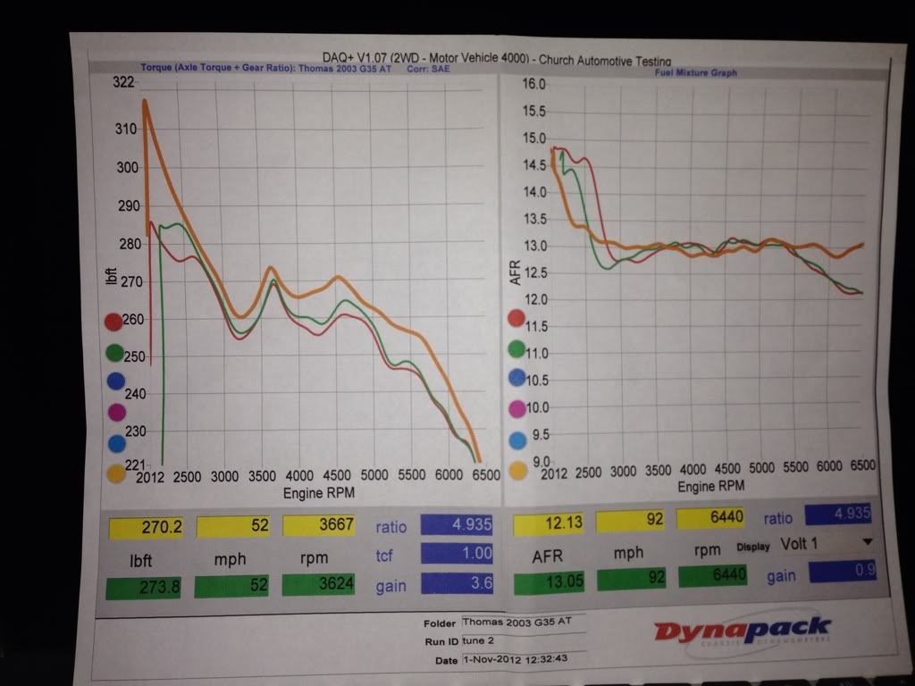

Well here they are the dyno sheets I got from Church's today. Car is an 03 coupe 5AT with 109,xxx miles on her. The mods were:
K&N drop in
06 REV-UP air box
Z-tube
5/16 MD iso thermal spacer
SxCxEx Grounding kit
MD ART pipes V2
MD XYZ pipe W/resonator
Stock mid pipe
Stock Exhaust
Stock drive shaft
Tune done by Todd @ Church's

That graph looks wack....

Please enlighten me...what looks wack? the tq numbers?

Maybe its the kind of dyno you were on, but I've never seen TQ peak at 2000rpm and fall consistently throughout the RPM range.

Does that due to the tq converter if the pull is started down low like that. Nice numbers I was tuned by Shawn when I used to live in Socal.

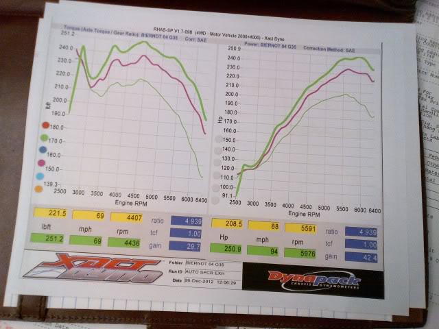

Just got tuned by Tim at SRD in Tempe, nice guy. I'm pretty happy with the gains. He said the timing was messed up in the base map , it pinged like crazy on the first couple of pulls.
04 Sedan AT
3/8" CZP Spacer
3" Silicone Intake Tube
Revup Airbox
K&N Drop in
HR Y pipe
350z mid pipe

Nice numbers, you still have stock cats?

Thanks. Cats are stock, I'm thinking Fast Intentions or ART Pipes but I want it to stay quite. Tuner said a muffler change would stop the power from dipping at 6K but I don't want it to be loud, I like it the way it is. I think I'm done with the engine stuff for now, it's time for gears and suspension, then brakes and wheels.

Ya really, not yet. He said the timing map on my tune was wack, so he downloaded the AC011 ROM and it was the same. We had to copy and paste the map from the 012 ROM, car instantly went from 208hp to 230hp and stop detonating.

They might have a bad timing table in the base rom then, I'd have him shoot them an email so they can look into it.
