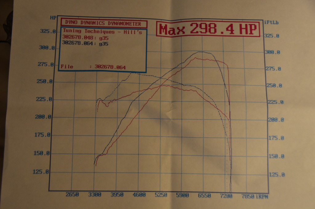

Here is my latest tune at Hill's Garage on my 04 5AT
Mods
DMK intake
3in Samco intake tube
Stillen intake (may go back to rev-up box was recommended by Hills)
JWT S1 cams w/ DLC cam buckets
PPE 1 3/4 Longtube Headers
Custom 2.5 exhaust w/IPL muffler
Transgo
3.7 FD
Z1 Aluminum Driveshaft
Edge Racing Modified stock torque converter

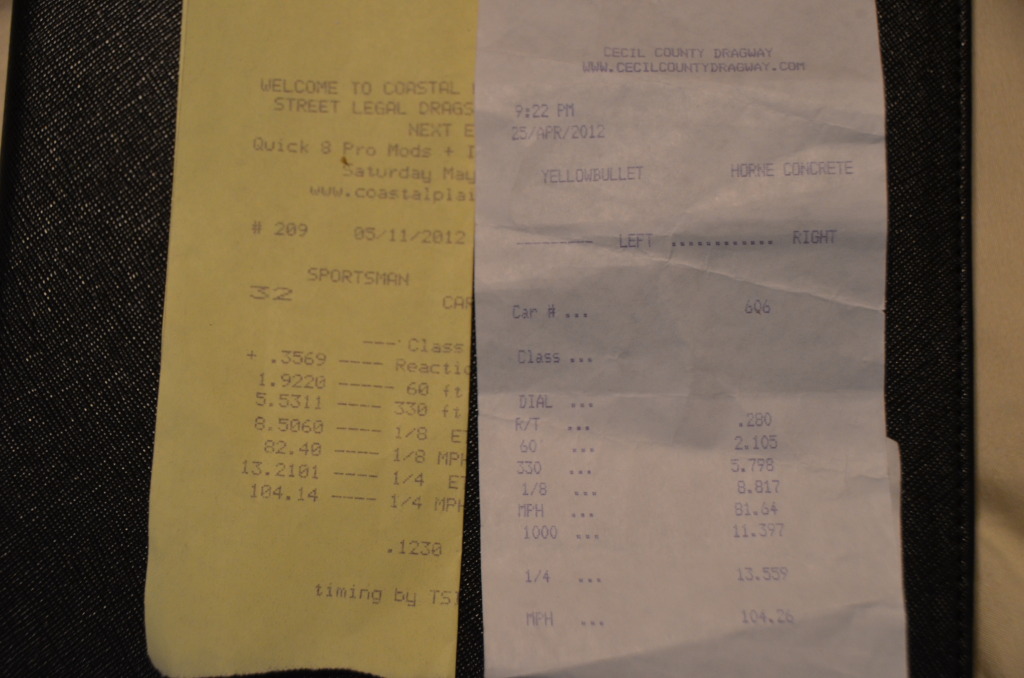

Best time from friday night after adding my driveshaft compared to before.
I know this time is a little slower than my best, but I ran my best with 250hp in -1000 DA 40* outside big difference. I ran the times below above sea level around 60-65* outside.
The only thing taken out was the spare and sub.

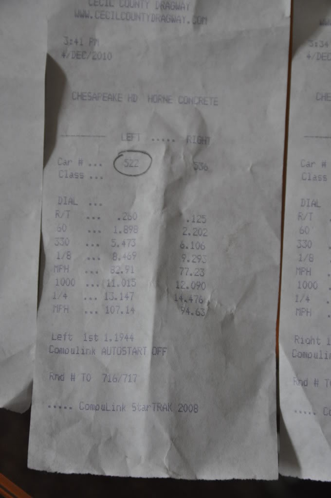

Compared to my best in 40 degree winter weather 2 yrs ago this run and the above runs were on street tires

I'm done now N/A I'm happy to be close to 300hp in a 5AT. I may go Vortech in the fall I miss boost.

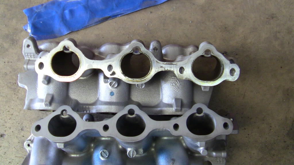

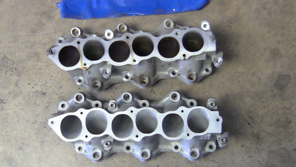

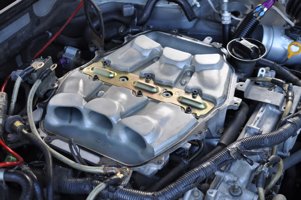

Originally Posted by JaE35
Any more details on the DMK intake? Pictures? More details on the torque converter? lol how much was that?
rpm06g35 makes these DM2 intake
https://g35driver.com/forums/intake-...-manifold.html
comparing my stock intake to the DM2
