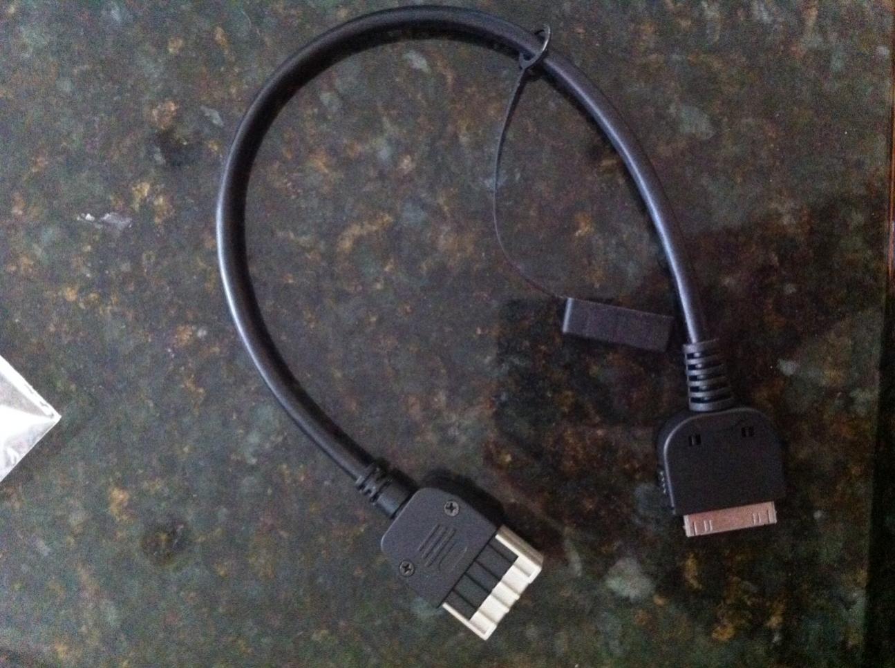

You'll probably get a good answer if you include some more details or pictures about the cable you purchased. Is it a single cable or one that extends the existing Infiniti cable. What's the model number, is there a link on ebay you can share.

It's a single cable, it is just the OEM cable that should work with all infiniti's that have have the input for it. I do not have an ebay link or model # though.
Attached Thumbnails 08 G35xs does not recognize my Iphone 4S, could I be using the wrong cable?-photo-1-.jpg

From my understanding and research, the iPod docking system that your 2008 contains only supports up to a certain generation of the iPhone.
I believe the highest generation supported with the navigability of the iDevice, audio transmission, and charging is only supported on 3GS and older models. Meaning that any newer iPhone/iDevice connected via any OEM/non-OEM iPod cables will not be compatible with your vehicle.

I saw your post, but I would really prefer a non-wireless solution to my problem. My Iphone's battery is sub-par and I would like to have it charging while playing music, instead of it losing power. Since you said it works for 3GS and below, I tried my old Ipod touch (which I assume is a 3rd generation) and it also didn't work. So I think it might be safe to say that it is the cable's fault, and that I should just try another one that is actually 100% designated for my car.
