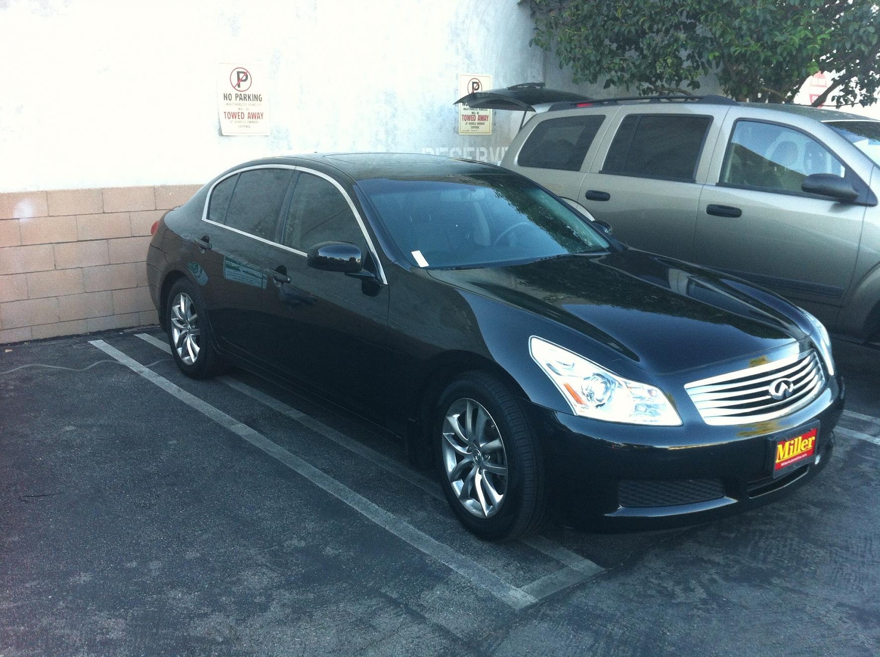

I just purchased my G35 it has nav/satellite, cd changer, and a iPod integration adapter in the center console. I am trying to use my apple iPod classic 120GB (7th generation) MY PROBLEM: I purchased the iPod cable from someone on eBay, when I plug the cable in to the adapter socket and plug in my iPod under AUX the screen says No iPod connected. I even tried plugging in my iPhone 4 and still nothing.
DOES ANYONE ELSE HAVE THIS ISSUE?
CAN ANYONE HELP?
