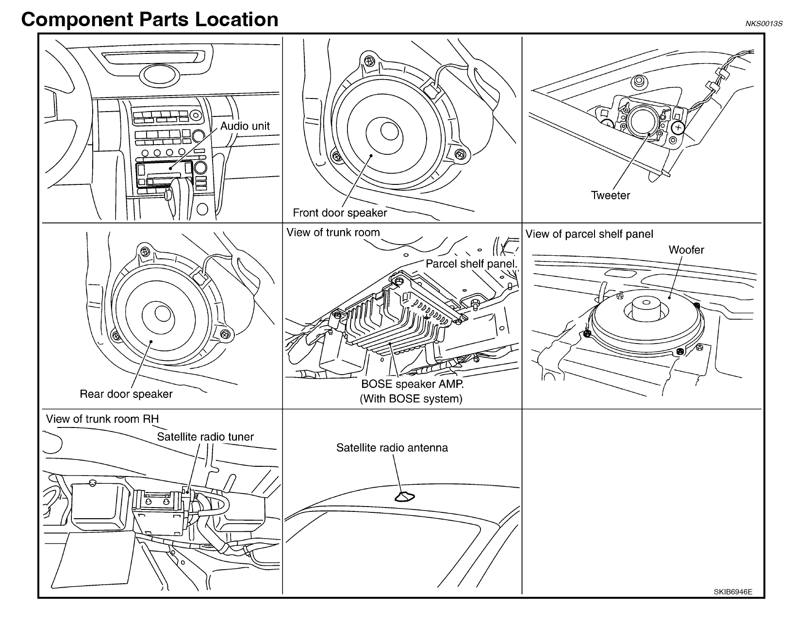

Old Aug 8, 2022 | 09:23 PM
Junior2123's Avatar
Joined: Aug 2022
Posts: 2
G35
Hey i want to replace my amp in g35, but im having problems locating it in the trunk wiuld you be able to help?
Old Aug 9, 2022 | 11:37 AM
G2B35AGN's Avatar
Joined: Mar 2013
Posts: 1,991
Likes: 390
From: Raleigh, NC
Which G35 do you have? Sedan or coupe? Year? Need more info to help you.
Old Aug 9, 2022 | 11:56 AM
Junior2123's Avatar
Joined: Aug 2022
Posts: 2
G35
Its a 2004 g35 sedan
Old Aug 11, 2022 | 10:47 AM
G2B35AGN's Avatar
Joined: Mar 2013
Posts: 1,991
Likes: 390
From: Raleigh, NC
In my 2006 sedanX (RIP) with Bose, it was on the underside of the parcel shelf. Don't know if it is the same on the 2004. Here's a screenshot from the 2006 FSM.
Attached Thumbnails Removing the Factory CD Changer in the trunk-screen-shot-2022-08-11-10.45.25-am.png
