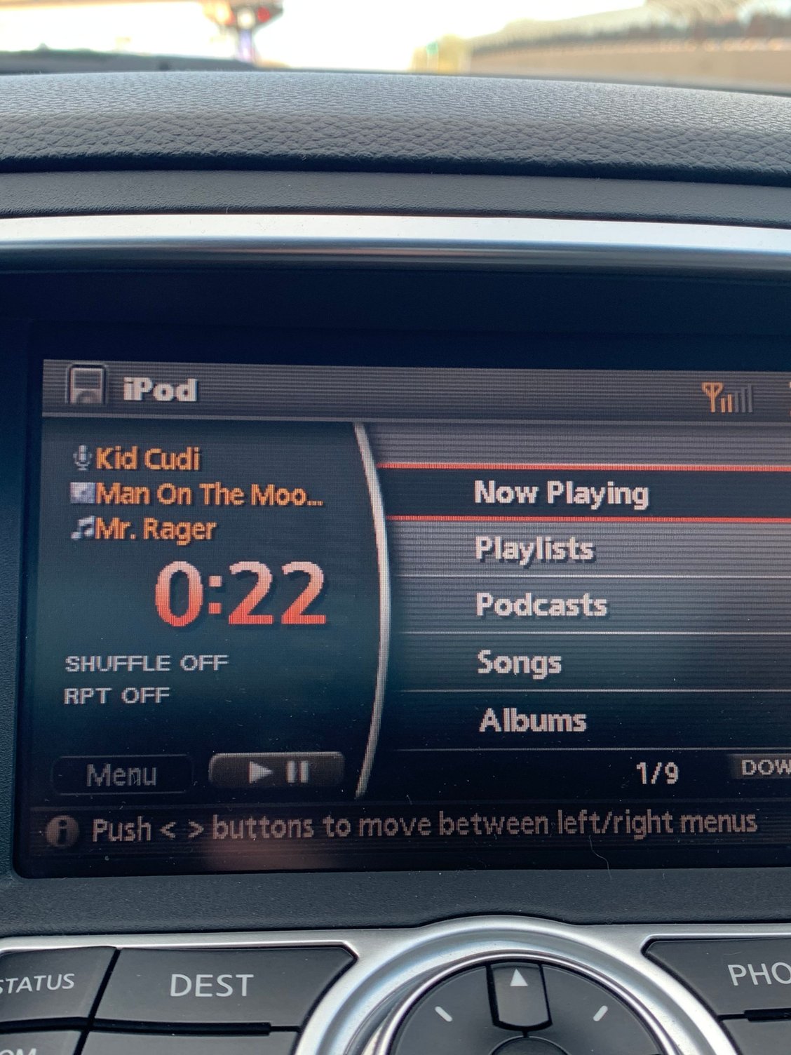

So I wanted to make a follow up with my experience and setup for playing music wireless. Stevenson suggested this and thank you, it worked great! I know for me this was probably the biggest downside with the car, I loved everything else but for a car that had so many other options and gadgets it was a bit disappointing not having this.
I have a 2008 G35X S, it has premium/tech package with Bose and navigation in case that helps. Phone I am using to play music on is IPhone X.
With this setup all steering wheel features to adjust volume and change song work, as well as artist and title displayed on screen. Also when a call comes in you can answer as normal, music will pause and when the call is ended music comes back on.
All said and done the total cost was $110 for everything needed, you could probably find some cheaper options-for example the main bluetooth device was $70, the same company offers one that I believe was about $20, but I didn't want to cheap out on the most important part so I went with this option. The bluetooth device apparently is formatted for different makes such as Mercedes, Audi, VW, etc.. The option for our Infiniti would be the BMW/Mini option.
When I purchased my car it had a plug in in the center console that was the old school Ipod (30 Pin) plug out, not sure if this is standard or if you will need this also, I did see them for about $10 in case you need that piece as well. From the 30 pin plug in you will need the adapter that will give the bluetooth device enough juice to power on, there is a micro usb port on this piece that you run from the cigarette lighter port. I purchased a dual usb so I could charge my phone as well (worked like a charm). Once you have the adapter on the 30 pin and the micro usb plugged into this you add the carpro bluetooth device to the end of the adapter and you should have power signified by a blue light. From there you will open your bluetooth settings and connect, it will ask for a pin # which should be 0000. That is all there is to it. Pictures are below, it is a bit of a bummer using almost the entire center console to house this, but I'm sure I could clean it up a little to get some more usable space.
EDIT: Blue chord coming out is a lighting cable to charge phone.
