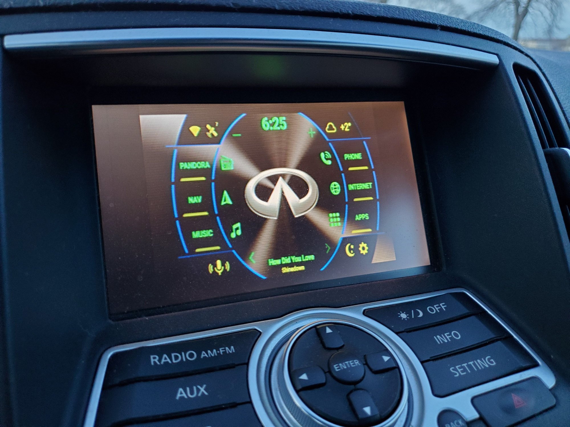

Ok, got my setup together. I'm using a Galaxy S8, a QGeem Type-C to HDMI converter/hub from Amazon and an HDMI to RCA converter from the local electronics store. It's not a perfect setup, as I'm currently using a mini USB mouse to control it, but it does allow me to run the Car Launcher Agama App as a home screen as well as run Pandora for music and Google Maps for navigation. For network access I run my S10e as a wireless hotspot. I tried it out running Dex (Samsung's desktop interface) but couldn't adjust the display size to make it practical, so I just run it using Screen mirroring. Next step is to tear into the console to figure out a better way to fit everything in so that it's not a huge jumbled mess.
I tried a similar setup: RCA->HDMI->USB-C Hub to Samsung Note8 via screen mirroring. Although I may be able to live with a low res image due to the RCA video out, I not prepare to take out the stereo to fix the "parking brake" requirement just yet. Only wish there was a direct drop-in screen replacement with HDMI/USB-C connector. I previously installed a Pioneer avh-w4400nex in my Sonata and really enjoyed the wireless Android Auto. I also installed a Pumpkin Android HU in my MX-5 but prefer the Pioneer experience. Although, at 1/2 the cost, it's serviceable.
