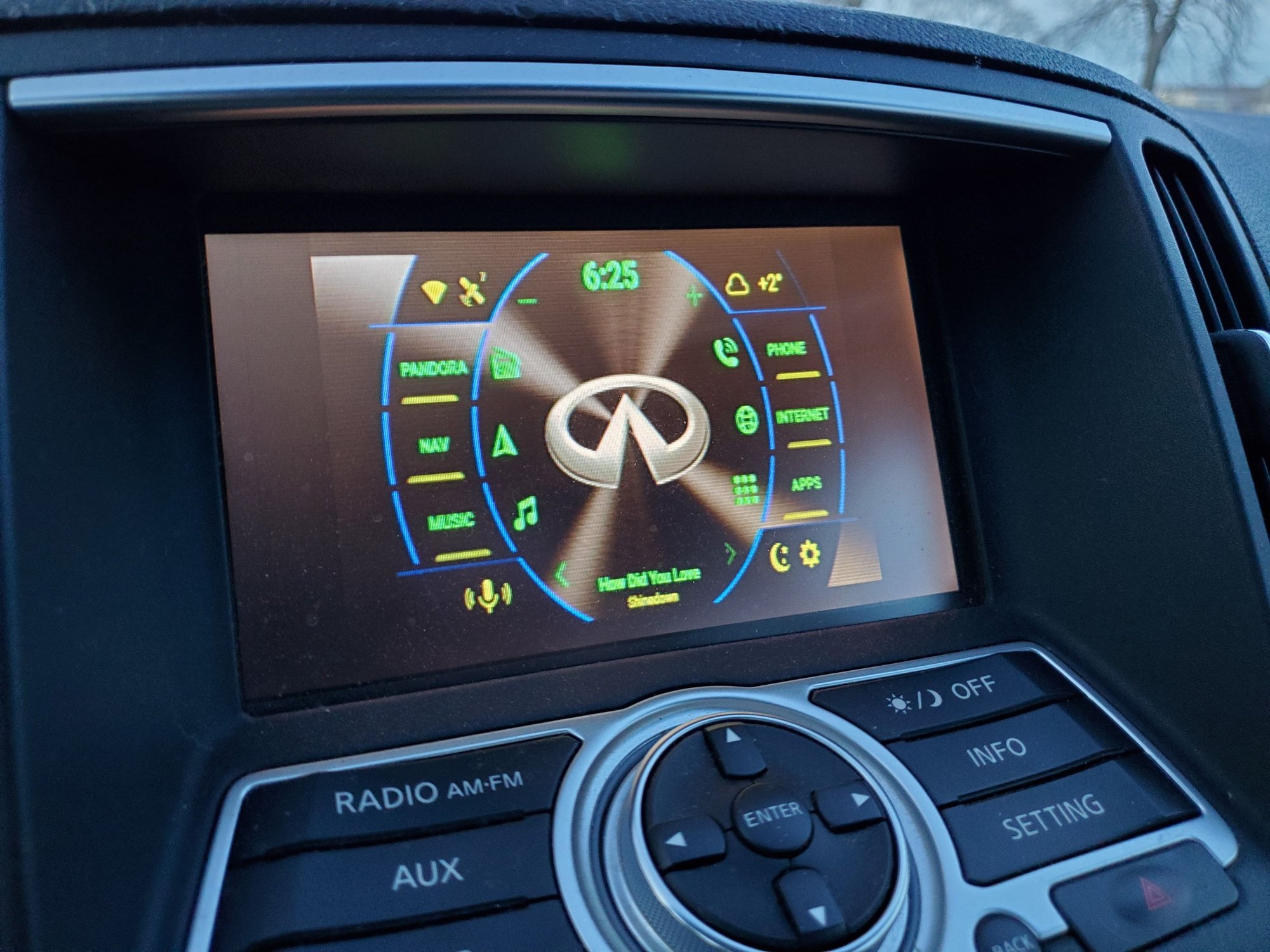

I'm using a QGeeM USB Type-C to HDMI adapter (from Amazon) and a WavLink HDMI to RCA adapter from the local electronics store with my Galaxy S8. Works decently well, I run the App that 909 runs on his tablet, it's called Car Launcher Agama. it allows me to run Pandora in the background and keep the "Home Screen". Only downside is I currently use a small USB mouse to control it, I need to figure out some sort of touchpad to use.
