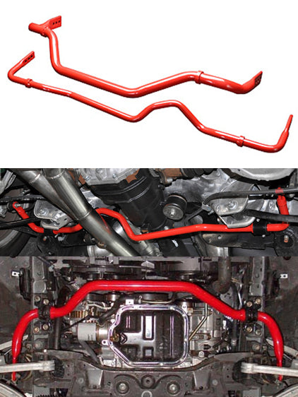

2006 V35 G35X AWD Front sway bar differences
Originally Posted by bat6wc
so you have a NON AWD front sway with you? If so, can you please confirm once and for all, that the FRONT sways are different (that a hotchkis kit will not fit the front and its not bc they havent tested it)?
Yes, they are absolutely different. The AWD has the oil filter pointing to the front of the vehicle. The V35 350Z/G35 RWD bars have a big 5"deep hump about 2' across to accommodate the front of their engine as in the pictures below.
2003-2009 Nissan 350Z [Z33
The OEM V35 AWD front bar only has about 1.5" of offset between frame mounts because the frame mounts are lower on the chassis (Z-axis). If you try to install a V35 350Z/G35 RWD front bar on an AWD car, the angled 5" offset rubs on cooler lines to the radiator as well as physically interferes with the VQ35 front-facing oil filter. Websites will say the two bars are interchangeable. Not true.
