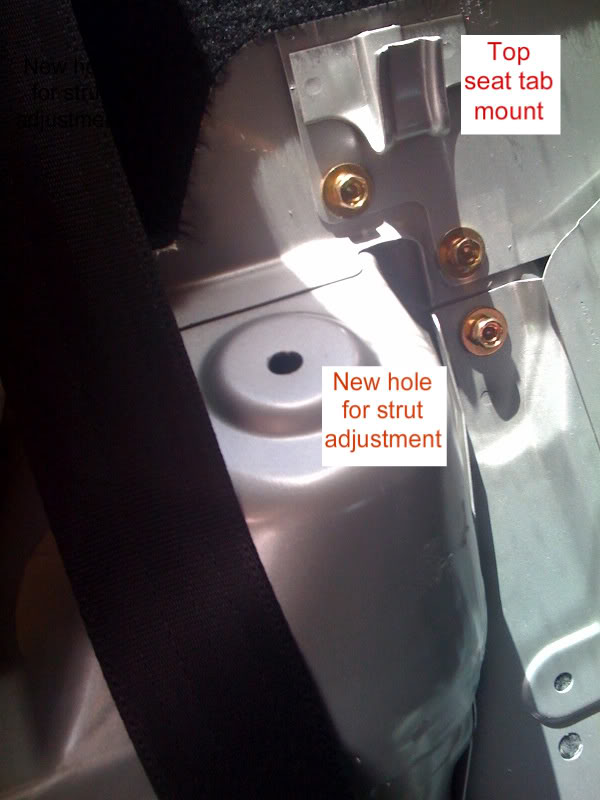

hey mike did you resolve your problem with the rear coils. I asked my installer and he said that he removed the lining in the trunk then drilled the hole downward.

Not yet but Adrian just posted a tip here. It makes a bit more sense than going through the trunk. I wonder where your installer drilled down to? You wouldn't happen to have a pic of where the hole is in your trunk, would you? That would certainly be appreciated if you did

The front, yes. For the rears, unless you find a way to route those extenders to the trunk or inside the cabin, the struts will have to come off for adjustment.
Remember, soft is "30" clicks, hard is "0" (counter-clockwise movement). BC recommends resetting to 0 and clicking up to soft from full-hard when making adjustments.
You're going to have to make a hole like that.
