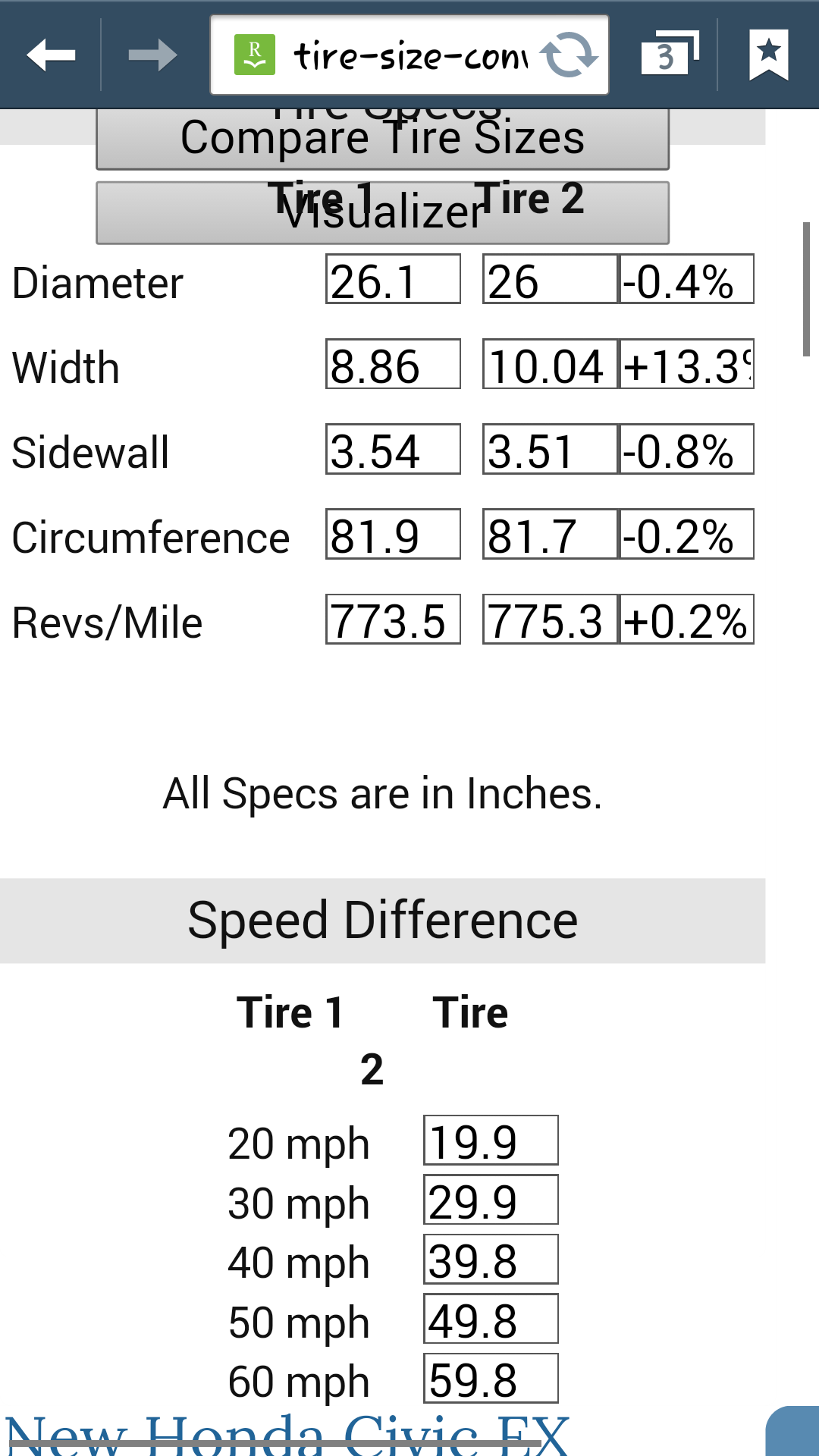

Originally Posted by akira824;5815803
[IMG
https://cimg9.ibsrv.net/gimg/g35driver.com-vbulletin/1080x1920/80-screenshot_2015_05_26_12_54_54_a3967808b05d447dd15 ee4cddb86c3ec702e942e.png[/IMG]
]yes and i had no problems

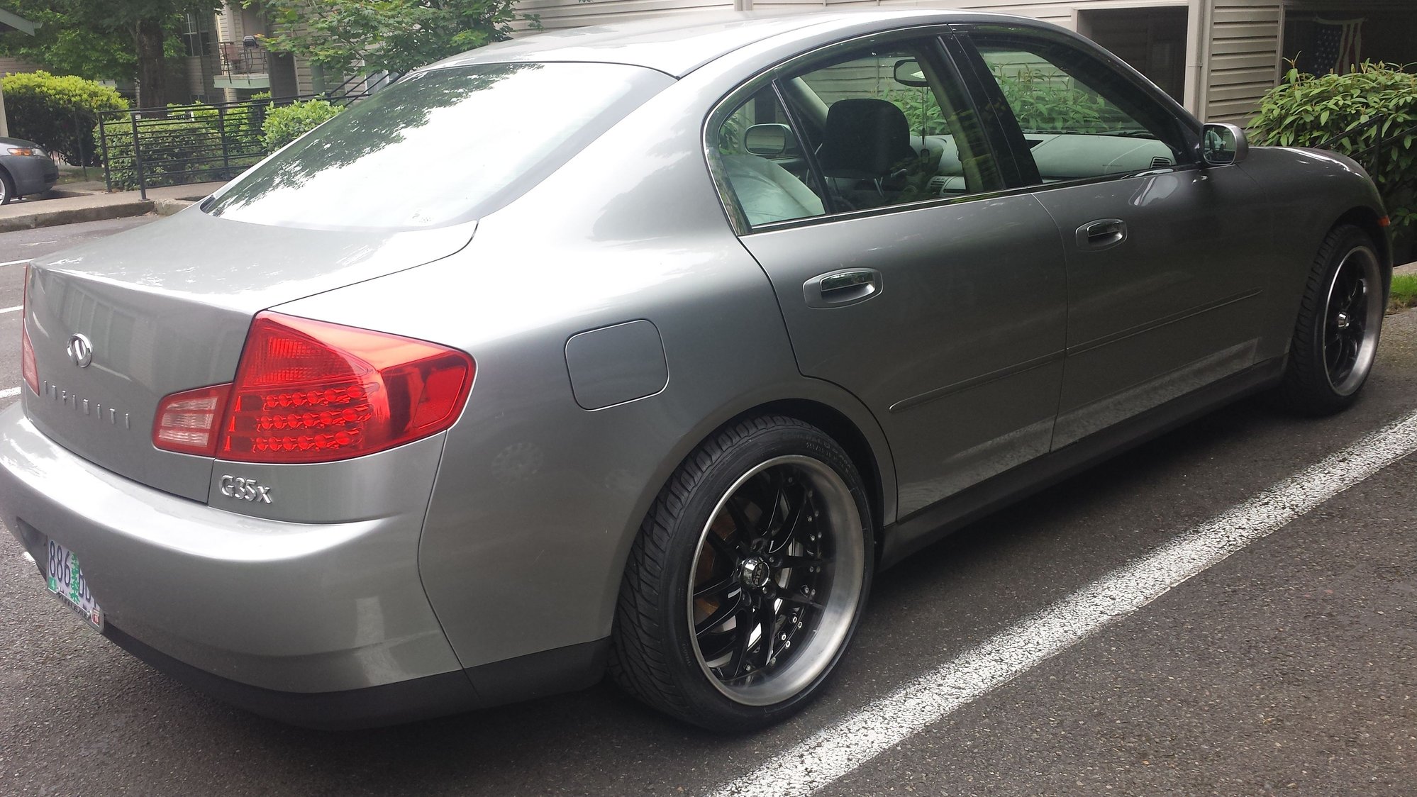

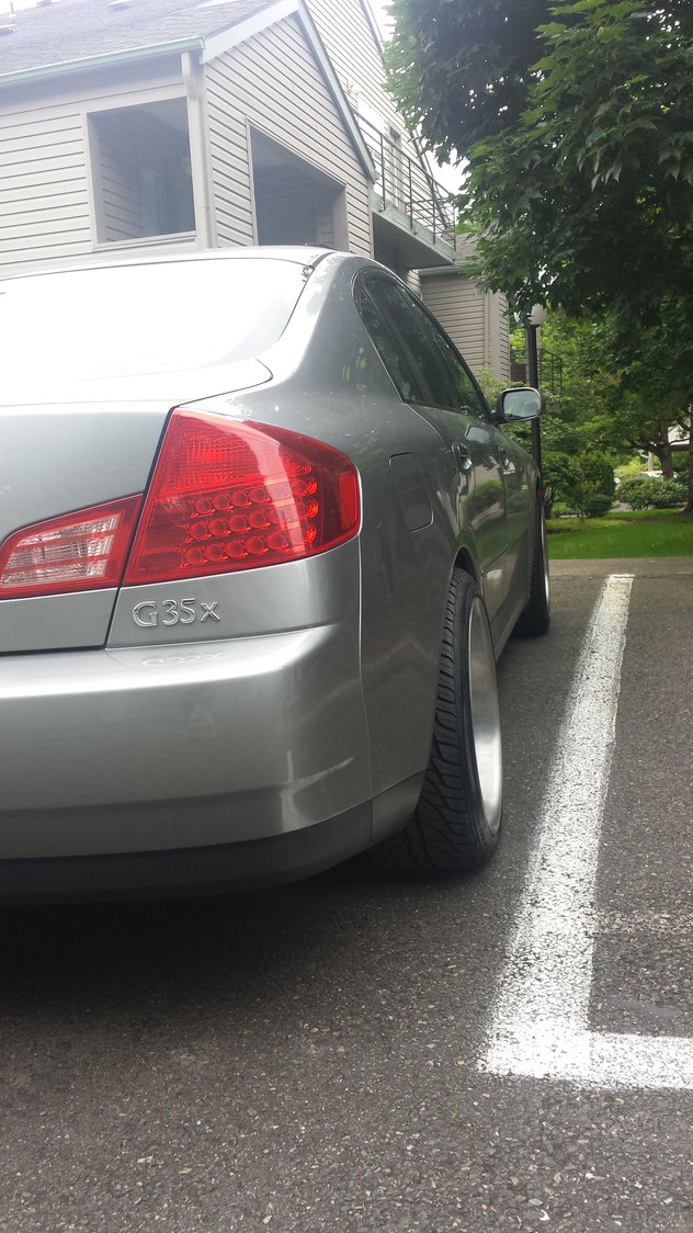

Even I've been paranoid.
