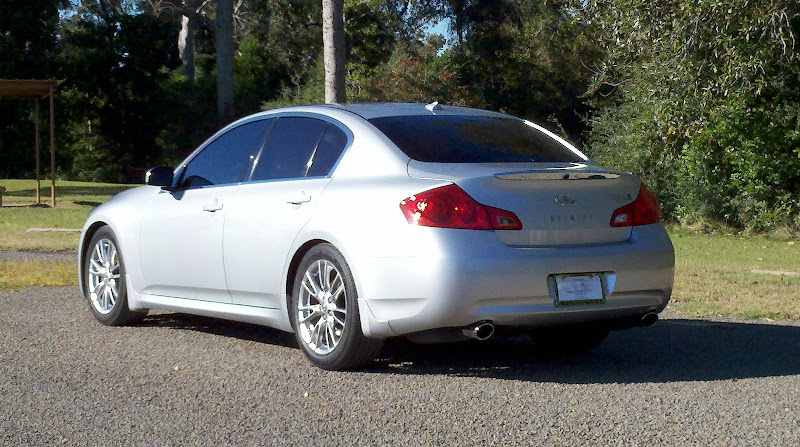

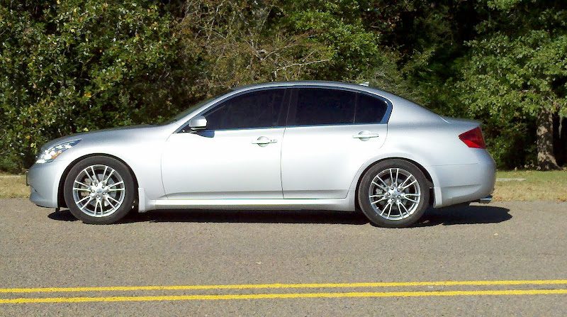

I ordered a set of the new springs for the X from Stillen last week and I installed them today. Next week I'm getting it aligned, so maybe the wheels won't be quite as tucked with the camber adjusted.
Stock height:
Lowered:
Stock:
Lowered:

that height looks great! can't wait to get mine on. maybe it'll be a light snow winter...

Great pics! How long after the installation were the pics taken? (Wondering if they'll go any lower as they settle over time...)

bigjohnintexas, did you put X springs on an RWD S or an S AWD? It looks like your rear badge says "S". Either way great pics, looks great
Old Nov 9, 2010 | 06:59 PM
  #69
bigjohnintexas's Avatar
Joined: Nov 2010
Posts: 19
Thanks for the compliments guys.
The springs were put on yesterday and the pictures were taken yesterday as well.
To clarify, my car is a 2008 G35XS (awd), and the springs are the Eibach Pro-Kit springs for the AWD cars.
I've put about 150 miles on the springs since yesterday (gotta love days off), and I love the ride. It has much less body roll and yet is very compliant. I can't wait to put a anti-sway bar on before our trip to the Ozarks next month.

Something looks off. Your stock height looks way lower than the stock height of my Xs, specifically the front. The wheel gap does not seem nearly as big as mine. Even in your dropped photos, your car looks lower than the others I have seen that have installed the "x" kit. It looks great though!
Old Nov 10, 2010 | 10:12 AM
  #73
Joined: Nov 2010
Posts: 19
I'm not sure....
Could it be that my car has 18" wheels? (most X's I see have factory 17's)
Here are the measurements I took from my garage floor to fender above centerline of wheel:
Front stock height: 28.5"
Lowered height: 27.125"
Rear stock height: 28.25"
Lowered height: 26.75"
The lowered measurements were taken this morning and I believe that the rear has settled a little bit since Monday.
