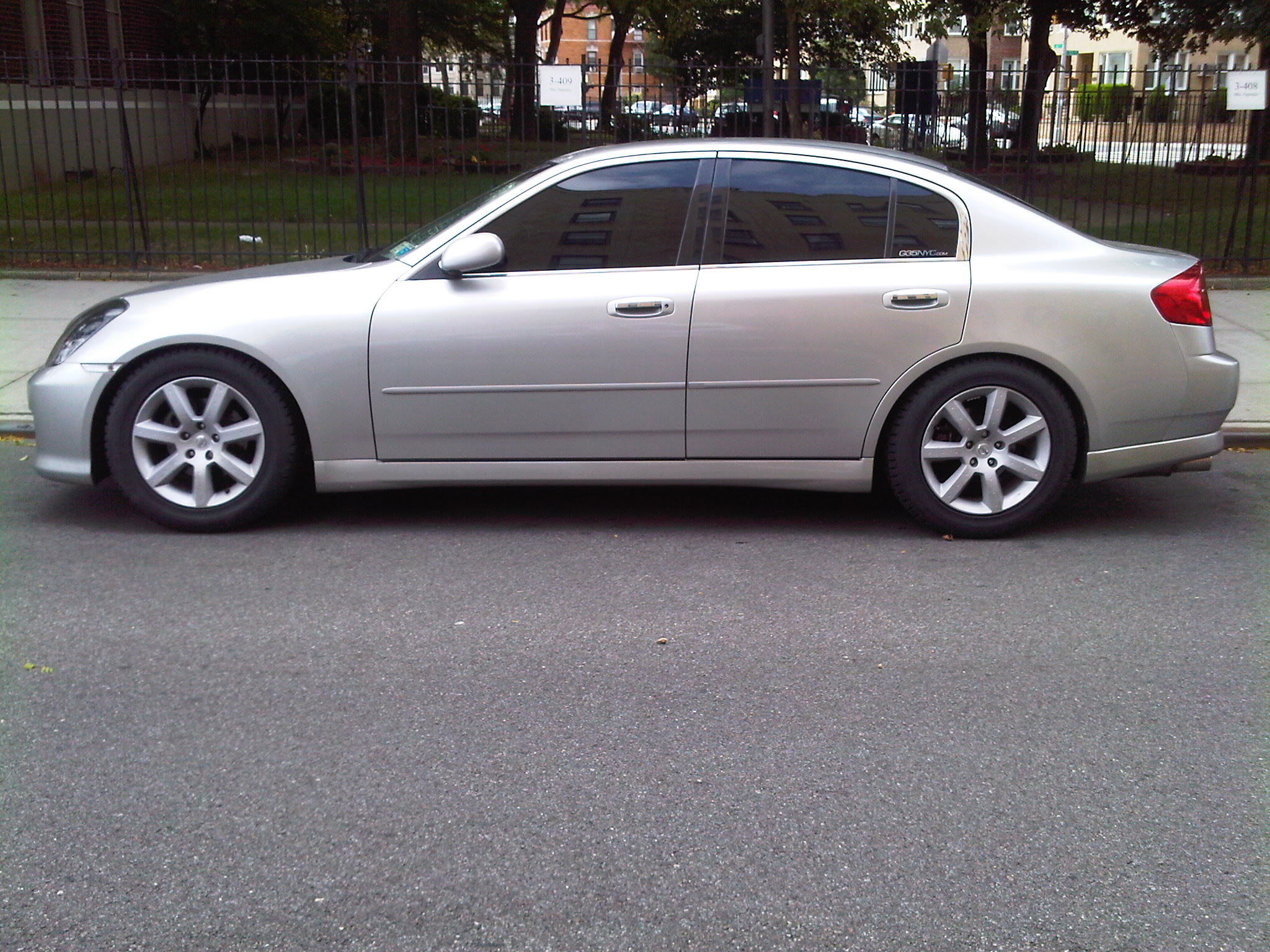

From: Pittsburgh
^whats the highest they will go in terms of wheel-fender gap?
Old Jul 4, 2011 | 06:24 PM
04G35NYC's Avatar
iTrader: (17)
Posts: 4,842
Likes: 78
From: Brooklyn,NY
This was the highest i could of raised in the rear in the pictures with 55 profile tires.
The fronts can be raised beyond stock "S" height, the rears will depend on which springs you get.
