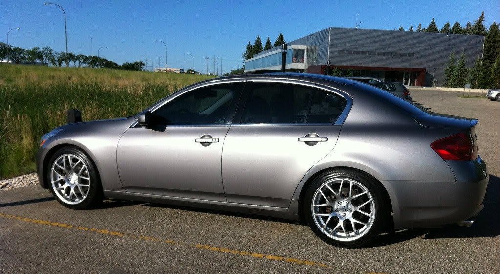

Just to complete the thread...here's my ride with the VMR 710s mounted. I wanted a sporty but still "OEM" look.
I'm pretty happy with the car now...looks and drives the way I want it to.

that is a very handsome sedan!!! i am on Eibachs also,, and have same stance,,, don't worry about the front being a little higher than rear,, fenders are cut that way,, 1/2 inch diff. what your really wan't is a LEVEL car where the jack points are..... well done!
