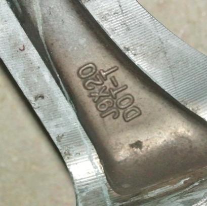

another pic

actually the offset might be 20 I'm assuming... based on this pic...

but the rim size is 20x9.. so idk if that is the correct offset of 20.. man I'm confused.. can't believe finding a offset for a rim is this difficult...

so if the offset is indeed 10 is there away to increase it?
i found this site and put in all the numbers and the site said it was fine

That may be the offset for the blank and it may have been machined down to its' current offset. A lot of wheels come with a aggressive intial offset so it can be cut down to various offsets depending on a particular vehicle fit. Like my 20" Nuteks are stamped ET20 but have been cut down to +40 & +45.
The other pic you posted is the wheel size, just labeled a bit different w/ the 9 & 20.
Hopefully yours have been cut down to a more sedan-friendly offset, you can do a test fit on your car and see how it looks.

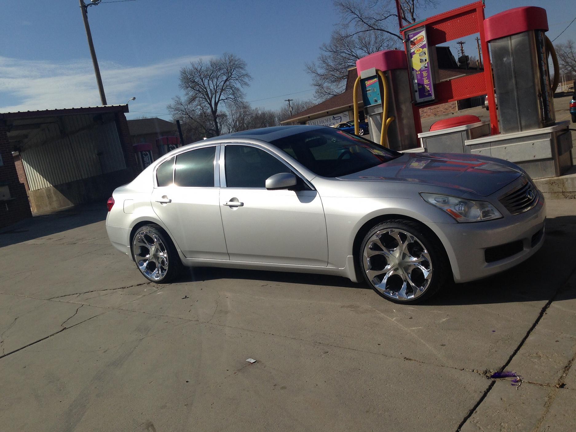

Got them on fellas they stick out a little but no rub rides nice
