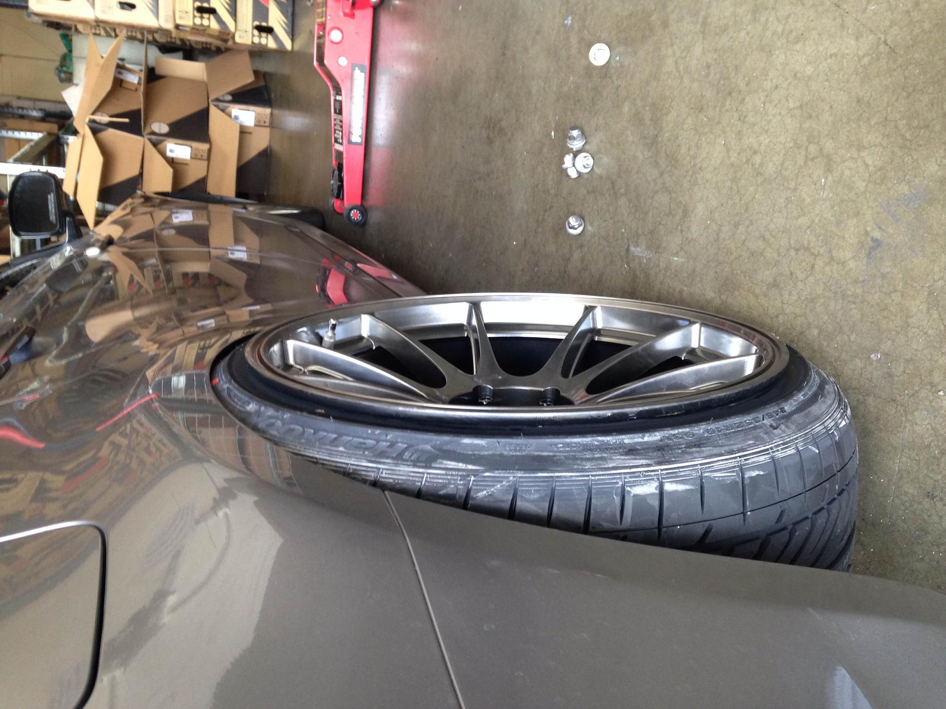

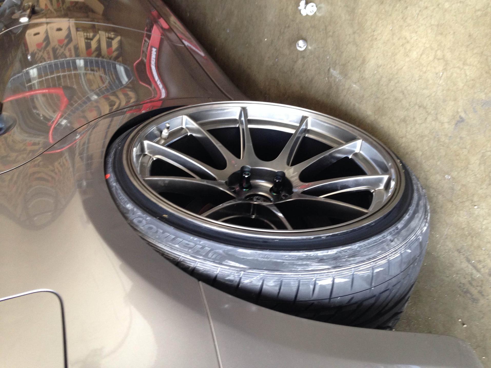

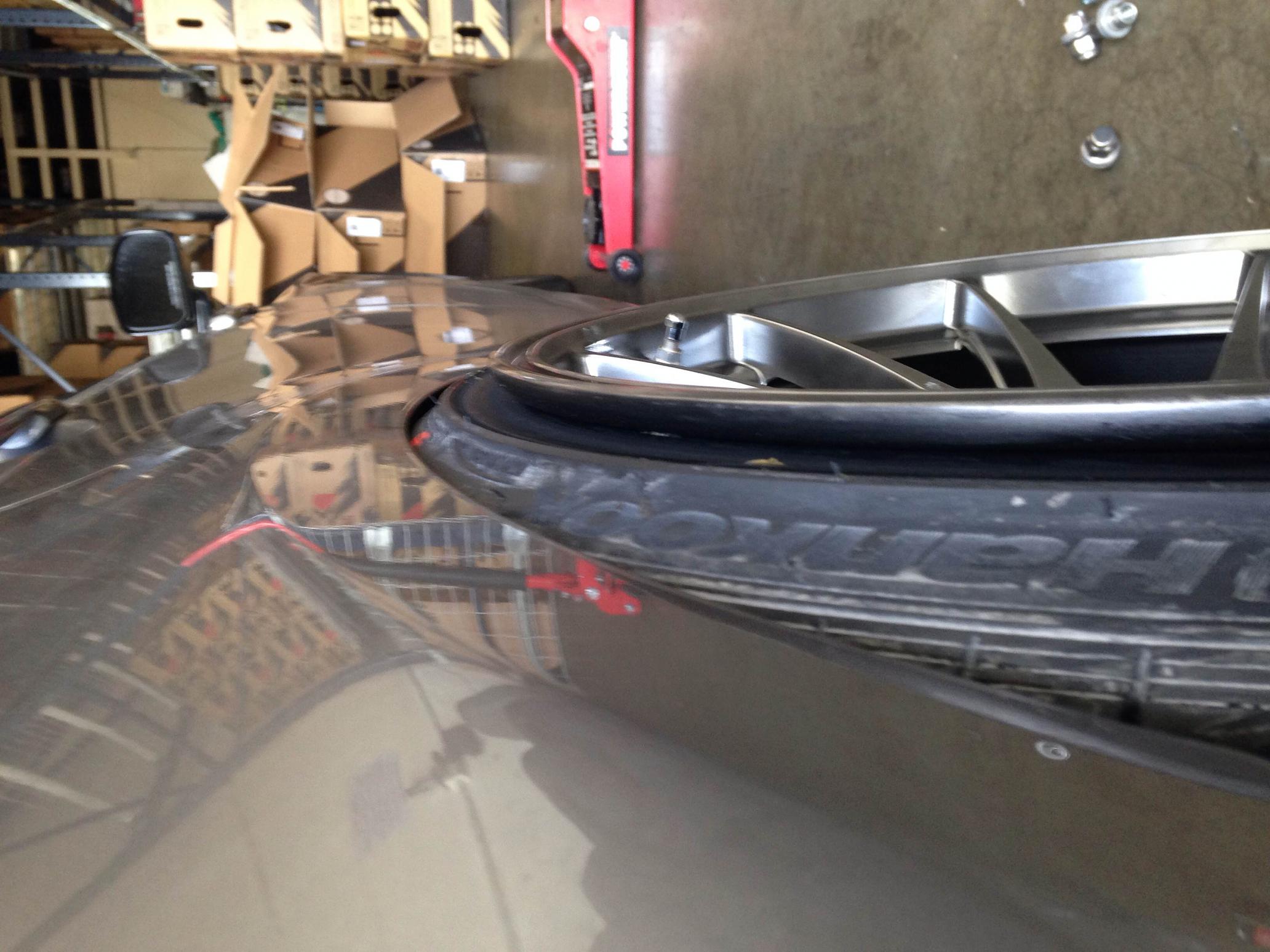

hey guys. i searched around the forum and read somewhere for the v35 that -1 degree of camber gives about 5.75 mm of clearance. I assume that the v36 sedan is similar but i was wondering if anyone has measured this specifically for the V36.
Ive attached a couple of photos showing my problem.
do you guys think an extra degree of camber will remedy my problem? clears the tire perfectly but will not clear the rim lip.

-1 more degree will most likely not let the lip of the rim clear the quarter. You will either have to add a few more degrees or a pull and a couple degrees.
