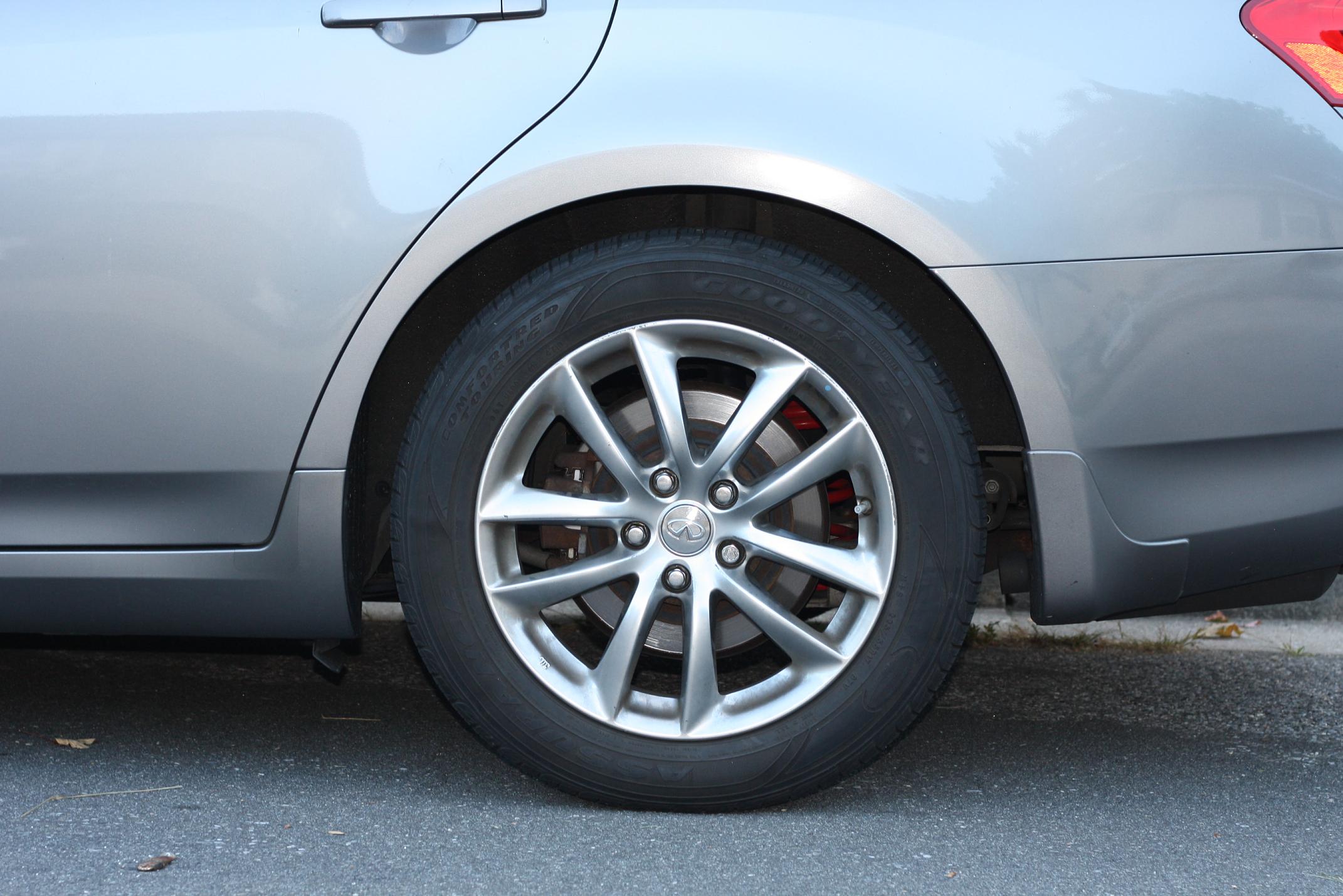

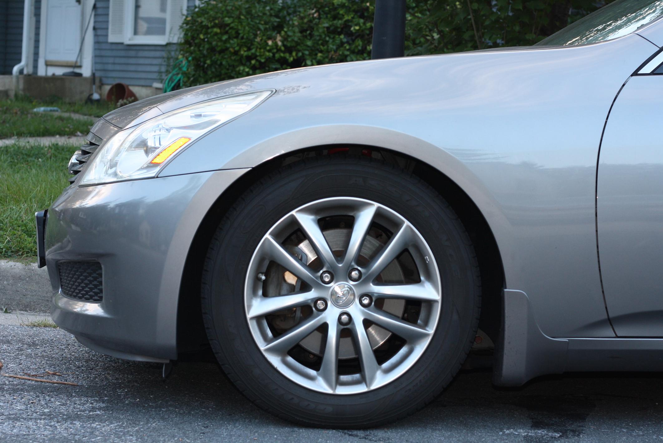

Here is the pictures.
As you can see, the front is looking lower than the rear. I don't know if I messed something up during the install.

It doesn't looked like the rear dropped much if any. I don't think swift drops as much in the rear as some of the others but i would think it would be more than that. I'd check that you installed the springs correctly. I haven't used swift but with eibachs the springs have to go a certain way and use oem rubber cones / pads.

I used to be able to fist the rear wheel gap, now I can 2 finger it, so there is a good 1" + drop in the rear. REmember this is an AWD so they are super tall as it is. When i installed them i reused the rubber seat on the bottom, and I clocked them by marking the Spring bucket and the top chassis to where the coils starts. They sit close, not exact to their original. BTW it is even from driver/passenger side.

According to swift specs they're supposed to have a 1" drop in the rear and 1.5" in front. So if it did reduce the gap as you said then maybe that's how the rear is supposed to sit. Do you think the front dropped 1.5" or was it a lot more? If more maybe they're the wrong springs, non AWD. Due to different spring load rates.

I am actually thinking of trying swift springs on my x,, however, I have been on Eibach for 6 years now, and love the look, ( but want the non progressive rates of swift) but yes, that front is too low, imo, I do not like the "raked" look, plus, the fenders are cut diff. so the front is gonna look higher anyways, as it should, (we should be measuring from just aft of front wheels, and just in front of rear wheels, (basically the jack points) before and after install, same level place. as far as vibs,,, I would think its wheels/tires. maybe a rebalance with a roadforce system....

I did measure from the rails to the ground, and it is .5" difference.

Drop looks typical for a Swift spring setup on an AWD IMO.
Looks pretty good too.
