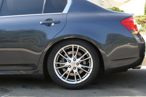

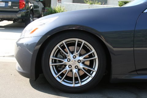

ALL DISCLAIMERS APPLY HERE TOO, whatever you do on your own, you do so at YOU'RE OWN RISK. These are the Eibach springs used in the RWD installation. No problems with lining anything up, like they were made for the AwD as well.
I would like to thank Timmay77 for writing such a comprehensive DIY with photos.

Before the install, I was able to get my entire fist into the fenders, front and back, now:
Back:
Front:
The rears look a little off camber, :
I will take it to an alignment shop in the following week and report my findings.
