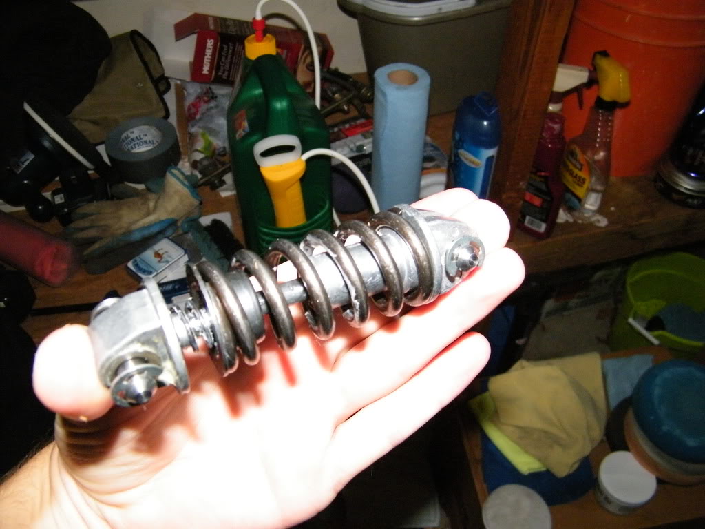

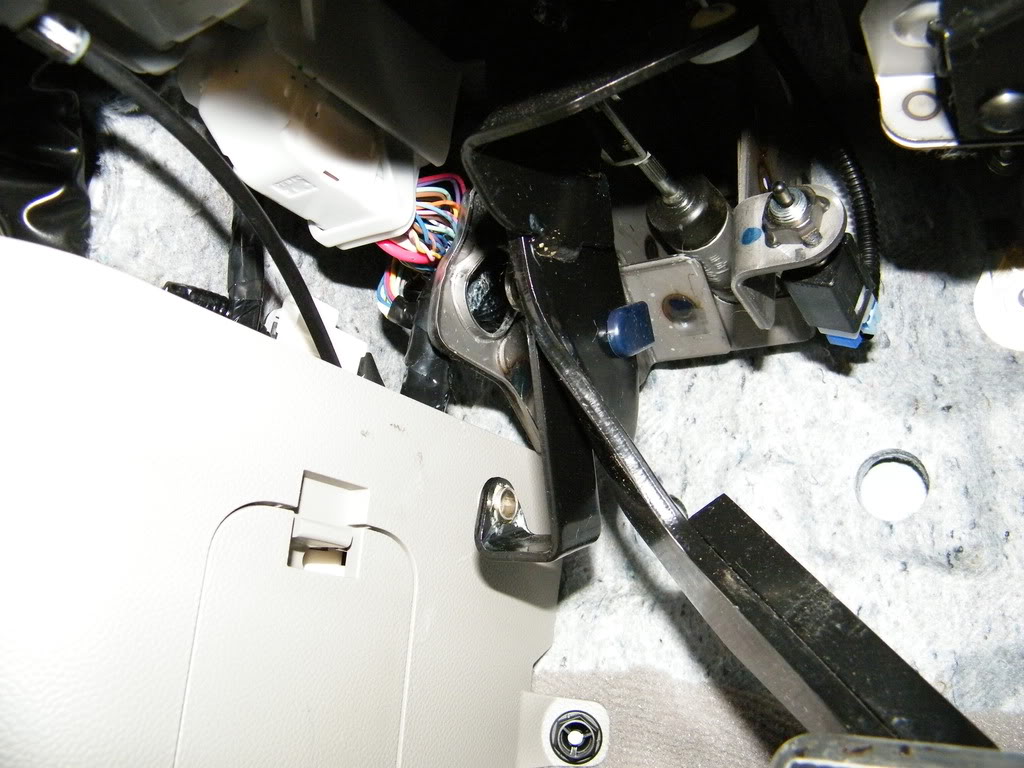

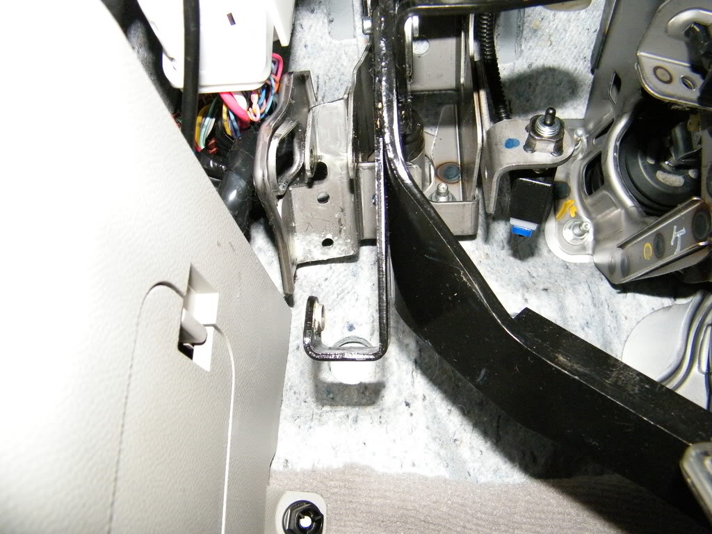

Originally Posted by session_road86
Can you post pics on how the DIY should look like after the piece that you pulled out?
Not sure why you would need this but I just took some
