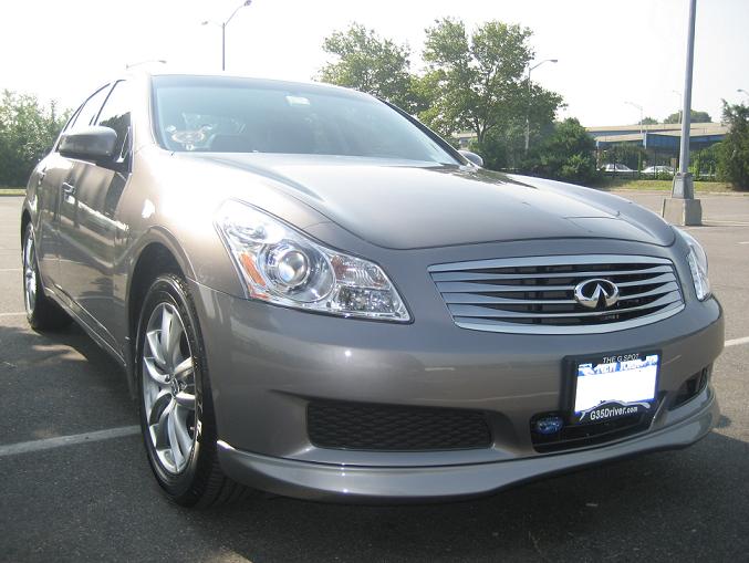

Thx! Can't wait to see that. I will have mine install with all stock. Just took off Stillen Short Intake.I dunno i feel like more power w/stock one.
I will post mine when it's done one thing at a time.
