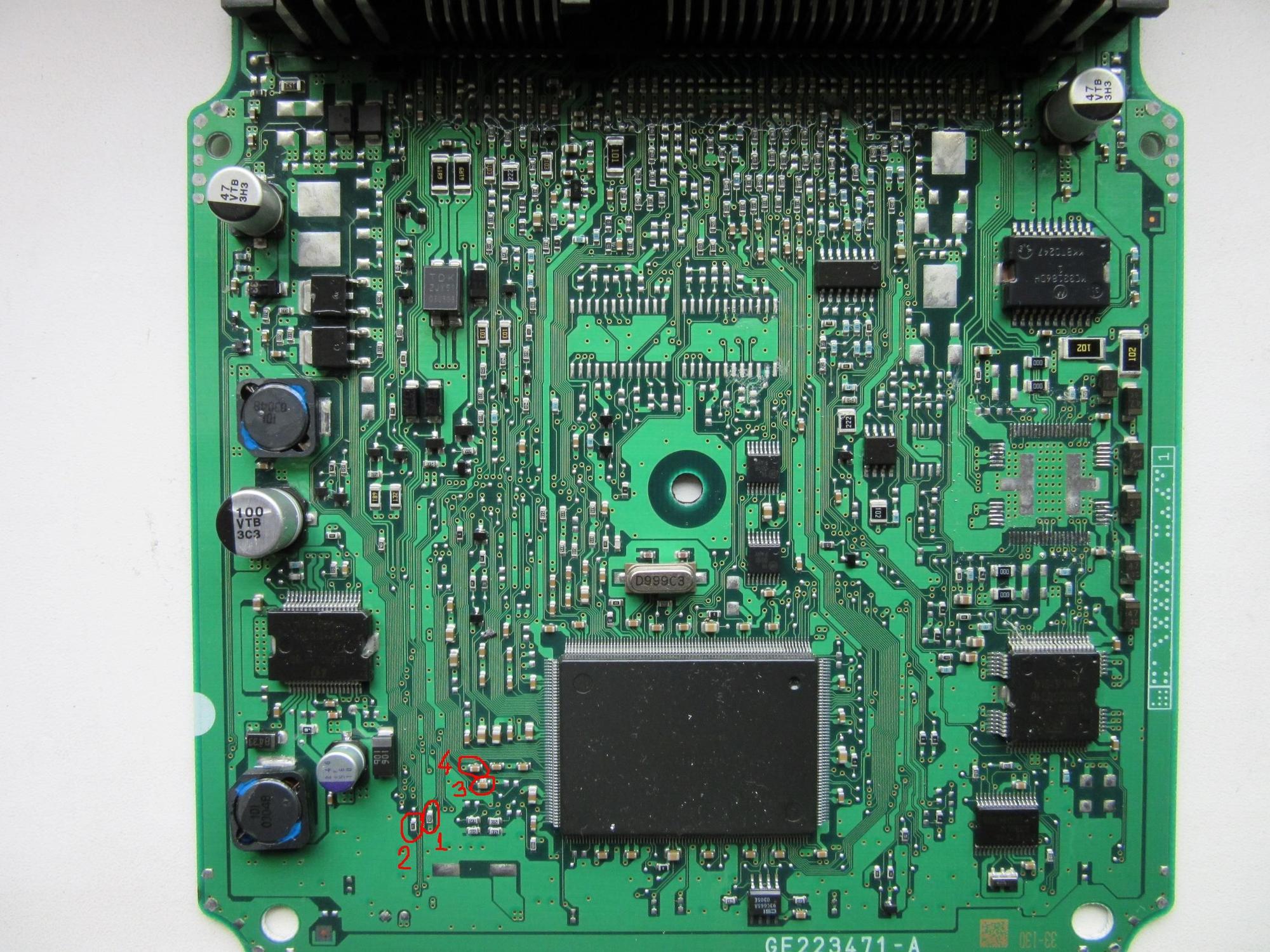

Help please identify the elements!
Hello!
Sorry that animate the subject.
But do not tell anyone component values. I had to pay, but already there places without indicated in the figure. As long as found by the photo from the Internet that:
1. R = 10 kOhm (mark 103)
2. R = ??? (mark ???)
3. C = ???
4. C = ???
Maybe someone has a fragment of the scheme or access to the unit.
In advance thank you very much, I hope you can help !!!
Originally Posted by NFSP G35
So, a little more info from this thread: https://g35driver.com/forums/tuner-d...technical.html
I have a newer ECU in hopes that I'll be able to go from the older "Maxima style" grey connector ecu to the newer black connector ecu.
I took apart the ECU to get ANY information that might possibly help out:
The info off the ECU is as follows:
It's from a 04 G35Sedan with AT
Outside label on the ECU reads:
Nissan
Hitachi, Ltc. Tokyo Japan
WA
MEC31-980 B1 3141
There's a QR code printed on the label that contains this information:
WAMEC31-980B10000WA341423710 AC0100155 (thank's QRDriod )
If you notice, the bold part is the "ECU number" that you can lookup on infiniti-techinfo.com except this particular one isn't in there for some reason
Inside the ECU, printed on the circuit board is:
31-980 in gold letters,
ge223471-a in white letters.
The chips, from left to right, top to bottom are labeled:
Motorola
mc38186dh
kkcz0246
l9302 - ad
b995c0312
l9302 - ad
b995c0312
789101a
a03(a1)
0310k323
The big one in the middle:
64f7055f40
rl 0306
bb02800
Then the last one:
l9762 - bc
b99140303
Hope this does some good
